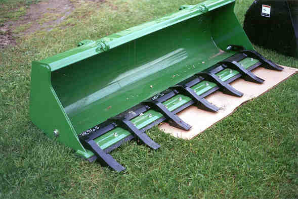

I believe the 430 FEL is the standard for the JD 4310 mid-size chassis. To go higher, you would want the 460 FEL. These though are made for large size chassis like the 4510 through 4710. With all the work you have planned out for that FEL, no, you would want to upgrade to the heavy-duty bucket.
Attached is a pic of a toothbar on my HD bucket attached to my 460 FEL. I would certainly recommend one of these toothbars with the FEL work you have planned.
...Bob

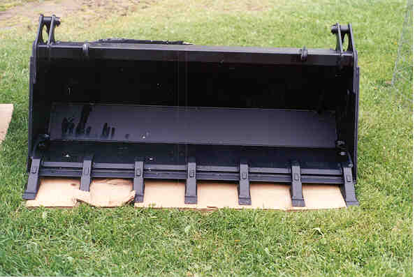

   / Upgrading-Front Loader question #5
...and here's another pic of another toothbar that's on my 4in1 bucket.
...Bob
   / Upgrading-Front Loader question #7
In simple terms, 4in1 is analogous to four functions that this type of bucket performs. Functions are: 1) FEL bucket (when in fully closed position....just use it as one would use any other bucket), 2) grapple (clamshell opens in middle...one can pick up rocks, material piles, logs, etc), 3) dozer (clamshell opened and bottom back edge is used as dozer blade when in forward movement), and 4) boxblade (clamshell opened and back edge of opened clamshell is used when back dragging).
...Bob
