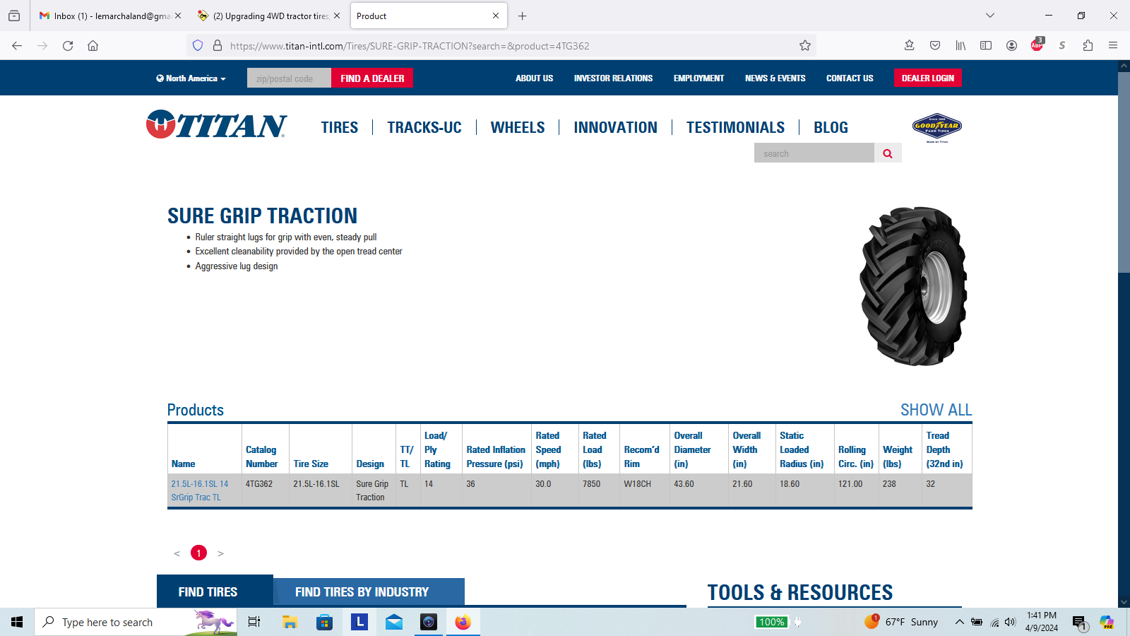

Or add duals to the front and if needed to the rear, or maybe some of the new LSW tires.
Or just go wider in front, it may take a custom rim but;
