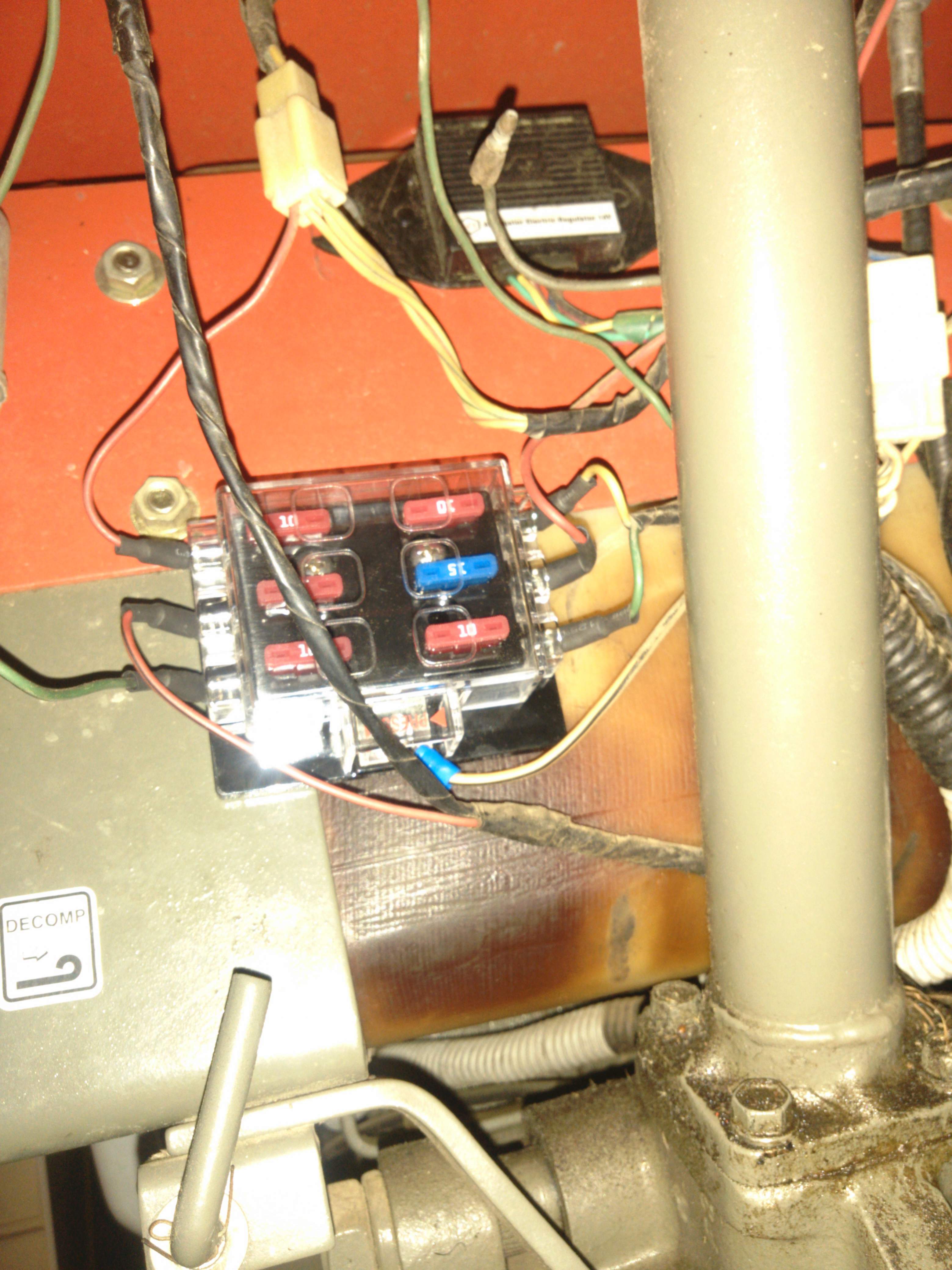

I have been looking at the upgrade frome Hoye for years. My fuses were wound solder and have cracked from vibration I guess? And sometimes make contact and others not. I ordered some fuses a few years back to put in place but they were longer???and bunched up in the gap.
Being cheap I saw where someone posted a link to the same panel on ebay. I think it cost me $5-6 shipped from china. I went to the store and got two 1 inch machine screws m8-32 and one inch long and two nylon lock nuts. Then I started sniping wires and putting new blade ends on them. I also put shrink tube over them. I had the connectors from a kit I had purchased before. And bought two packs of fuses from walmart to complete it.

My old panel the screw were so tight or seized that the soft brass screw were just deforming. I could not even clean and redo connections if i wanted too!!!

ok i emailed my self the picture from my phone so that i could add it from the computer. here is the finished product. Its the exact same panel that Hoye sells. The holes are the same and they lined up with the existing holes in the tractor perfectly.

Nice job. :thumbsup:

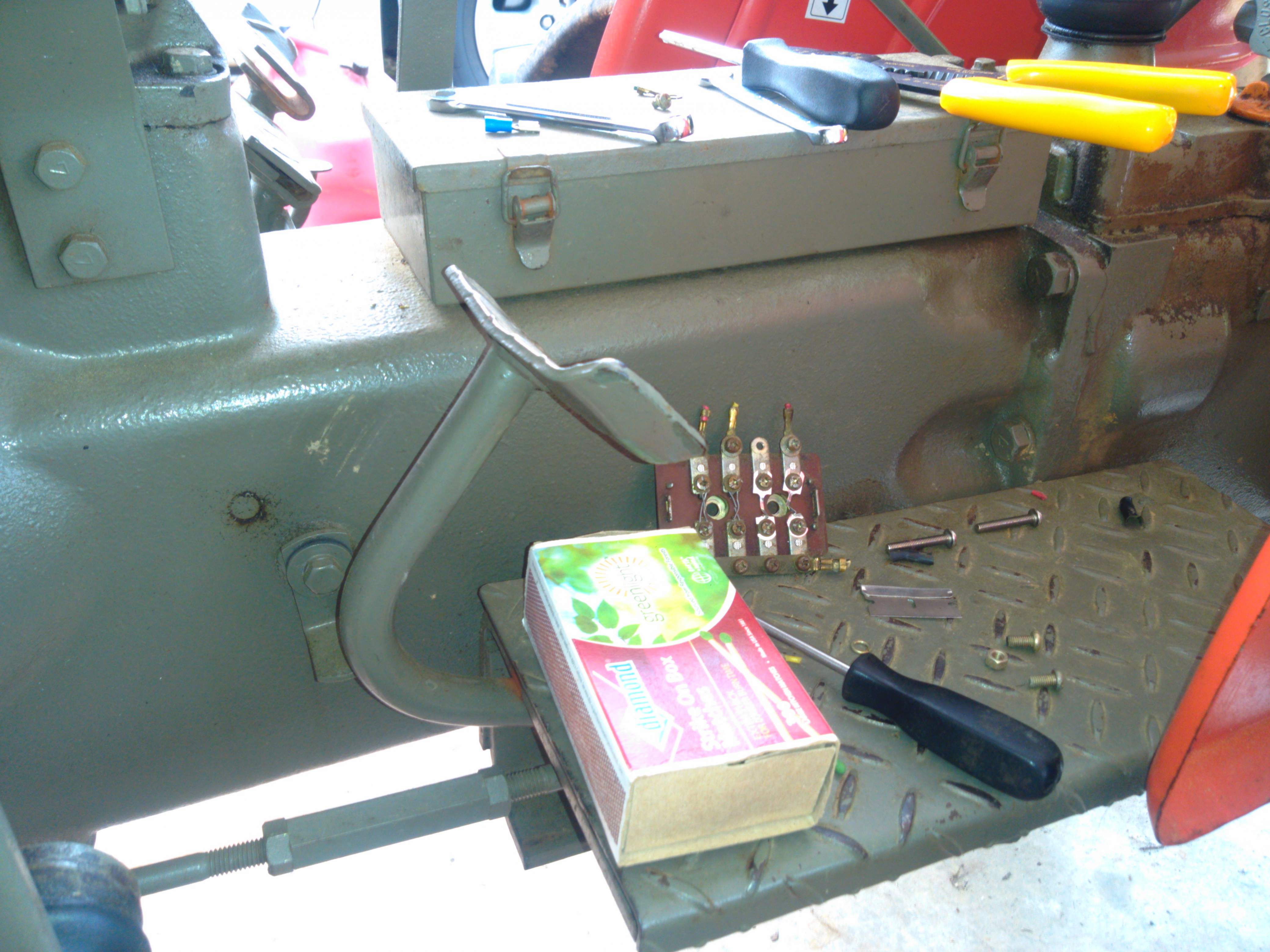

here is the old panel. The connectors that are cut off could not be loosened.
The wires i think is solder and the other fuses are what i got from HOye and they dont seen to fit well.
