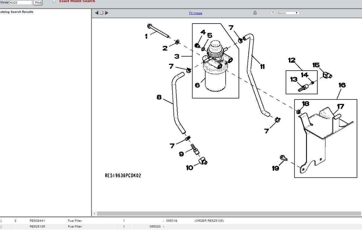

Wondering if anyone has upgraded the fuel filter on a 42 43 or 4400 tractor. I seen the 4320 has a different filter setup, the filter housing and filter kit are around 47 bucks plus whatever the bracket cost.

Just looked more, looks like the factory 4400 filter is a 19 micron and the 4320 is a 5 micron, these are going off napa cross reference numbers.

If anyone could post a picture of a 4320 setup so I can see how the filter mounts and if it even would fit I'd appreciate it. On a side note Donaldson does makes a 5 micron inline filter would be easier to install that.
   / Upgrade fuel filter 4400? #5
Not sure about the "fit" on the 4400, but the RE525105 (item #3) kit is shown in jdparts.com
Yes I've seen that just curious as to fit and placement.
