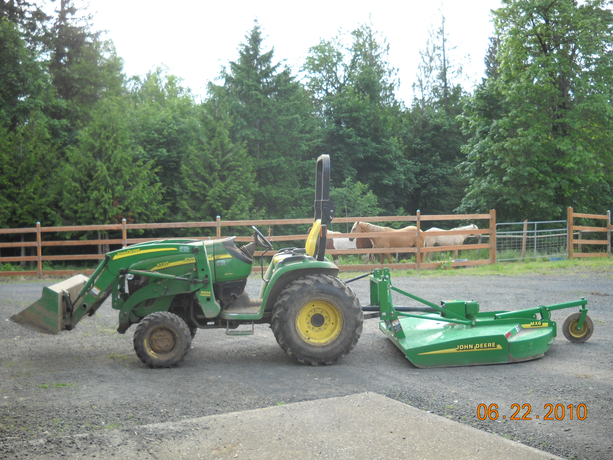

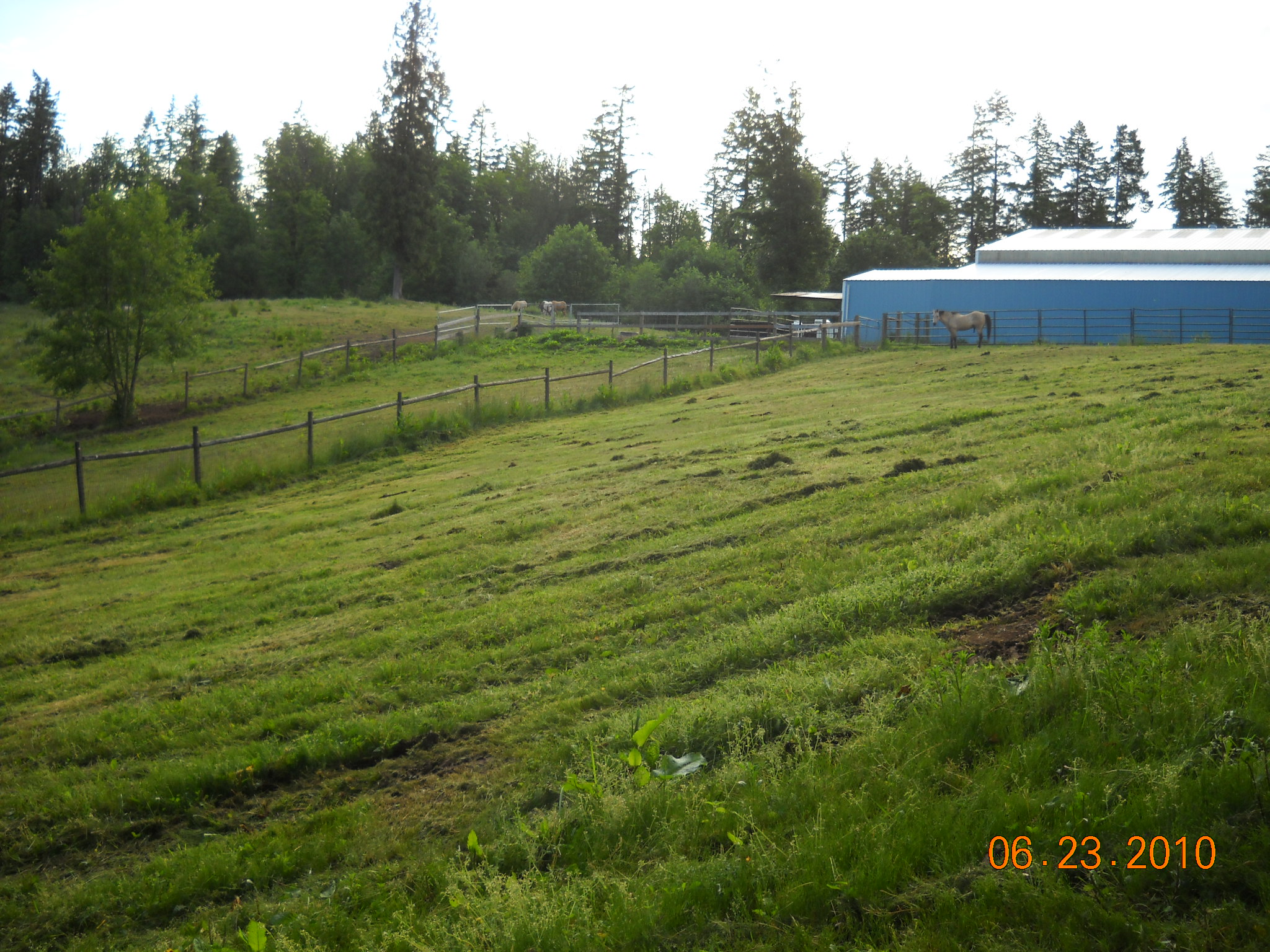

Im not sure on the 2x20 series but i am able to mow some pretty steep hills on my Dad's 3720 in B range. The 3120 or 3320 might be the way to go because the B range offers some speed and torque. I use B range quite often and it doesnt seem to slow for me (IMO) Also, the 3x20 seriers will have more hydraulic power over the 2720 and be able to power a larger backhoe.
