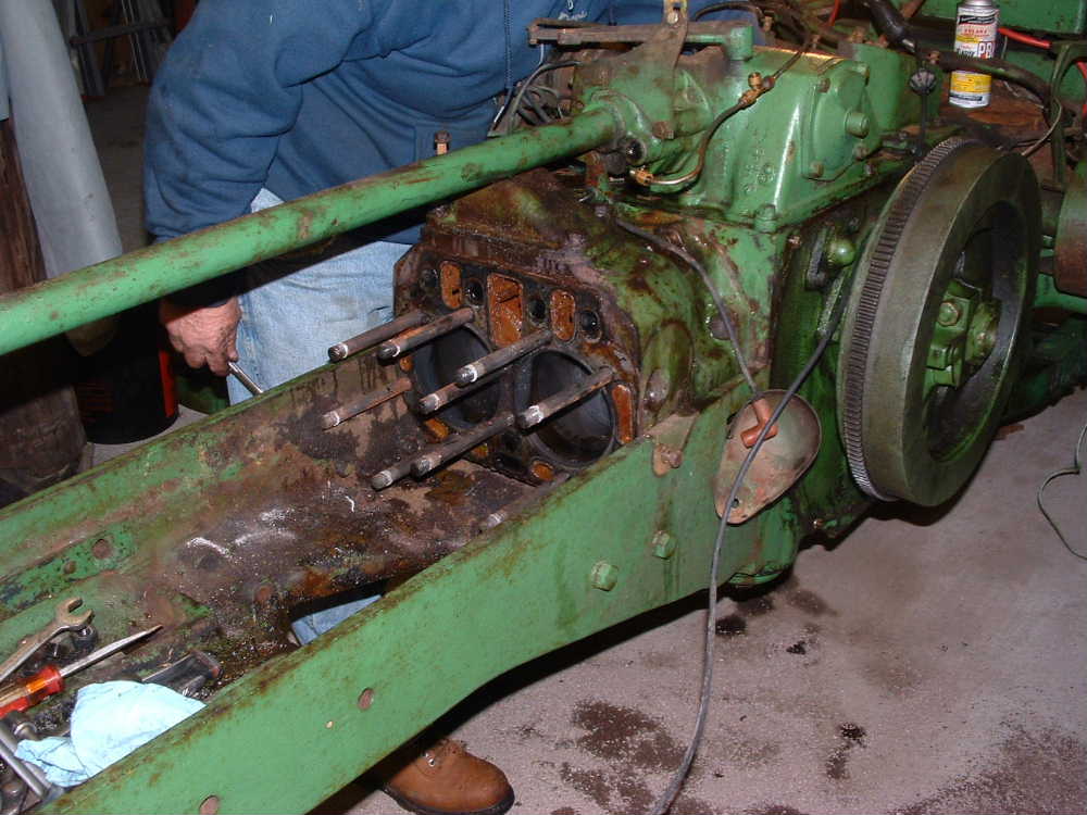

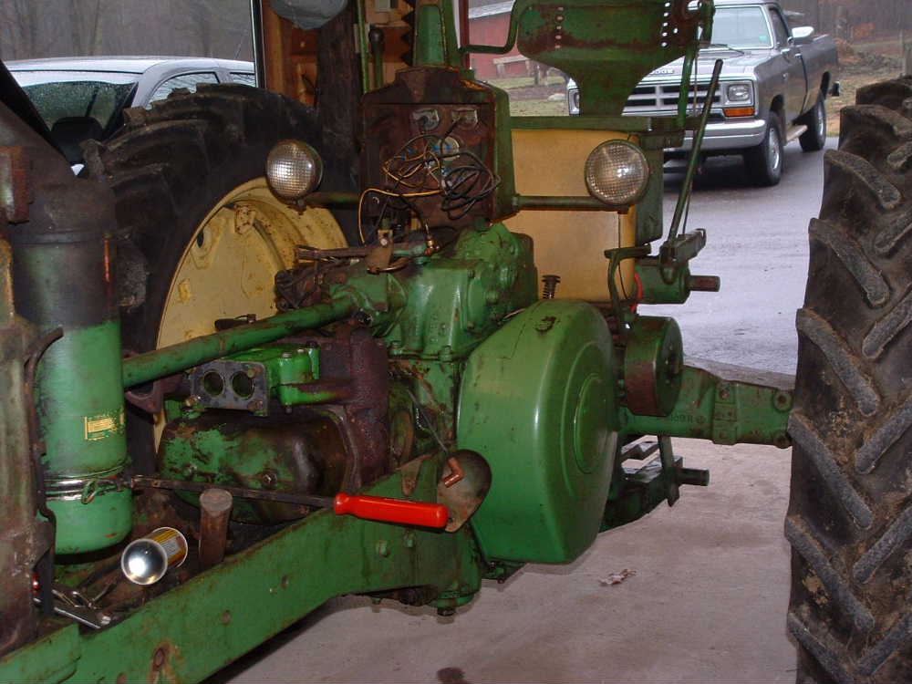

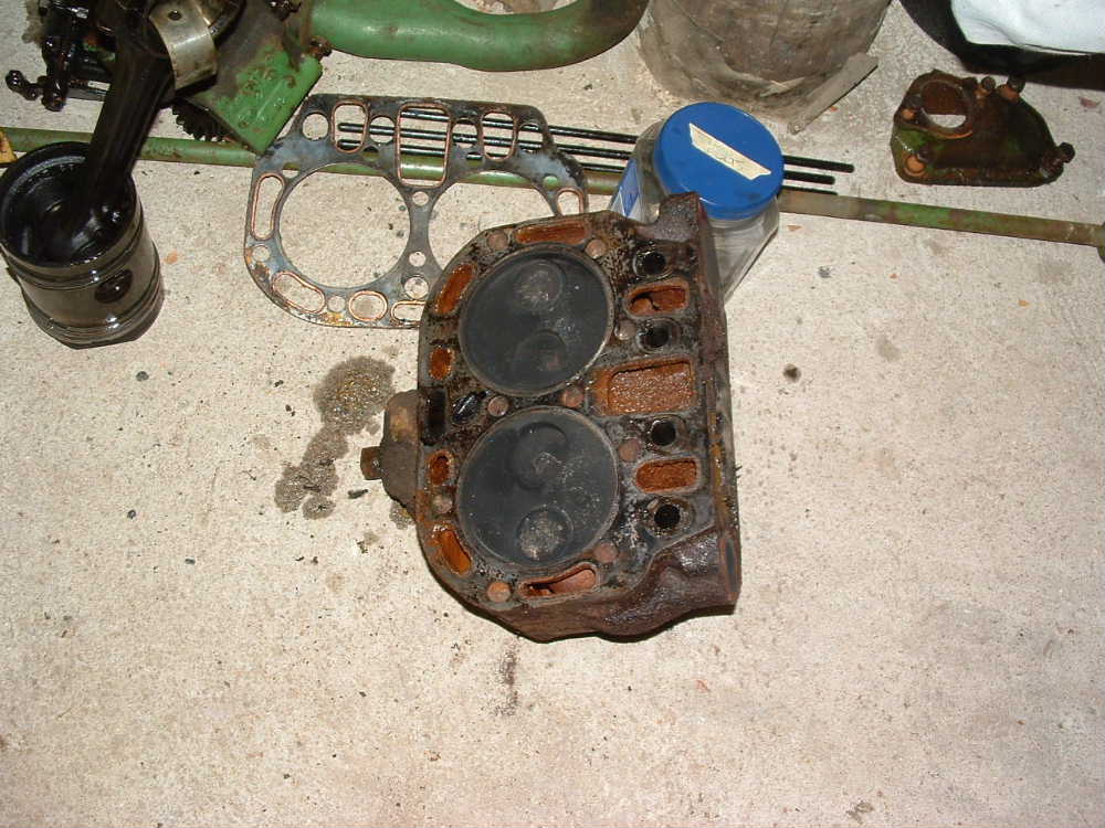

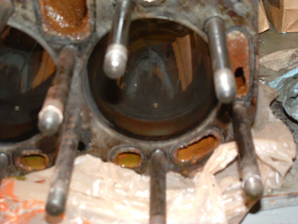

this weekend finished getting the gas tank off, and drained all fluids,on sat. then yesterday finished getting the console, valve train/manifold then the head and pistons off. left side piston was seeing some blow by and the connecting rod bearings were wearing pretty bad around the crankshaft, and i think the play in that had caused the piston to wear a ring around the cylinder wall.also found some carbon deposits on the valves and piston tops. i was expecting worse since i doubt this machine has ever been rebuilt. we've owned it since i was about 8 yrs old, now 31 doing the rebuild on it. they don't make them like this anymore, when i pulled the head i was amazed at the weight of it, and all cast iron. heres a few pics of the process, not sure if you can see it well but in the pic of the head you can see the ring in the cylinder.

My eyes can't see what's bad w/ the cylinder......

that pic isn't the best but the piston was getting sloppy and wore a groove into the cylinder wall nothing a little machining wont fix.

another update on the 50 my dad had some time and he took the valves out, one was burned. which would account why we couldn't get the 50 to run smooth since last spring. next step is off to the machine shop for an overbore of 45 thousands and a valve job.

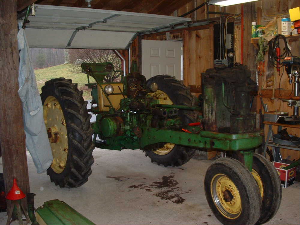

update on the 50 restore. ordered the pistons and bringing the valve train and cylinders to the machine shop. also have everything cleaned up and started blasting the rims and other metal parts, along w/ degreasing and getting it all prepped for paint. i'll get some more pics as we start to get her back together. right now it looks very boring on blocks and tore down.
