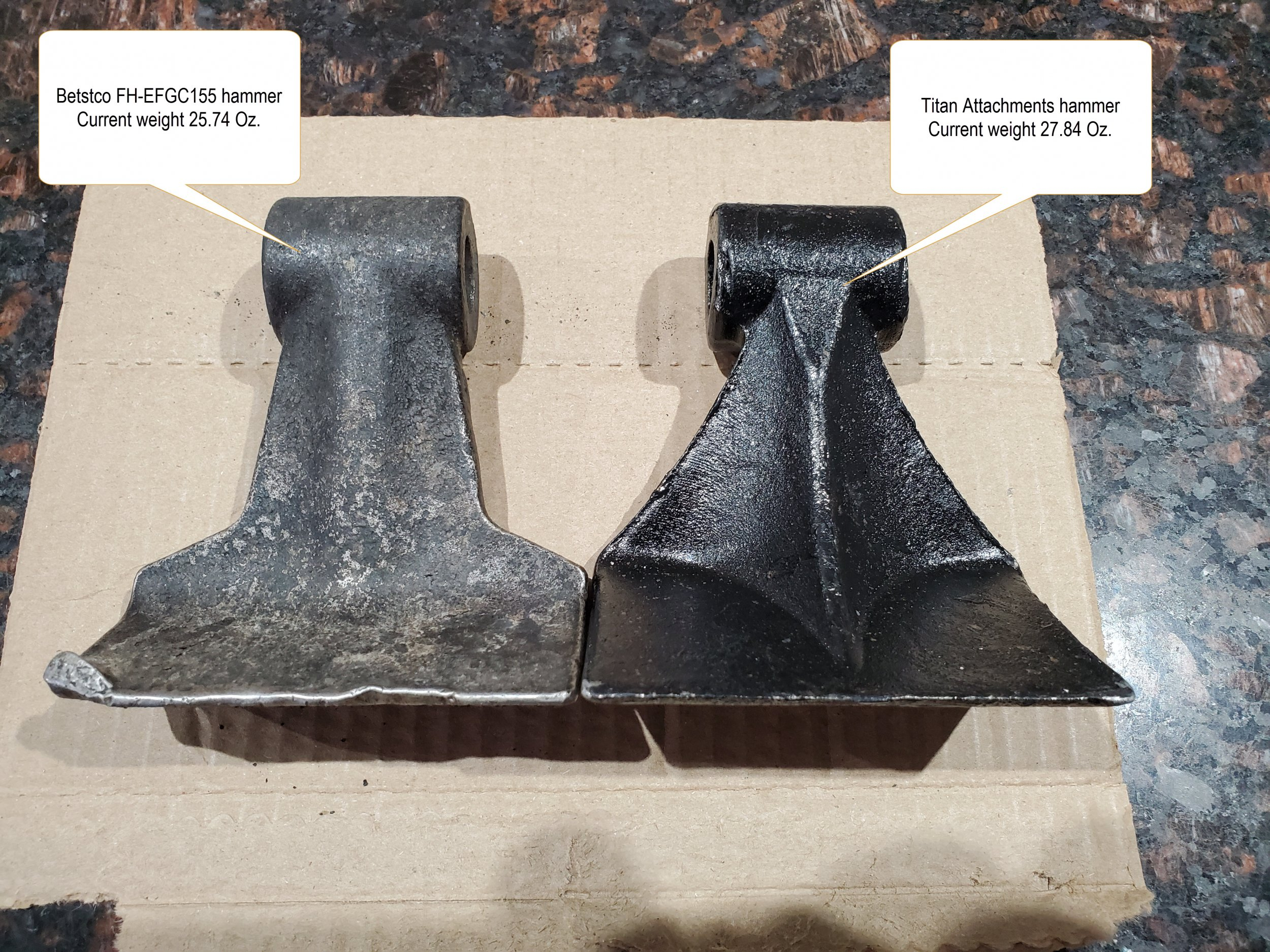

Trying to get new hammers for this crap flail mower.
After its first run in a nice clear field I have three broken hammers.
Field has NO rocks since I mowed it last with my JD flail and hit nothing.
Only thing I hit was some 2-3 inch sticks laying on the ground.
Anyway, tried contacting Betstco and no response for days now. They don't list hammers on their site that I can find.
Phone, email and chat go unanswered. There site also says 2-3 week lag in shipping but hopefully that is not for parts.
Any other sources for good hammers?

Yes, but knowing what will be an exact replacement, weight being the most important, so far is a bit of a guessing game.
I ordered some from Titan which seem to be very close in size but I'll still have to weigh them to be sure.
If you look at Betstco's site as if ordering this flail you can order a "6 pack" of blades but they are quite expensive.
I'm thinking Betstco may not be a good choice anyway for blades.
I just figured someone else may have found a good replacement or maybe even a better blade!
I'll report how these Titan blade shape up once they get here.

   / UPDATE: Replacement Hammers for Betstco FH-EFGC155? Where To Get?
Update:
So I have this blade now from Titam Attachments.
Titan Blade eBay
Here is a side by side of the original and the Titan. I think they are really close. The Titan is approximately 2.1 ounces heavier than my sample blade. Don't know if 2 ounces will throw it out of balance much! I have one broken hammer currently.
I like the look of the blade.
Costs - Betstco $14 each plus whatever they charge for shipping.
Titan $54.99 for 5 ($11 each) and free ship.
Opinions welcome! Will try later today or tomorrow.
   / UPDATE: Replacement Hammers for Betstco FH-EFGC155? Where To Get? #8
Those Titan blades ok really nice!
I would replace the blade opposite the broken one. Worst case you have a spare for one of your originals. Bearings are never better off with vibration on them. Why run the risk?
