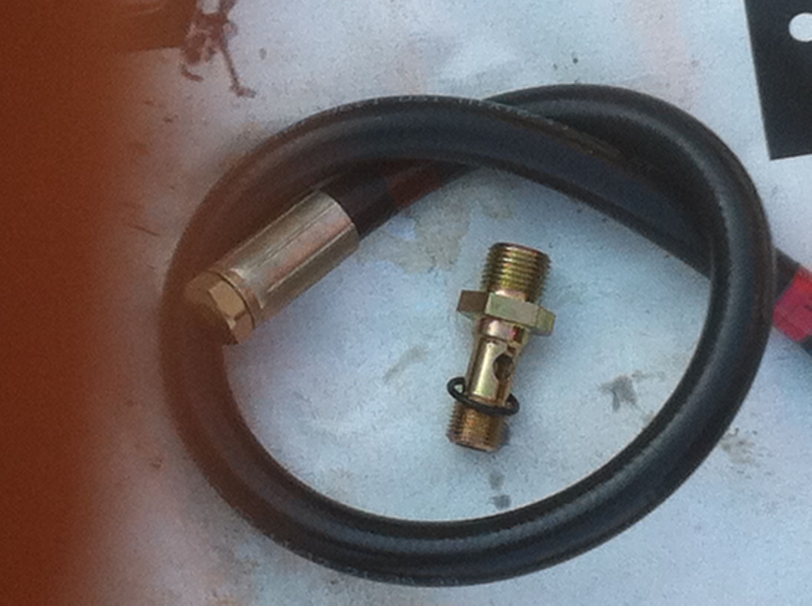

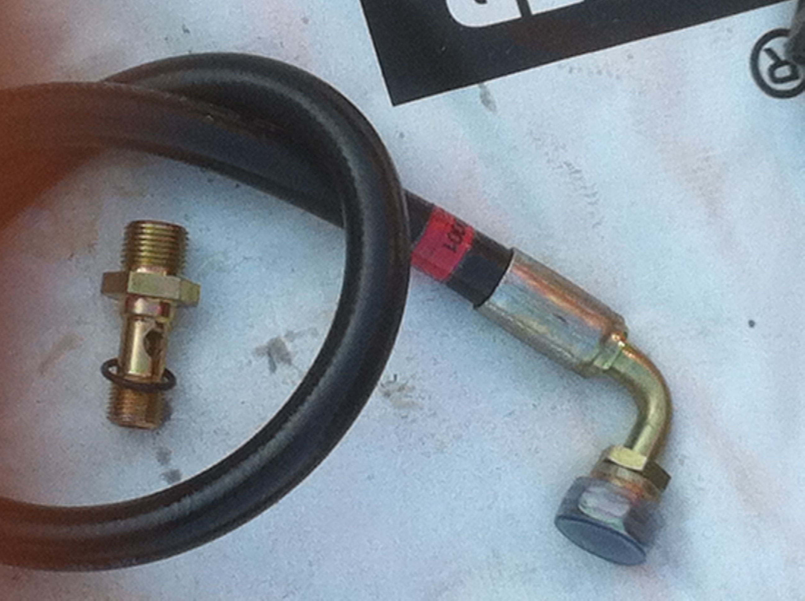

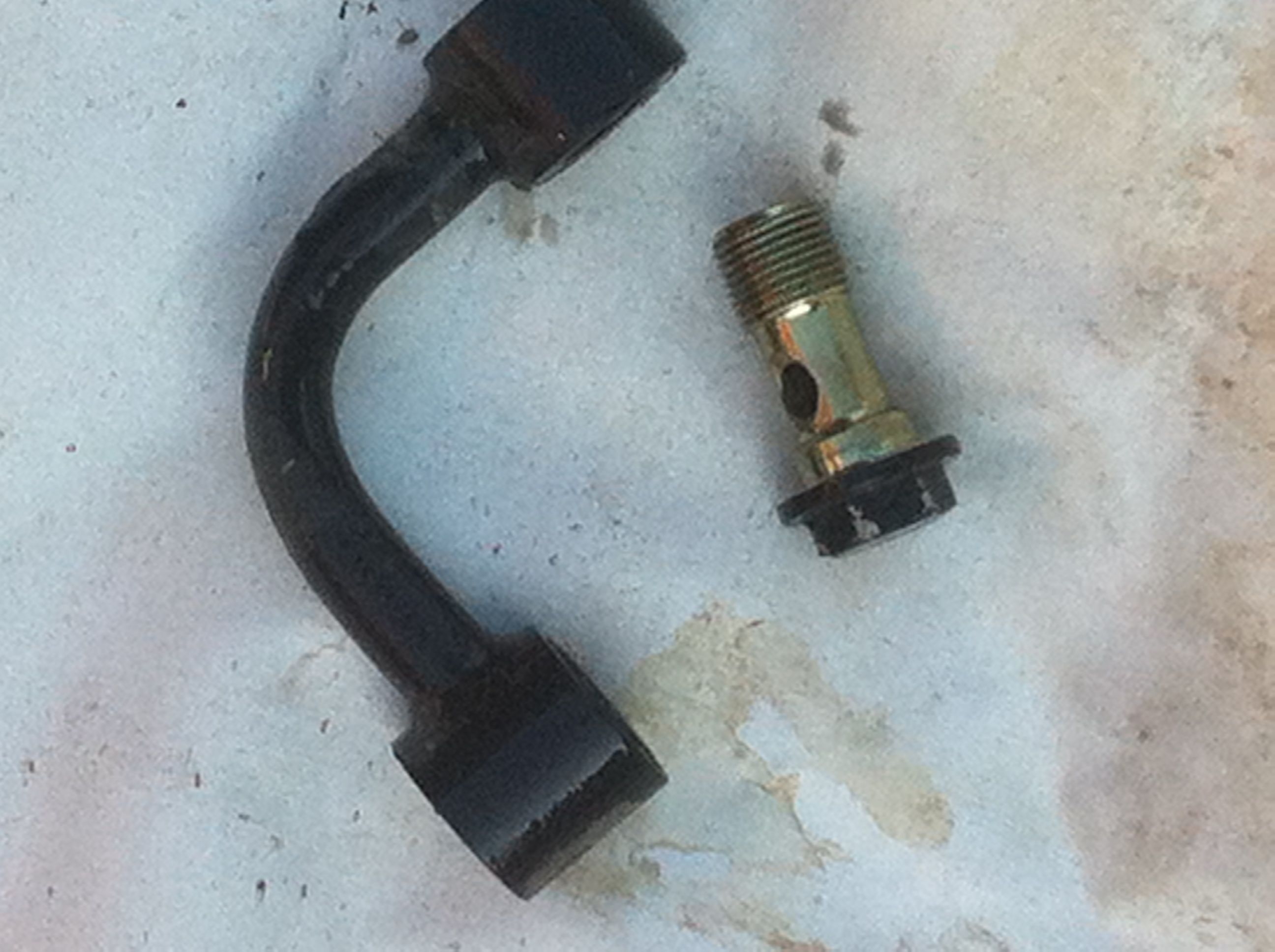

Any chance you could post some pictures of what the new parts look like?
   / UPDATE: KIOTI weighs in~ DK-40 Squeal when in reverse...
Above are the pics of the parts involved in solving the squeal issue. The first pic shows what the tractor is equipped with from the factory. The second and third pics depict the replacement parts; a newly designed hydraulic hose which I believe takes the place of the "u" shaped metal pipe. (I say, "I believe," because I did not actually see whether the "u" shaped metal tube was reinstalled or not- I was called away at the moment things were being reassembled. I will take a look and post back if indeed the piece is still used as part of the update). The old style banjo bolt had a hex head cap screw head and the new design attaches the hydraulic hose's elbow swivel fitting directly to the top of the bolt's end. Note the hyd hose has a cap on it from the factory to protect it from contamination. The caps which were on each end are removed prior to installation. Installation took about 1/2 hour or less start to finish. There is no need to drain hydraulic fluid to do this update, but I was at 400 hour service interval so I changed both hydraulic filters and topped off the trans fluid.
Part numbers from the parts bags they came in, are as follows: New style eyebolt to replace existing~ part # T4125-39101.
Attenuator hose: part # T4125-39001
Cord band,(cable tie) part # T2185-82551
NOTE: I cannot say whether these part numbers apply to ALL tractors exhibiting the squeal noise because I'm not privy to that data- which is one again why I suggest ANYone with the squeal noise that needs diagnosis/repair; contact your selling dealer and discuss it with them FIRST.
