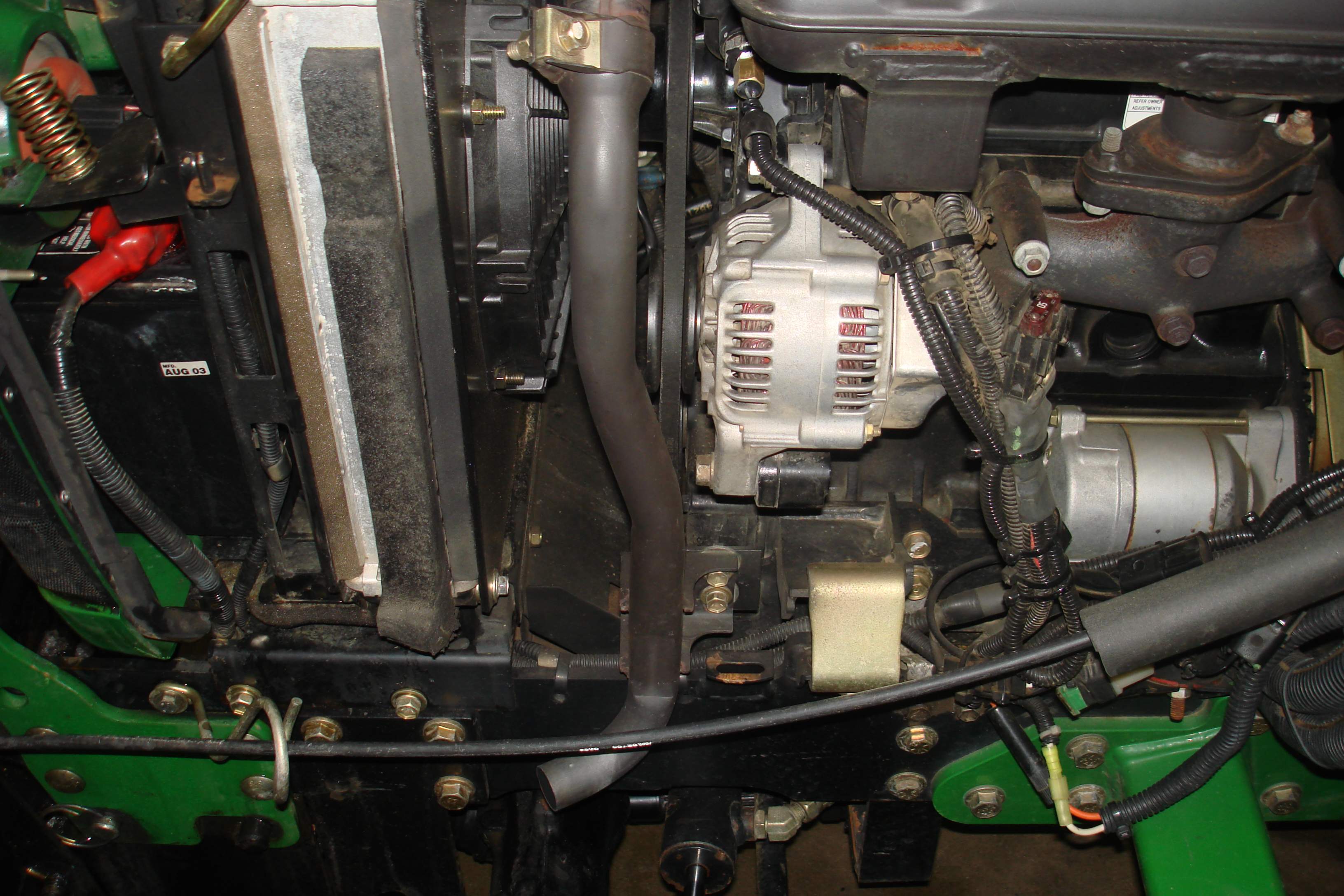

I had to upgrade my alternator to accommodate the cab with the new lightning and heather. JD sell a 35 amps. alternator that looks exactly like the original 20 amps. Very easy to replace, but on the downside, they sell this alternator around $550.00. But it works and I can't complain.

This is the 50amp I put on my 2210 a few years ago. well worth it.
