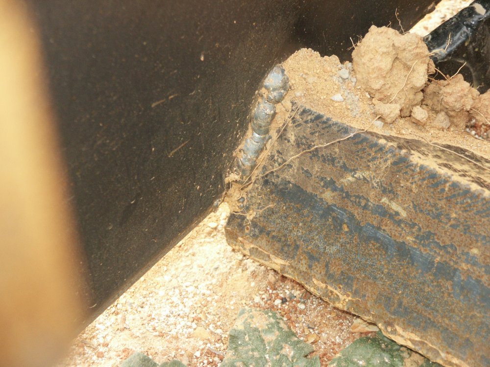

This is made from 65mmx65mm (2.5") angle with the open side closed by plate. The rear of the angle is flush with the bottom of the skid and the front is simply dropped 20mm (3/4"). The "wear edge" is nothing more than weld from the MIG. I can re-do the welds if they wear away - much cheaper than buying a wear-edge!

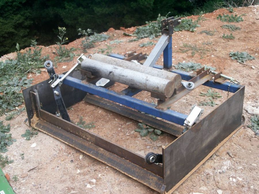

The 3PL is lying on the grader (sorry). The cylinders are the weights I use. The drop-in plate is visible. Very effective, but the slot it drops down into gets slightly jammed with small stones...
Next step is to paint it, now that I'm back home and I know it works!

   / Upcoming build - question for grader owners #8
Kjm that is a back view of the grader and that back blade is used to somewhat compact the soil you scrapped off ?
   / Upcoming build - question for grader owners #9
Actually I think that is just the other side of the angle iron he used as the blade. Your just looking at it like he did it to smooth the dirt or as a rear push blade but I think if you consider where the other half of the angle iron is you will understand. I thought he had added a rear pushing blade like is found on a lot of box blades until I thought about it being angle iron.
