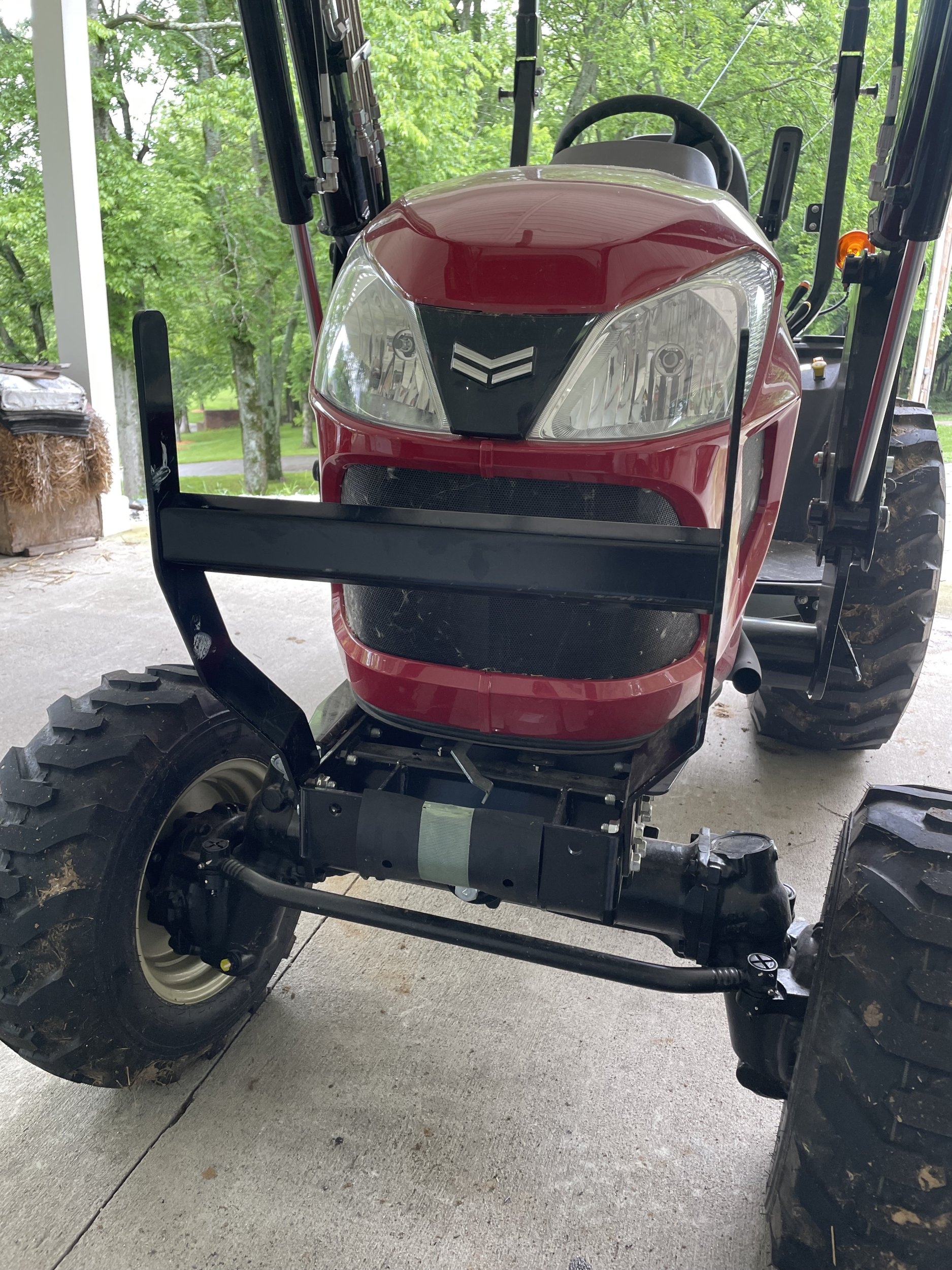

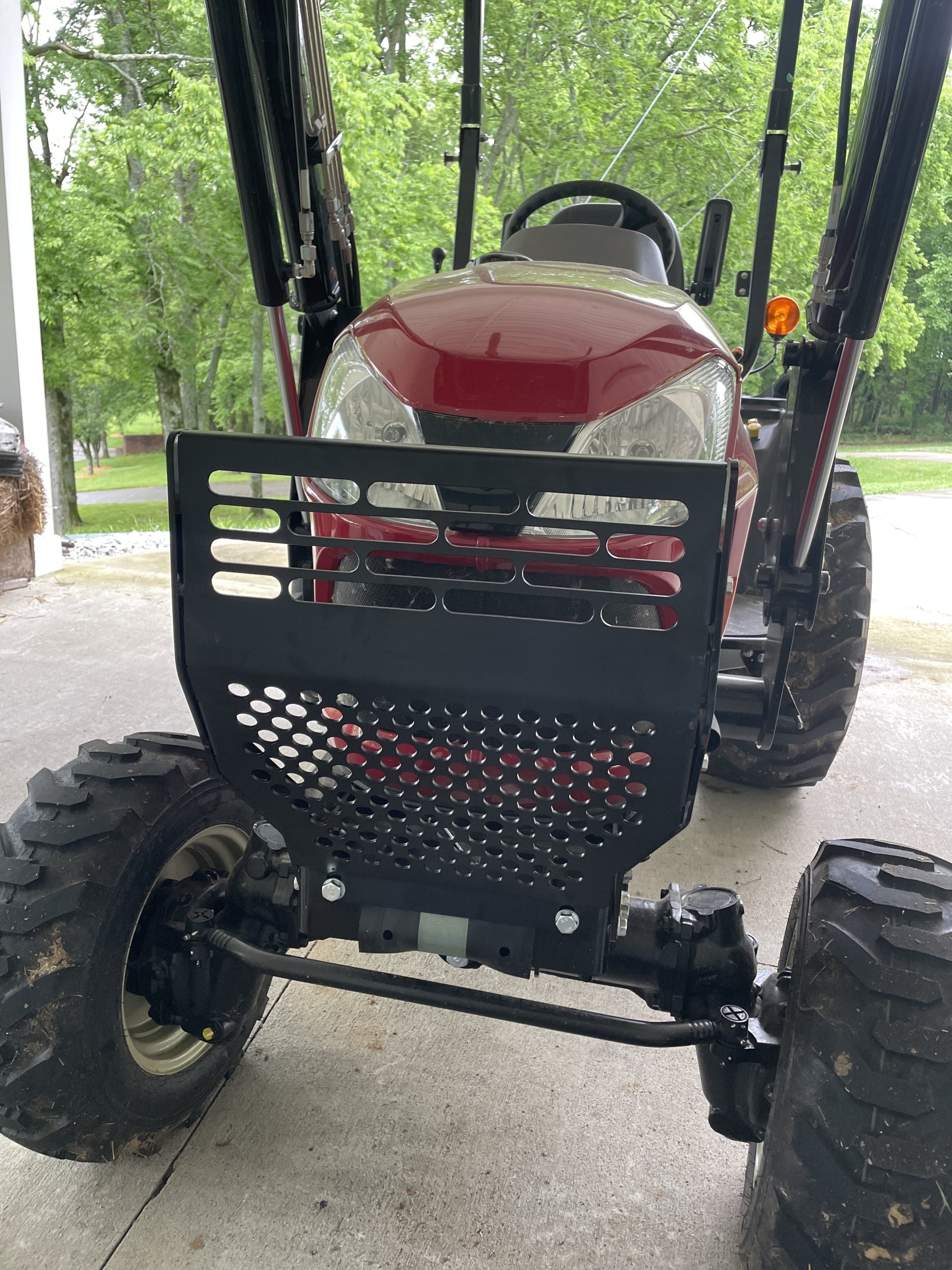

Installed the Broken Anvil Grill Guard. Took about 30min. Fit the grill with the lower bolts and some clamps. Marked the mounting tab holes, center punch, 1/8" pilot hole, then step bit to 11/16ths. Paint the inside of the steel and snug it up. Pretty straight forward.
Super high quality part and powder coating was worth the extra $65... $290 delivered (5/23)
I've already gotten branches and sticks between the Bucketeer/loader and dangerously close to the grill screen. Good insurance.
I also didn't know that the SA 425 came with the fan guard standard. I crawled under after seeing another thread about a shattered fan..and it's already there. (Happy Dance)

Like the width questionable about height blocking lights for night use.
   / Up-Armored with Broken Anvil grill guard
I'm installing led light bars...next project. The OEM bulbs are " lights in name only"...;)
