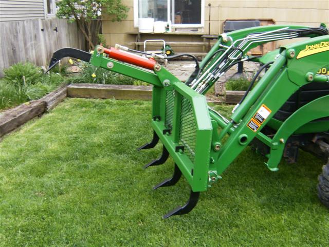

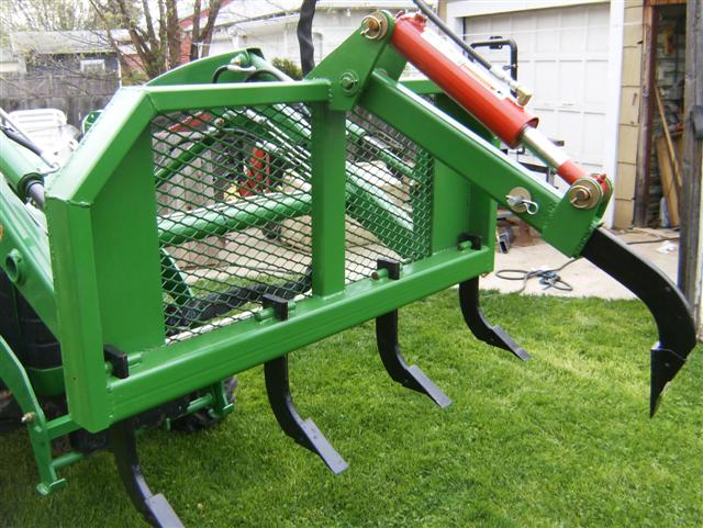

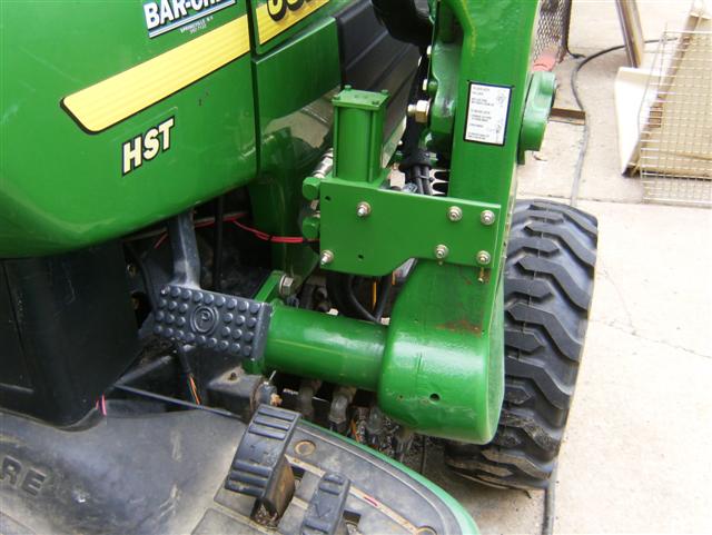

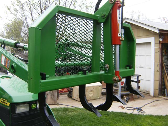

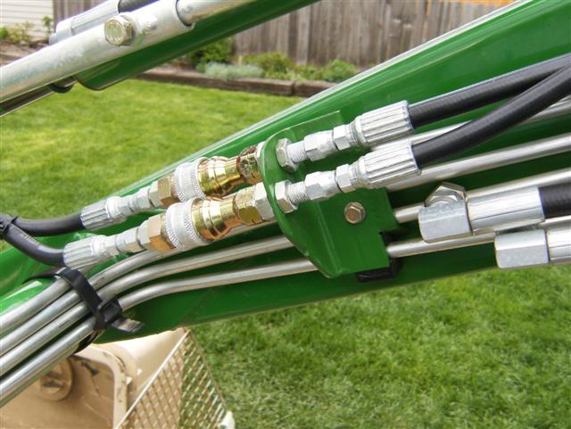

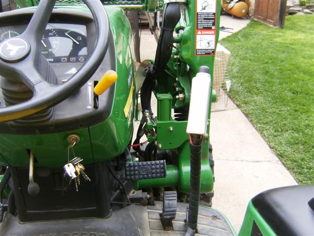

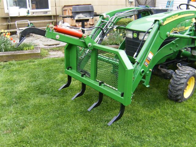

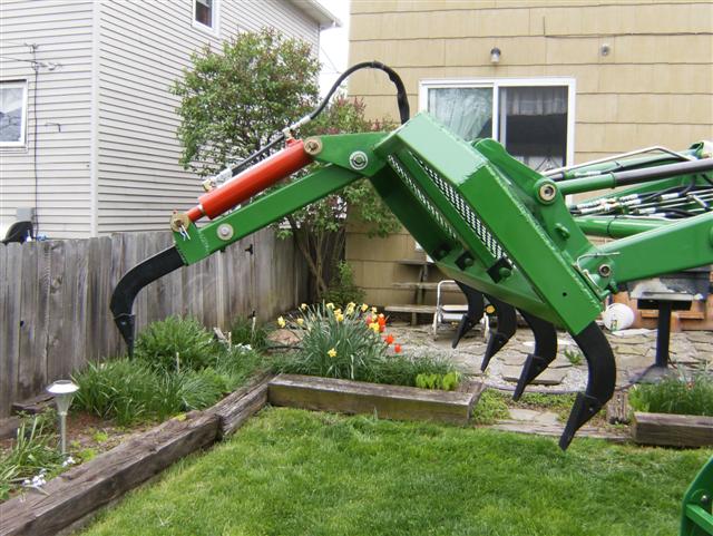

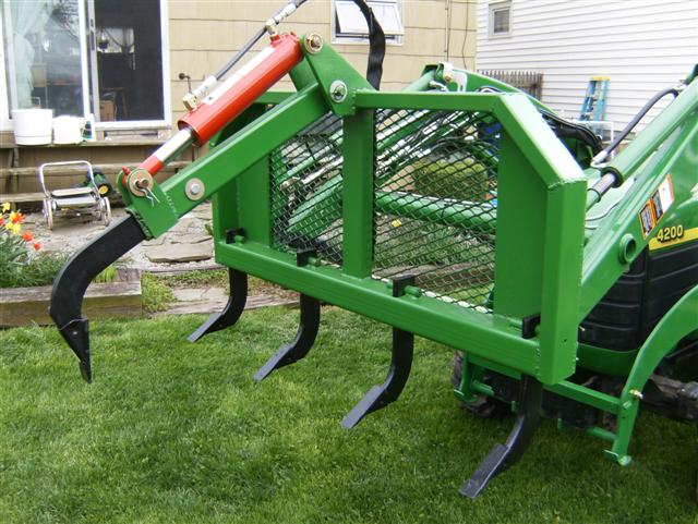

First of all, this post only proves that I'm a decent 'copy-cat'! All credit goes to "Willl" on this board for his patience, putting up with my countless PM's, and KennedyD, for the same on hydro knowledge! Guys, I can't thank you enough! I wanted to have the Hydro-Diverter stay with the loader arms when removed, so I guess I answered the question- "Can you drill into the posts?" Yes, you can! "Will the Towers fall off?" I don't know:eek:! J-J, Ain't she pretty? See what custom fit hoses will do? And, "no" I won't make that mistake again! Thanks again fellas! ~"Scotty"

OK Caci & DT, Couple more pic's. Rt to Lft: The 'Classic' Willl-Da-Beast pose, made famous by Willl's avatar! That's what got me started! Next two, fully closed grapple. The front frame will rotate completely forward to just beyond horizontal. Jimgerkin- Guess I should have addressed that! I've got lots of pine on my small (27a) acreage south of Buffalo that my sons and I are trying to clean up! My intent is to primarily use it to 'ferry' brush, and logs from the Deer Plots we're trying to get established. I've tried with the FEL bucket, but always end up dumping a half bucket of dirt on the burn-pile! Lower tines with also help with smaller root removal! J_J Thank you sir! I'll wear those stars proudly! ~"Scotty" OH! Mines an outside Tractor! It get washed often! Thunderstorms tonight will touch it up again! ~S
