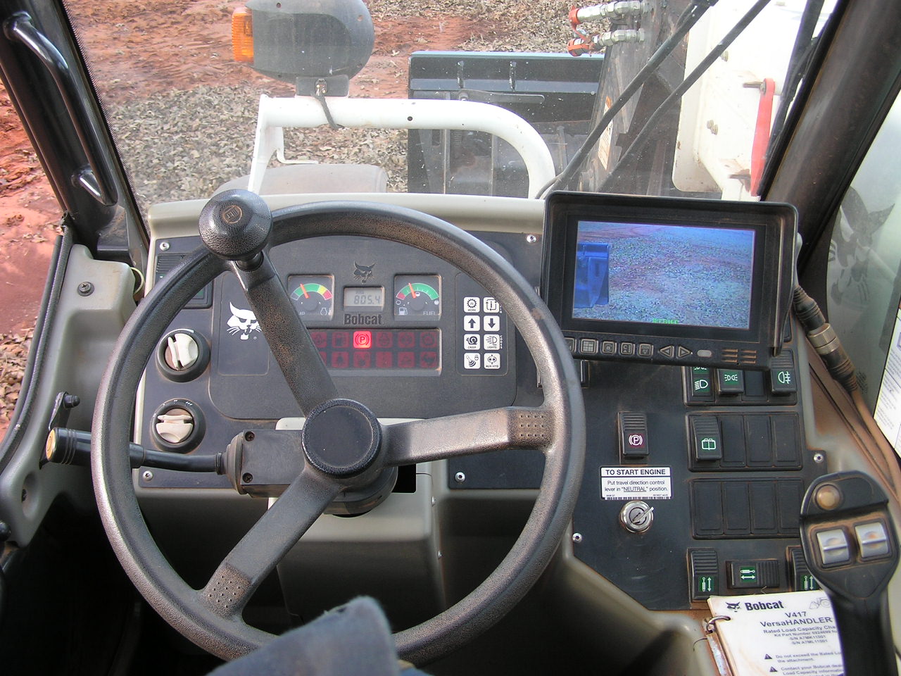

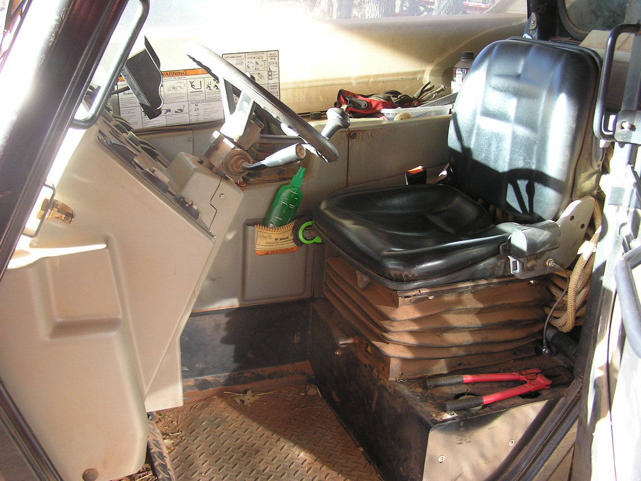

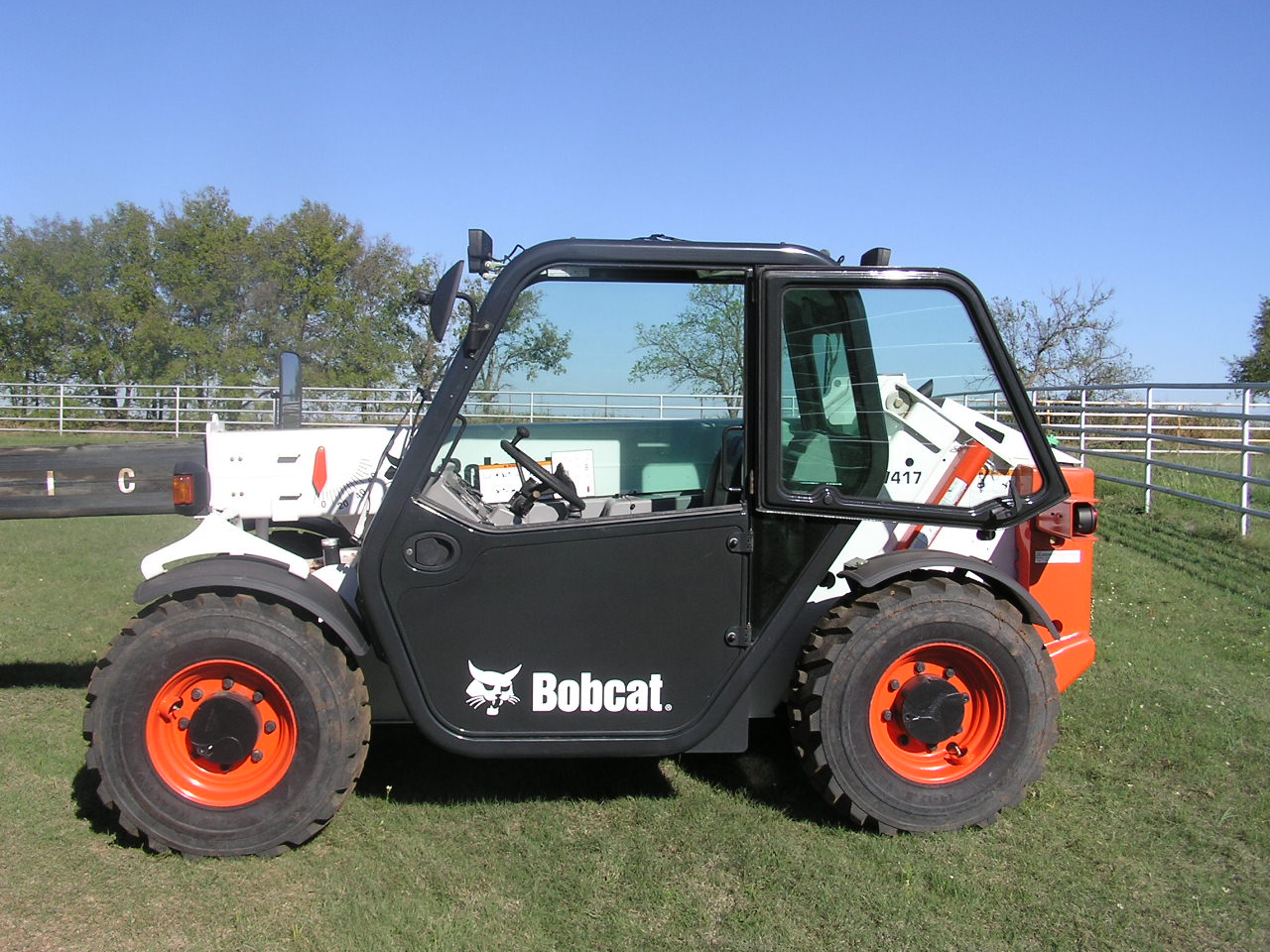

Well the regulars on here know that I am going to recommend a compact telehandler. :D
We have four horses on 80 acres and the Bobcat V417 and attachments does everything necessary.
Some previous discussions:
http://www.tractorbynet.com/forums/.../274285-single-tractor-vs-skidsteer-mini.html
http://www.tractorbynet.com/forums/...307243-skid-steer-vs-tractor.html#post3712135
The little telehandler:
