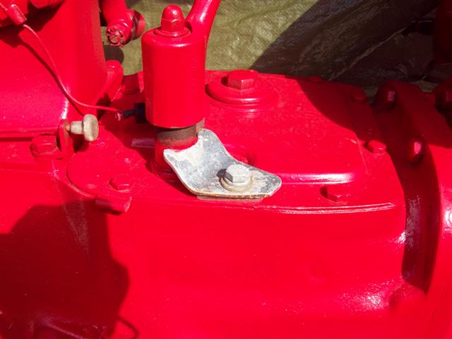

   / Unsure about Ford 850 gear shift positions #10
Look to see if PO has install a lock out on forth and fifth gear. I have a homemade job on my 950 for pulling. You don't want to hit forth or fifth by mistake for pulling. Look under shifter to see if it goes all the way down or if a piece was added to prevent this.
Kirk
