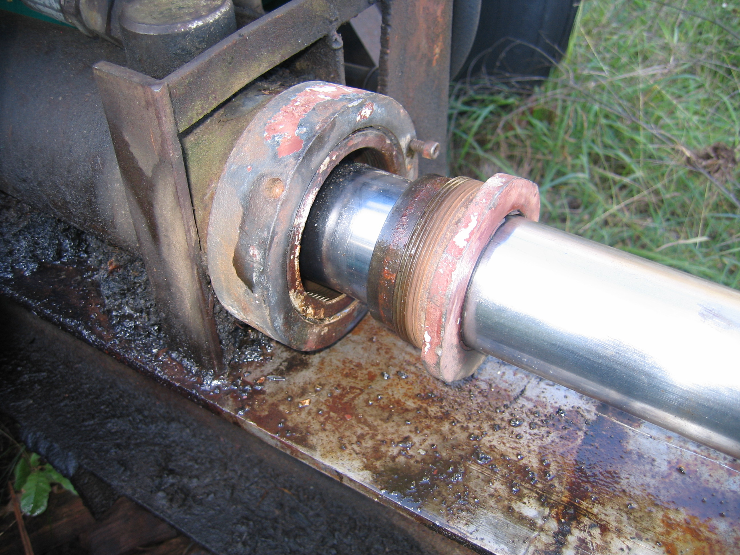

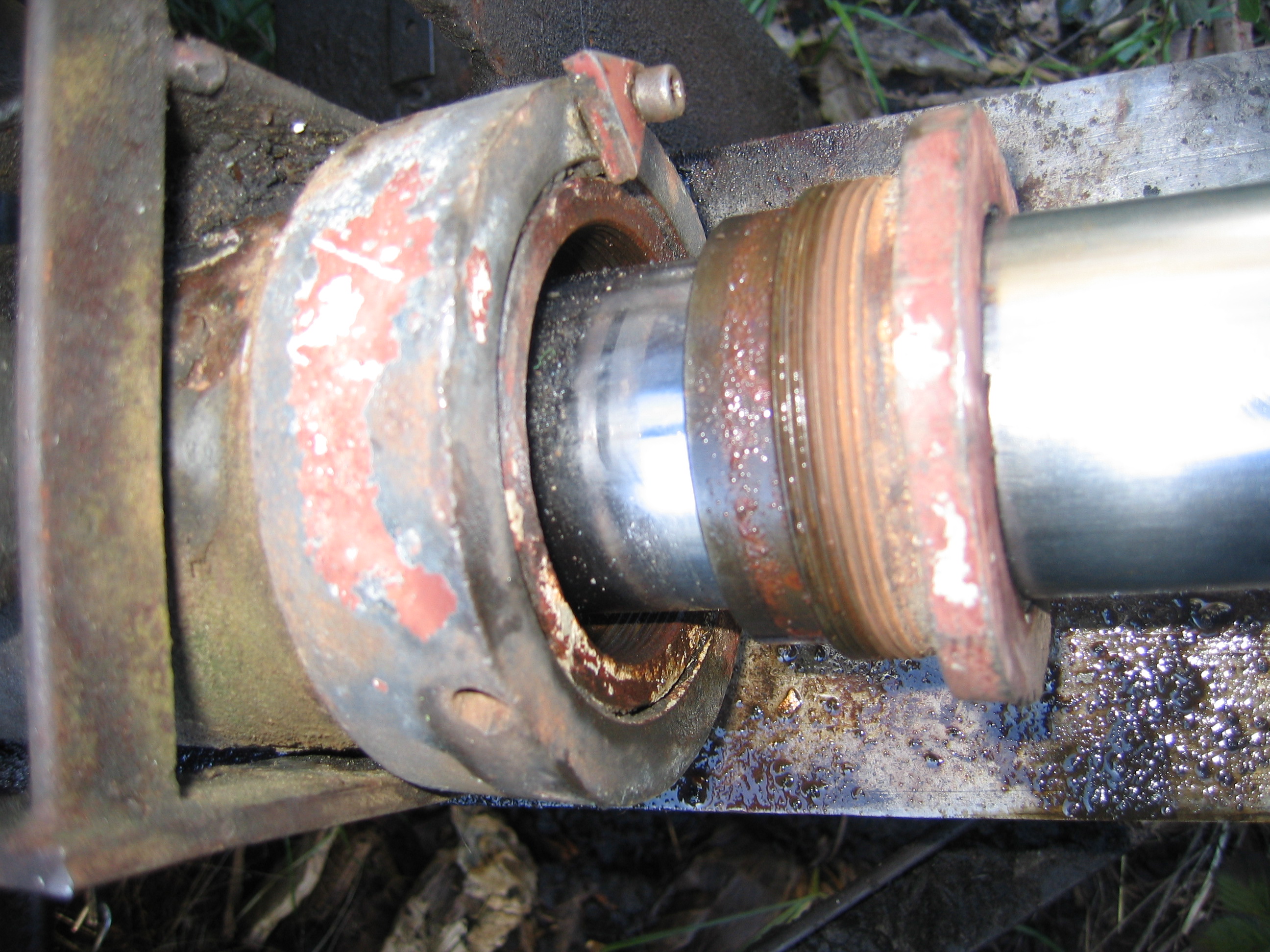

This splitter cylinder retracts great, but has no energy splitting. Different valves make no difference. Must be the seals inside? So, I figured out how to remove the first part, but have no idea how to unscrew the collar ring. There are two set screw holes, but only one had a set screw in it. I'm thinking over the years that water may have gotten inside to the threads. How do I get that collar to unscrew? I do not have a pipe wrench THAT big! Weld a small block on it and knock it off that way? No idea the age or the brand of this cylinder.

Yes, The threaded cap on the left needs to come off......if no pipe wrench use an air impact hammer plus heat......
/ Unknown cylinder repair.... #4
Looks like there is a hole in the cap on the side, made to accept a spanner wrench. If you dont have a spanner wrench, start there with a hammer and punch or the air hammer idea.
But before all this trouble, did you put a pressure gauge on the system? Perhaps a 2-stage pump not shifting to low? Or a failing/weak pump. I'd spend a little more time diagnosing the problem before tearing anything apart.

The two holes on the side of that cap are threaded 1/4-20. Only one had a set screw in it.I suspect over time water got in and may have caused some rust. I have not checked pressure with a gauge. I assumed it would be a loused up cylinder seal because a valve body change had no affect. The cylinder has full power in retraction, but very little in extension. Only enough to barely help along a heavy pull by hand. And there is leakage at the ram end, too.
was wrong about those two holes. Not 1/4-20, but they are threaded. Anyway, I welded a a 1/2w x 1L x 1/4T to that collar. Would not budge. Put the torch to it for about an hour. Kept moving it around the perimeter. After a lot of serious hammering on that welded tab I did get it to budge about a 1/6th of a turn. Must be a better way. I'm open for suggestions. I've started checking for a replacement cylinder, as I don't think I can get this one open. One more thing...after giving up on the heat and hammer method I liberally sprayed it with PB Blaster. Will do that again in an hour or so and let it soak and keep smacking it. I think I need a hydraulic cylinder to get this hydraulic cylinder apart!
