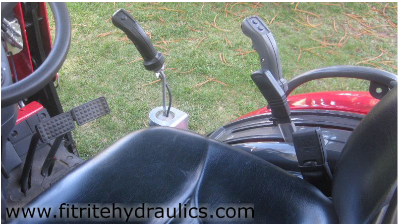

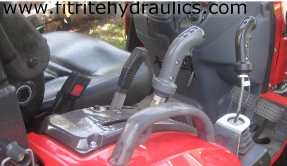

SYSOP, not sure why you are thinking that with the control grip that I provide you would have a trigger and a button, :confused3: normally you would get 2 buttons. I can furnishe any combination of the 2 buttons and 1 trigger switch, but typically only have a single trigger or 2 buttons and a trigger. It would be a custom request to have a single button and a trigger.

I was going by the images on your site.
I assumed the forward-most controller was the FEL and was the controller handle shipped with the kit.
View attachment 342626View attachment 342627
That's why I posted this thread. I'm getting closer to a purchase and wanted to get some comparison things worked out before committing.
It is, but I use diverter 3rd functions on both of my tractors that have them and only require a single button. You would get a grip like this.
The rearward grip is the control grip for the rear remotes and has 2 buttons and a trigger for the 3 switches.
Just don't want people to get confused. ;)
