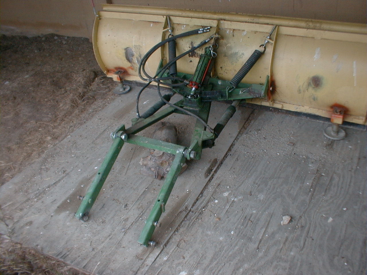

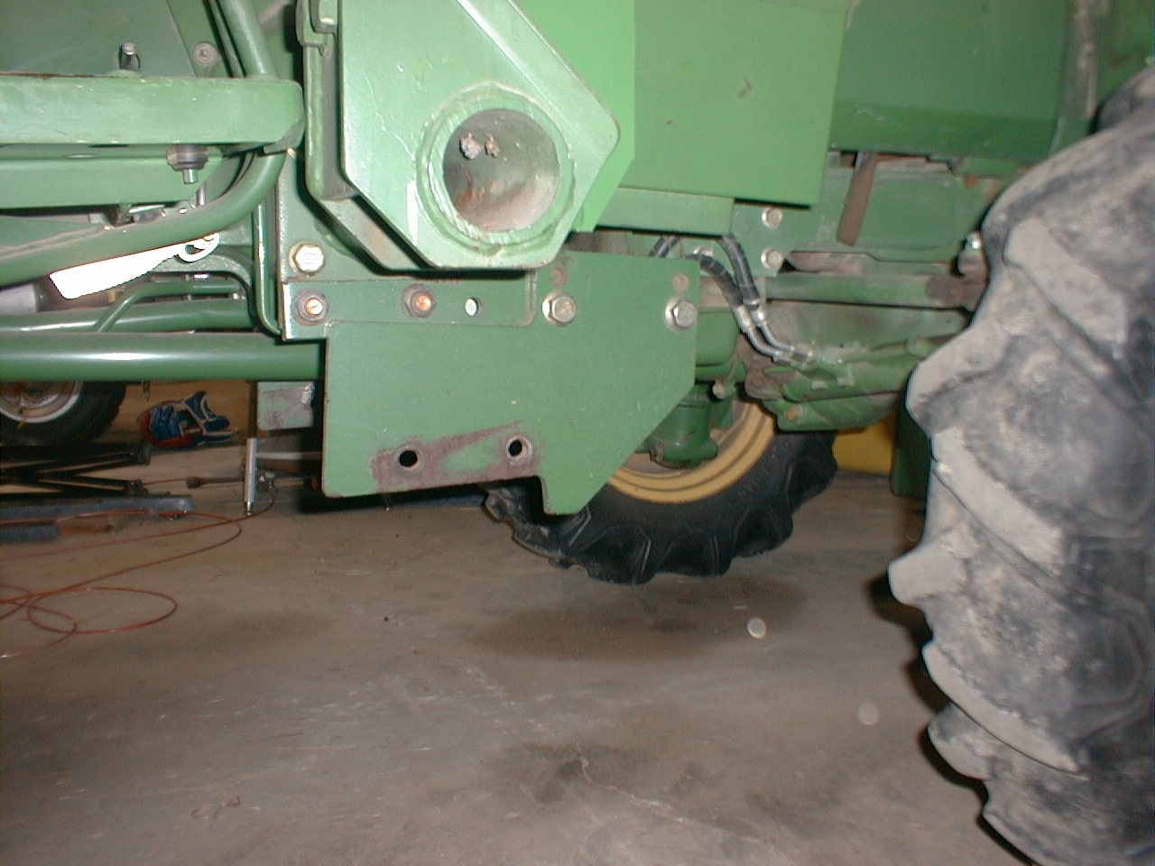

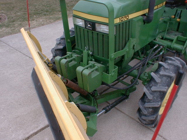

I've done this. Pretty easy using the 'fish plates' from a mid-mount mower attachment dropped from the frame and 'arms' reaching forward for mounting the plow frame. Loader is off. Single stalk control gives left/right to swing left/right. Back is up and forward is down with float. I prefer a double acting up/down cylinder to crack and crape ice in both directions. Leave room for plenty of front weight(s). My plow is mounted as close to the front axle as possible so there are no steering or yawing problems. The left/right swing is best understood as the two single acting cylinders acting as a double via their push/pull mounting positions. If you have left/right brakes, you can have some fun making spin turns at a turn-around point. I used brake hoses from a car to lower the response speed, but I can still 'sweep' snow to the side because it turns pretty fast. I can run down the road in deep snow in high range 3rd gear.
