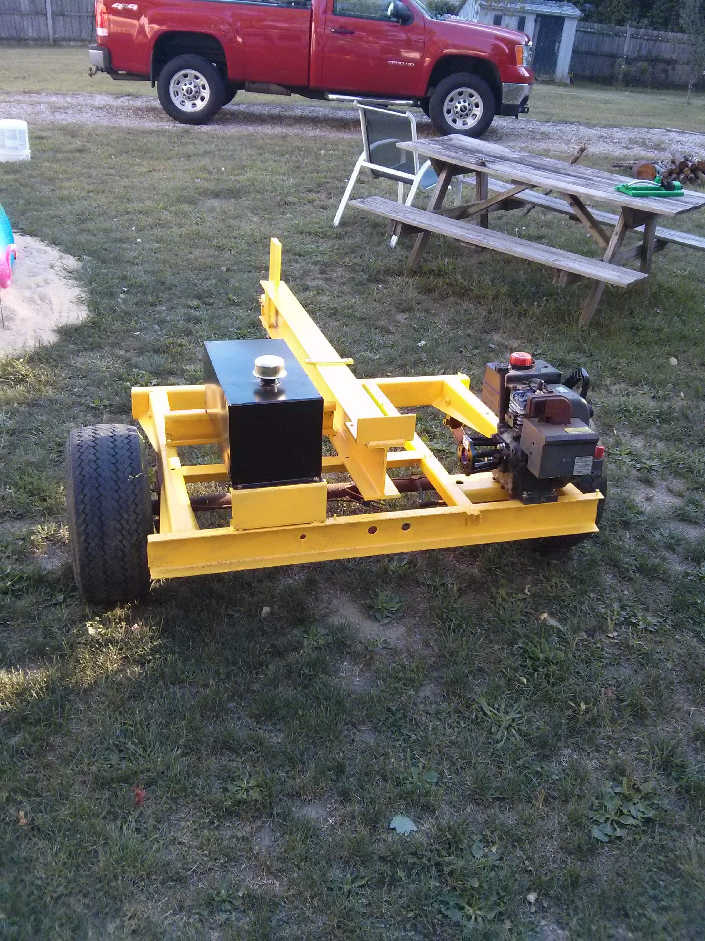

I have a question for you hydraulic pro's.
I'm just about done building my log splitter. Using a factory 4" I beam with welded wedge I got on trade.
Pump is Speeco 11gpm 2 stage. For now, driven by a 5hp tecumseh engine.
Valve has the following specs:
Single spool, Open center.
· Max pressure rating: 3500psi.
· Relief valve set at 3000psi but is adjustable.
· Working ports 1/2 NPT.
· In/Out ports 3/4 NPT
· Detent Pressure set at 700 psi but is adjustable.
· Compatible with most splitters (SpeeCo, MTD, Brave, Swisher etc)
· Screw off end cap for easily detent pressure adjustability
The cylinder however is undersize based on pump recommendations. It is 3" bore by 18" stroke. 3000psi operating pressure. I'm guessing around 13ton?
I'm assuming that, with the relief set at 3000psi on the valve, I'll simply have less splitting power than my pump is capable of?
I just don't want to create a scenario where I blow a hose and cause a safety issue.
-- Joe

as long as the relief valve settings are under 3000 psi you'll be fine. I have a splitter with the exact scenario... I have the Powerhorse 13 ton splitter.... You'll be amazed what a 13 ton splitter can do... I haven't found anything I couldn't split without a bit of finesse...

You gain speed by having a smaller cylinder; the flip side is that you loose power (tonnage). My free Android hydraulic calculator app puts it at 21206# of force (10.6 ton), which is reasonable for a lot of basic log splitting.
As for the fear of a broken hose, I agree with CMHyland. I'm guessing the above scenario had more to do with air in system. That is a pretty big pump for a small cylinder, which is not a bad thing, but you should have 11gal hydraulic fluid.
My 16GPM pump lacked enough hydraulic fluid to run effectively the first test run. Put another 5 gallons.. and you couldn't slow it down! It's a good feeling stocking up wood for a stormy day! The cold is a comm'in.

BTW, a 3000 psi 3" cylinder will only generate 21,205 pounds of push - it would take 3680 psi to get 13 tons... Steve

Heidts, Fragola make 'em up to 3500 PSI. We use 'em for hydroboost. I keep forgetting that 'JIC' is the industrial version of AN, whenever I see them like on my bobcat I just call them AN as it's what I'm used to. But yeah, I wasn't sure if the hydraulic hoses commonly sold were NPT or JIC. They appear to me NPT.
But yeah, aluminum AN fittings are rated to 250psi in most cases (fuel, coolant) where the steel fittings are typically 1500 but the specialty fittings are 3500.
Thanks guys! Hopefully have this thing splitting wood by next week.
-- Joe
