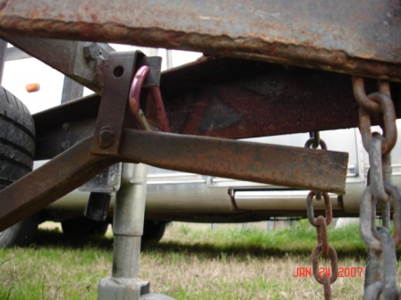

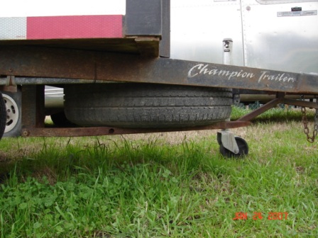

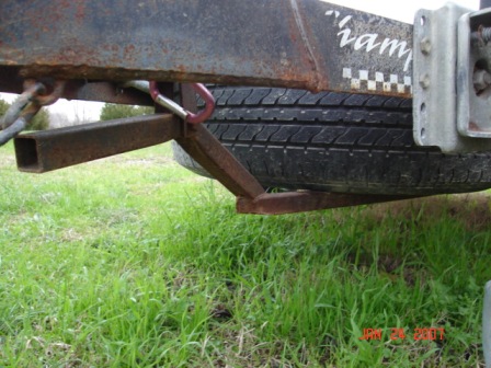

My little 4X8 utility trailer has a spare mounted under the "A" frame part, I pulled it off my Airstream, it is a very simple design made from 1" square tubing that is hinged from two pieces of angle iron with a "U" that holds it up.
I will take some pictures tomorrow and post them.
If anybody knows how low to the ground an Airstream is the they would not ever worry about this mounting design.

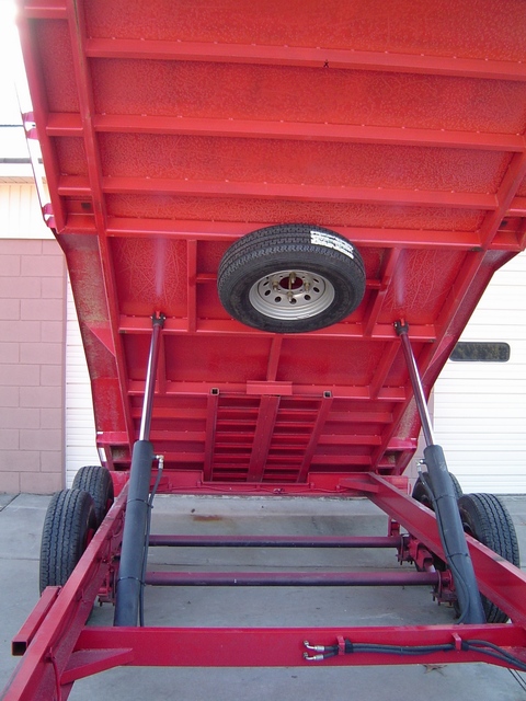

Redbug has his mounted under the trailer,("My new equipment trailer" post), but his is a tilt bed trailer. Yours may be different.

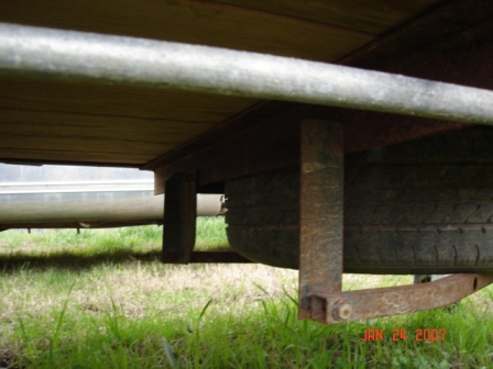

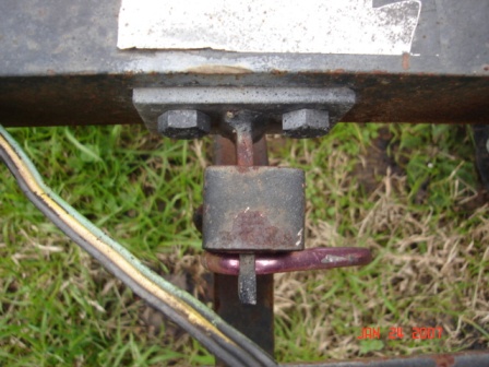

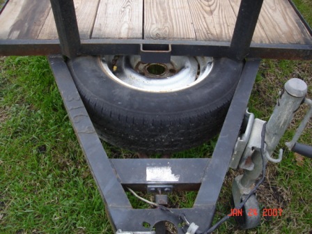

Here are the picts of what my 4X8 has under it.
It came off my Airstream that was a factory install and it fit in the same spot.
It is a simple design and easy to use.
