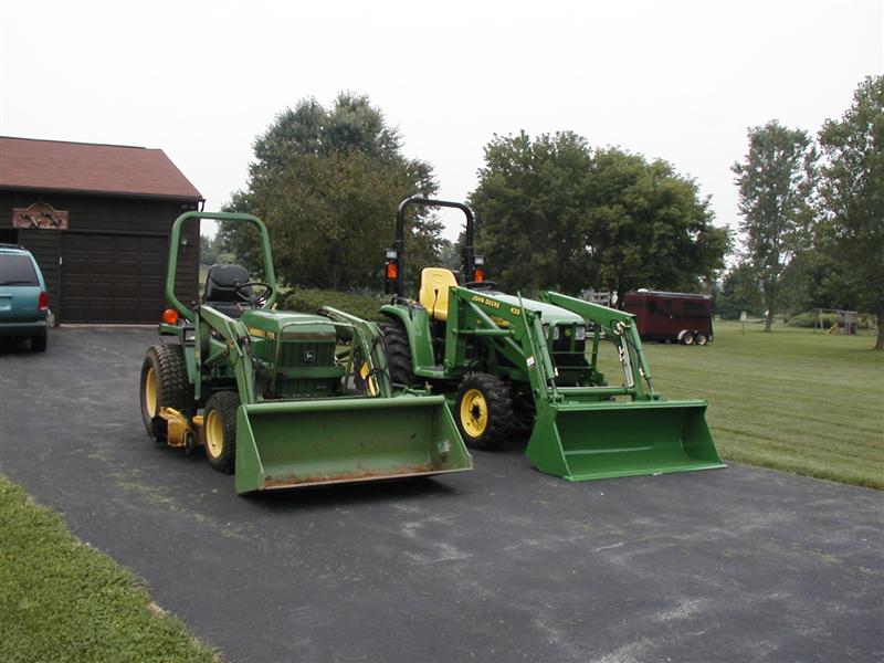

There is no doubt that that inside storage is better but my real life experience shows that outside storage is not the end of the world. My JD755 lived every day of the 16 years I owned it outside with no cover. I cleaned it real good once a year and waxed what I could. I always kept it lubricated and well serviced. The paint was faded more than what it would have been if kept inside but it was still decent and the rust was not excessive. Of course the seat wore quicker and I had to replace it twice due to the cracked and split covering. I had to replace the FEL bucket after about 13 years due to rust through. The bucket sat directly on dirt and I kept it fully curled to protect the hydraulic cylinder rods. I never had any hydraulic seal problems. Attached is a photo of the 755 next to it's replacement. Get your barn built as soon as you can but don't sweat a few years of outside storage.

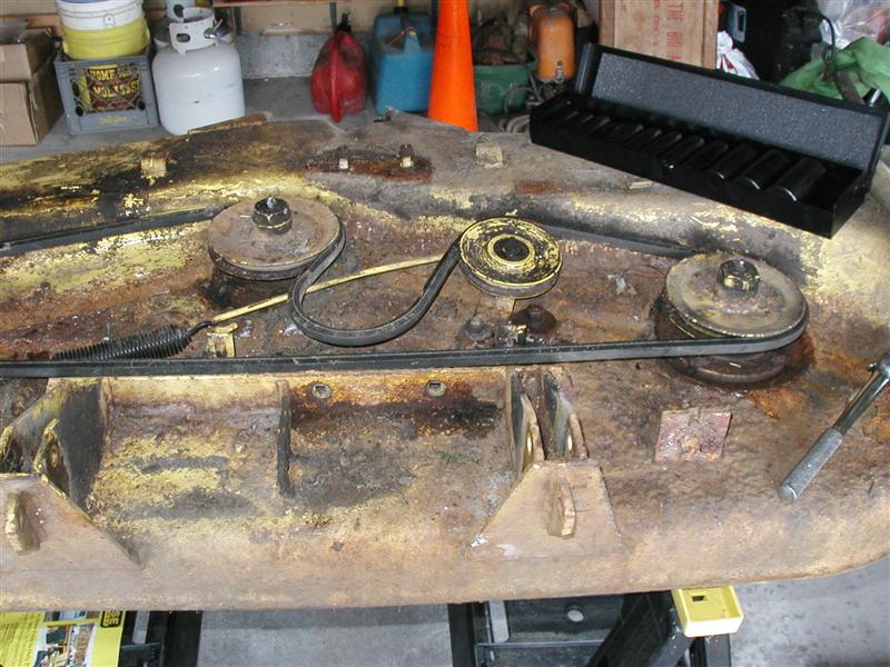

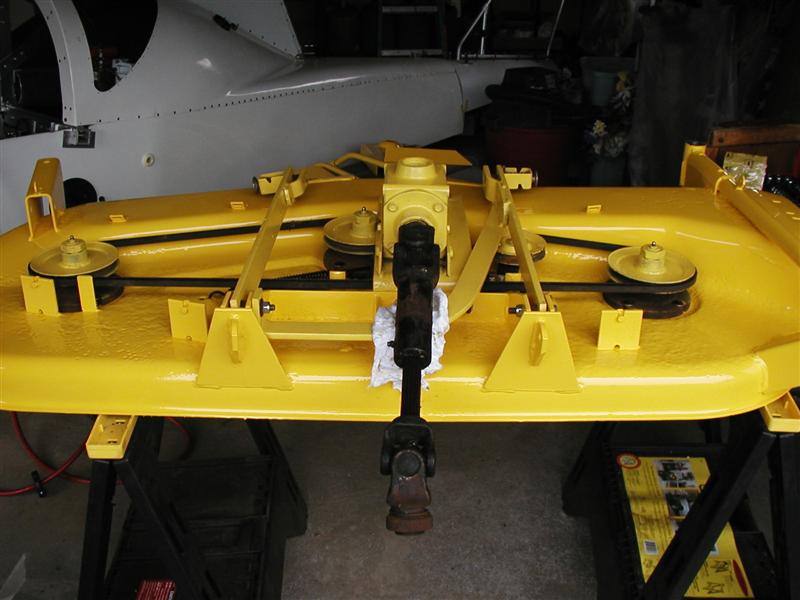

With outside storage the mower deck was affected the most. The deck was always stored inside the garage during the winter but water would collect on the deck during the summer and grass clippings would retain the moisture. Attached are before and after pictures. I had the deck sandblasted and repainted.

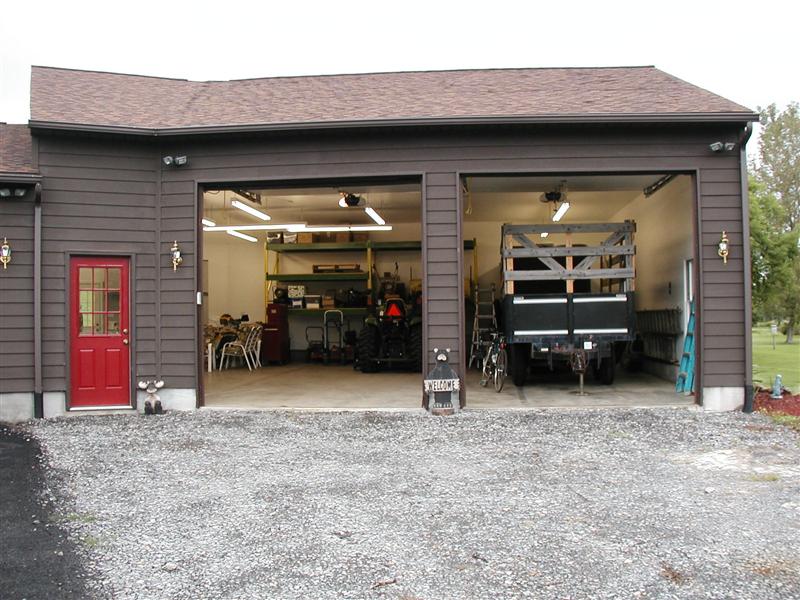

And here is a picture of the garage I added to the existing 2 car garage so that the 4310 would have a better life. It is also better for the dump trailer and horse trailer as they are kept inside too. Finally, there is enough room for everthing to be kept dry and it is easier to work on stuff too. It only took me 20 years.
