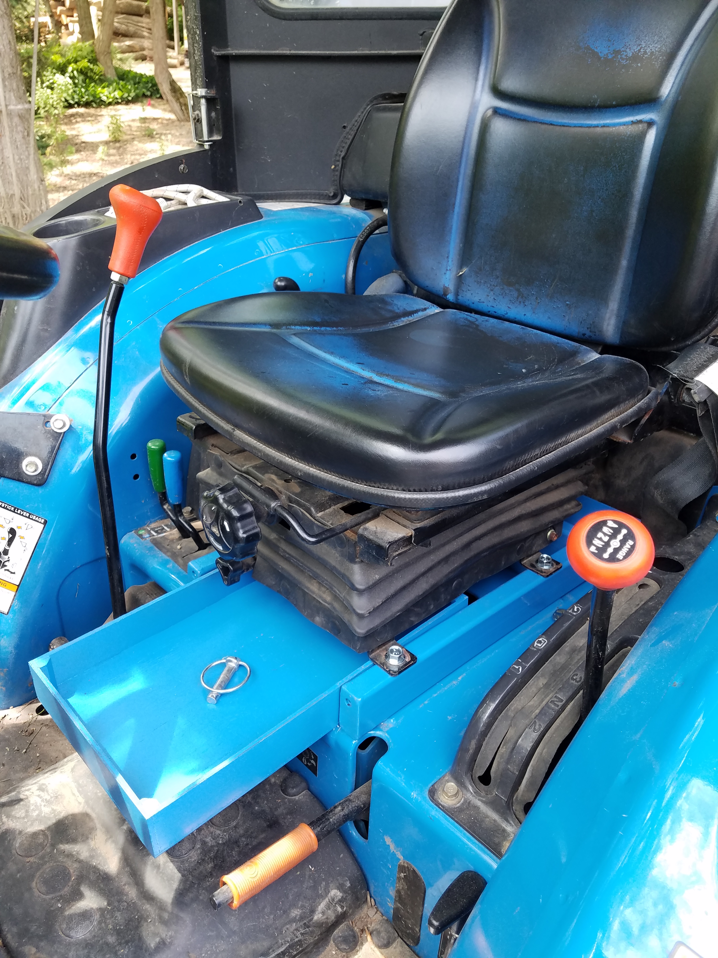

I found the seat on my LS R4047 a little too low for comfort and good visibility. So I welded up, out of rectangular-tube steel, a C" shaped riser for the seat. Then, in the gap, I built a little wooden drawer. I glued some rare-earth magnets to the rear surface of the drawer so it stays closed, but a little tug will open it up. It is a great place for hitch pins, cotters, a spare wrench, etc. 20180617_114607.jpg

Nice! great idea. :thumbsup:
   / Under-seat tool drawer #3
Man, your causing me more work! I did a seat riser, also using rectangular stock, but I just used 2 pieces across side to side. I like yours much better! I'm going to have to redo mine now! Great idea!
   / Under-seat tool drawer #4
Need a pull handle, probably one available in you kitchen....lol...
