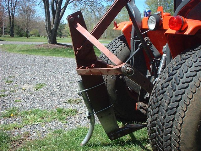

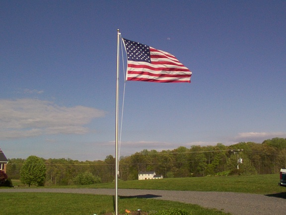

I had planned to use my sub-soiler to install the cable 12" to 14". I only have a run of about 20 feet to the flagpole.
Do you all think I will have an issue?
/ Under ground cable #35
Mike,
It could meet the NEC requirements, if it is Ground Fault protected and 20 amps or less, 12" of cover is fine. If not GFCI protected, NEC requires 24" of cover. But think of it this way also.....if I could hit it at 12", I'd probably hit it with the same equipment at 24" /w3tcompact/icons/grin.gif
/ Under ground cable #36
Jerry,
Thanks for the info. I am only running two lights to illuminate the flag pole at night. I will replace the current electrical socket with a GCFI (is this a complicated procedure or just like any other socket change?).

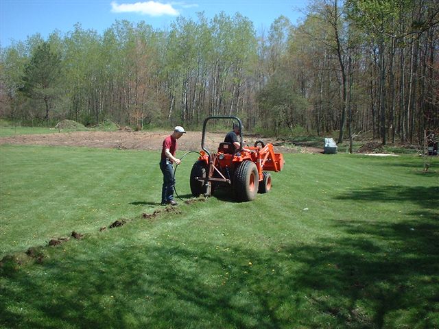

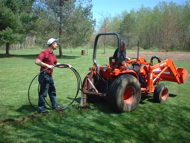

Now thats a big garden. Looks like you could feed all the critters in the county and still have some left to harvest for yourself. Your efforts sure took the work out of that job and actually made it look like fun.
