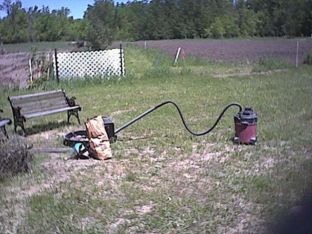

I needed to bend some 5" x 1/4" plate today and quickly realized that my trusty plumber's propane torch was not up to providing the amount of heat needed. It was a bit more complicated by the fact that I needed to put a curl in the plate instead of just a straight bend. /forums/images/graemlins/crazy.gif
Thats when I remembered the homemade forge on my Uncle Kenny's farm. It didn't take much to replicate. I used a shop vac whereas he used a Hoover canister model. He used fire brick and all I had was rocks. /forums/images/graemlins/wink.gif
Well, it ain't pretty, but it got the job done. /forums/images/graemlins/cool.gif
Photo 1/6 - The basic setup.
Shop vac blows air into a steel pipe.
Steel pipe discharges air at bottom of a pit lined with rocks.
Fill with charcoal, light and get to it.

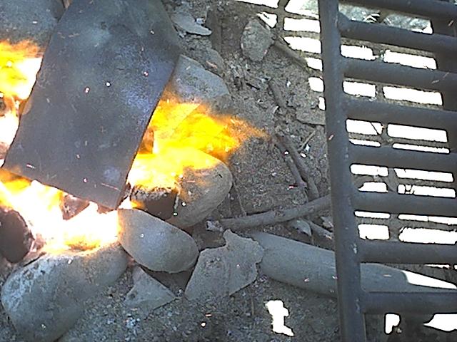

Photo 2/6 - The Forge

was the fuel charcoal or coke

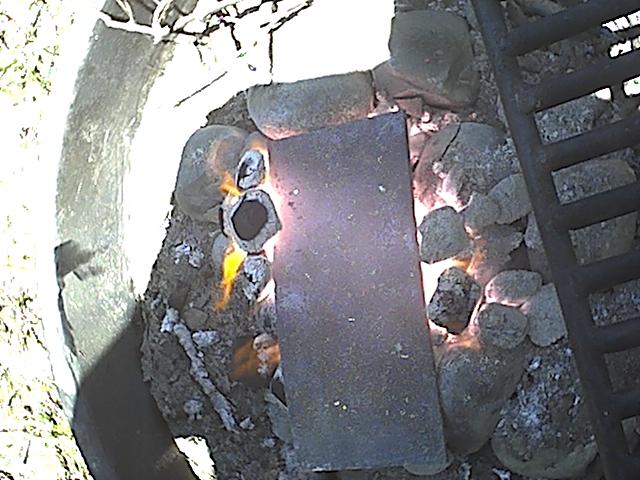

Photo 3/6 - Pipe into forge
Ran the pipe down to the bottom of the pile of rocks. Idea was to allow air out of the pipe but keep the charcoal from falling in and plugging the pipe.
A few elbows would be handy if this were a more permenant setup.

I just used plain charcoal for fuel.

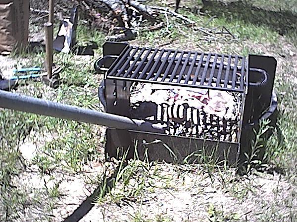

Photo 4/6
Now we are starting to get things cookin.
I keep saying this is a pile of rocks. It is actually a cone shaped hole in the ground lined with rocks. I understand that some rocks can blow apart when heated, so I fired it up and let it cook for about 15 minutes before getting close to it and starting to work.

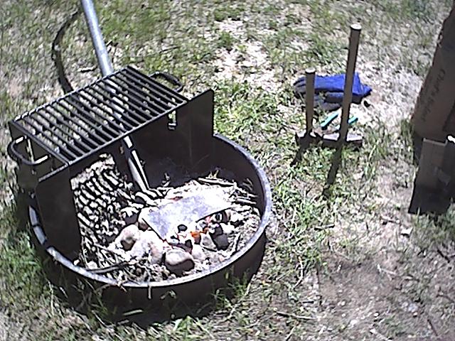

Photo 5/6
I later found that I could get the plate hotter by sticking it down into the coals, but as you can see from the photo, it got plenty hot just sitting on top.
