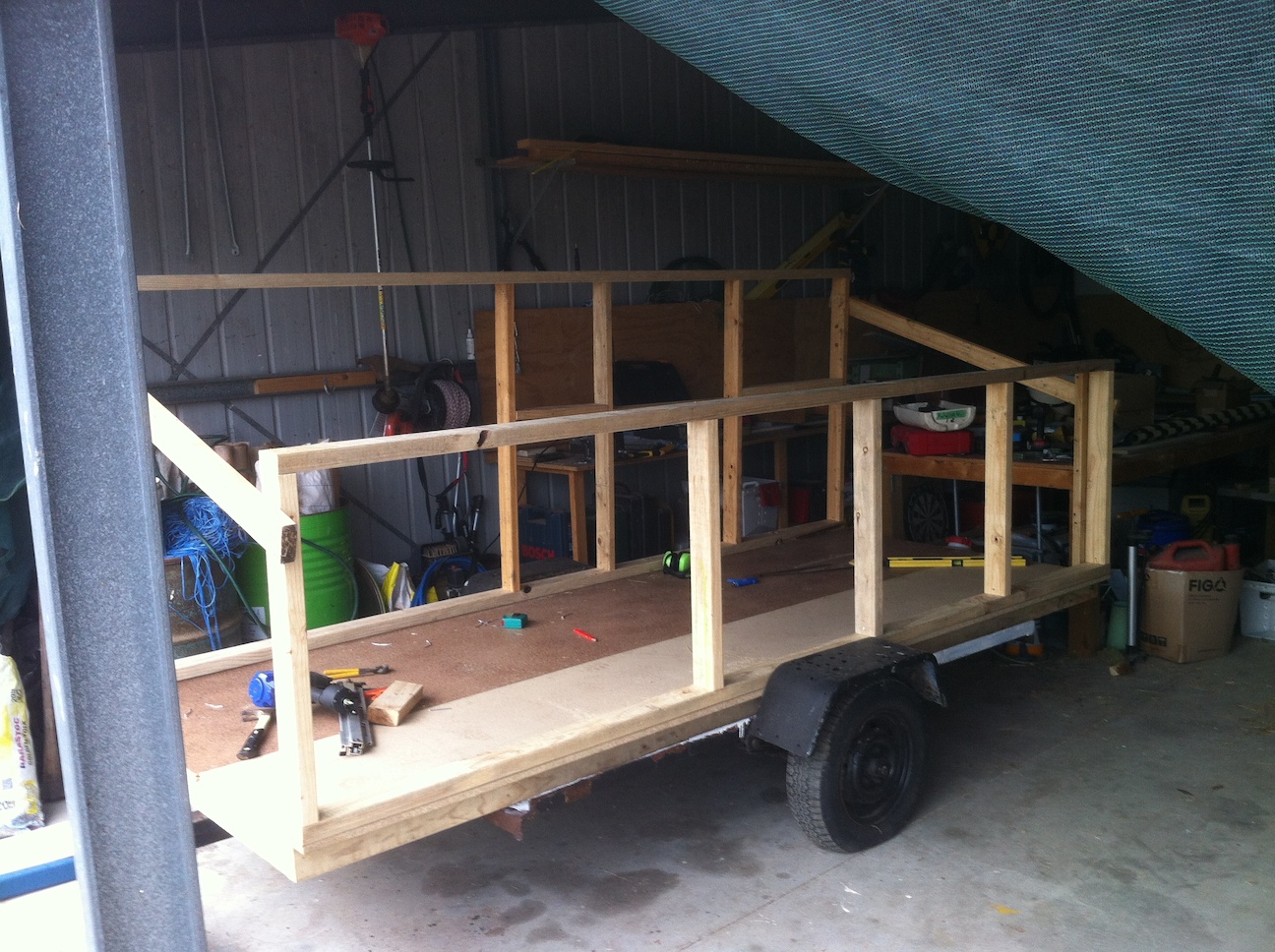

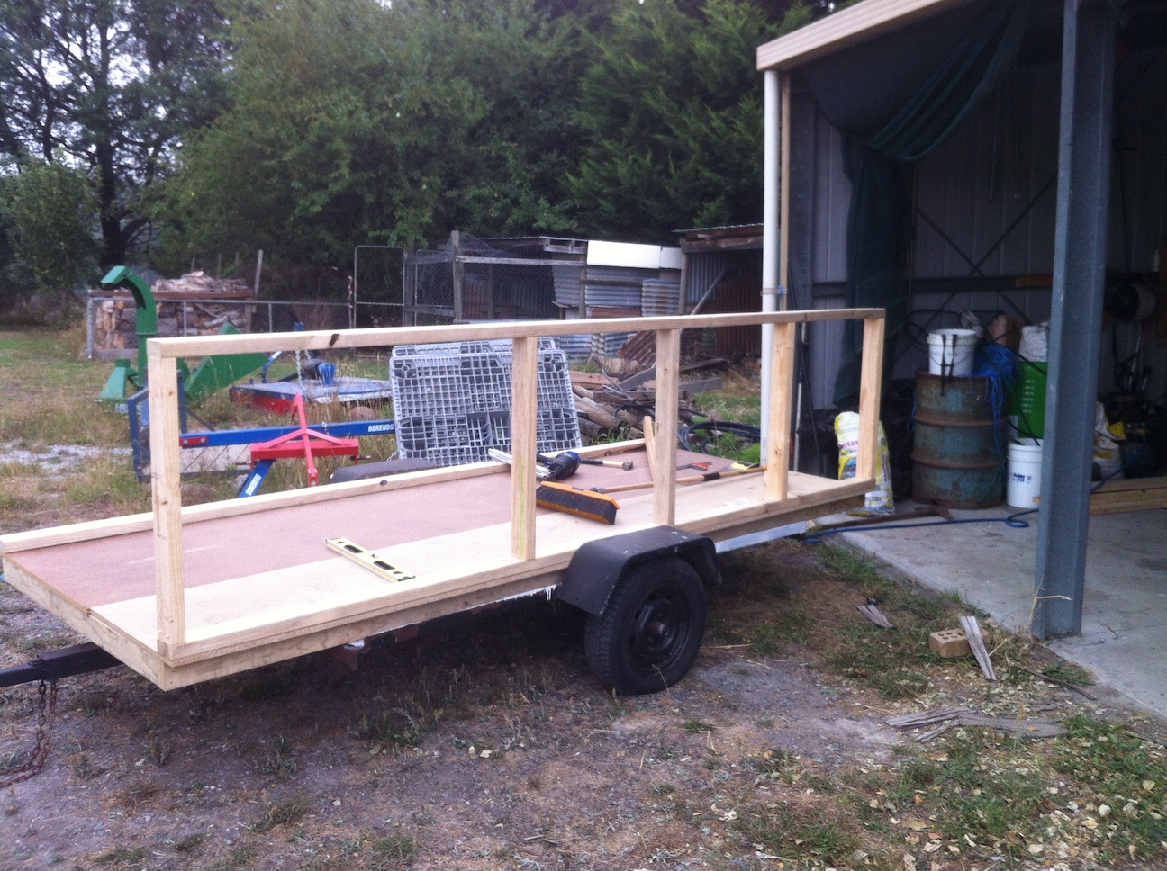

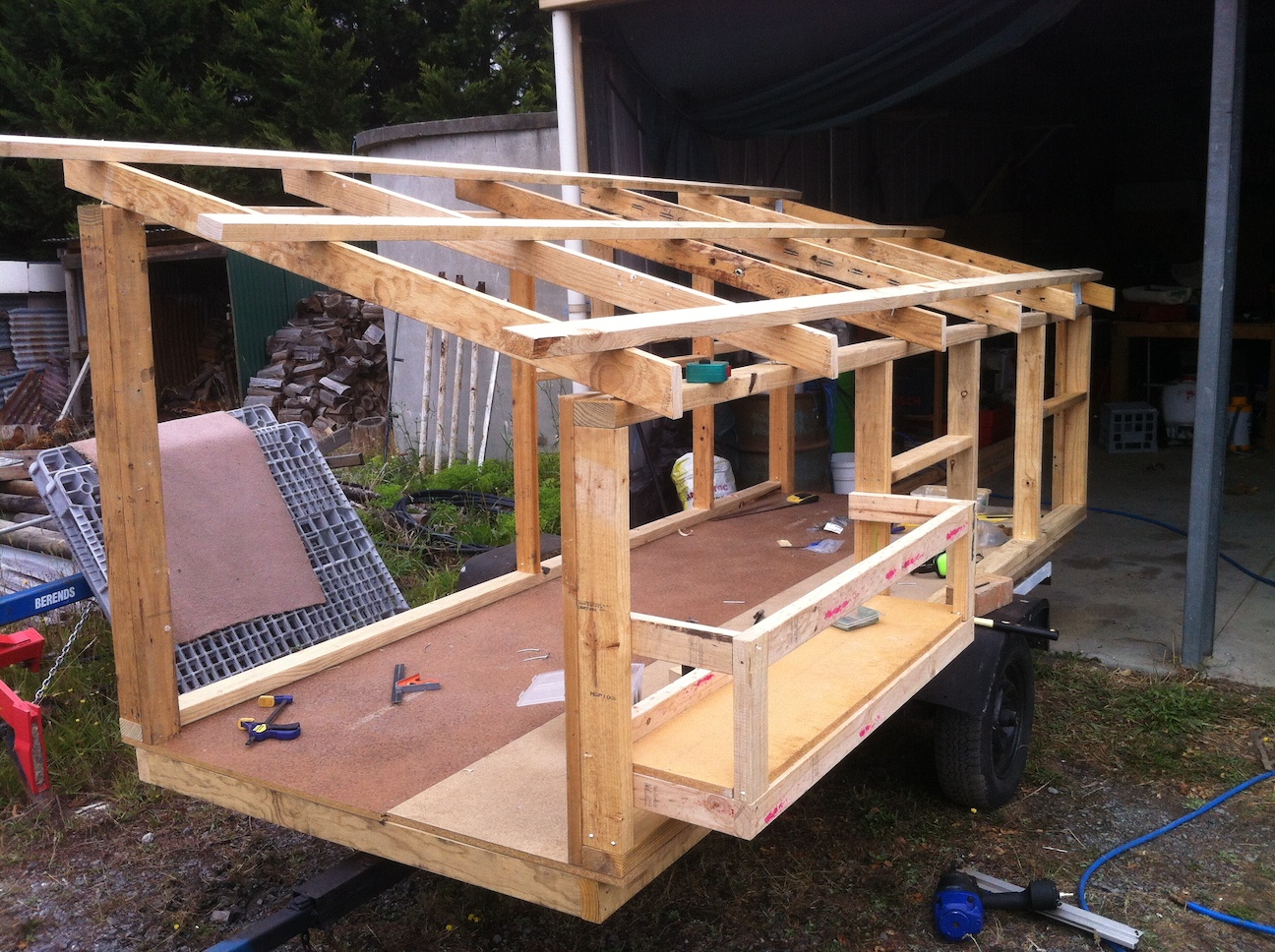

Thought some of you would like to see my current project, a towable chook/chicken tractor for our farm, or to throw your ideas into the ring for how I could make it better as I go along.
The spec for the chook pen is that it can travel around on the farm, housing as many chooks as possible, but costing as little as possible. I started collecting parts for it ages ago, but I've really stepped up the work now that it's not so hot anymore. Since we have a tiny bub, only 6 weeks old, I may have to drop this for periods of time, so please forgive me if I don't post regularly or frequently.

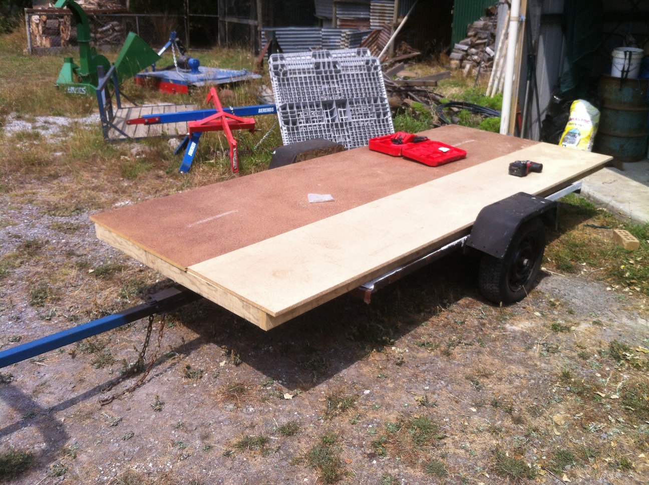

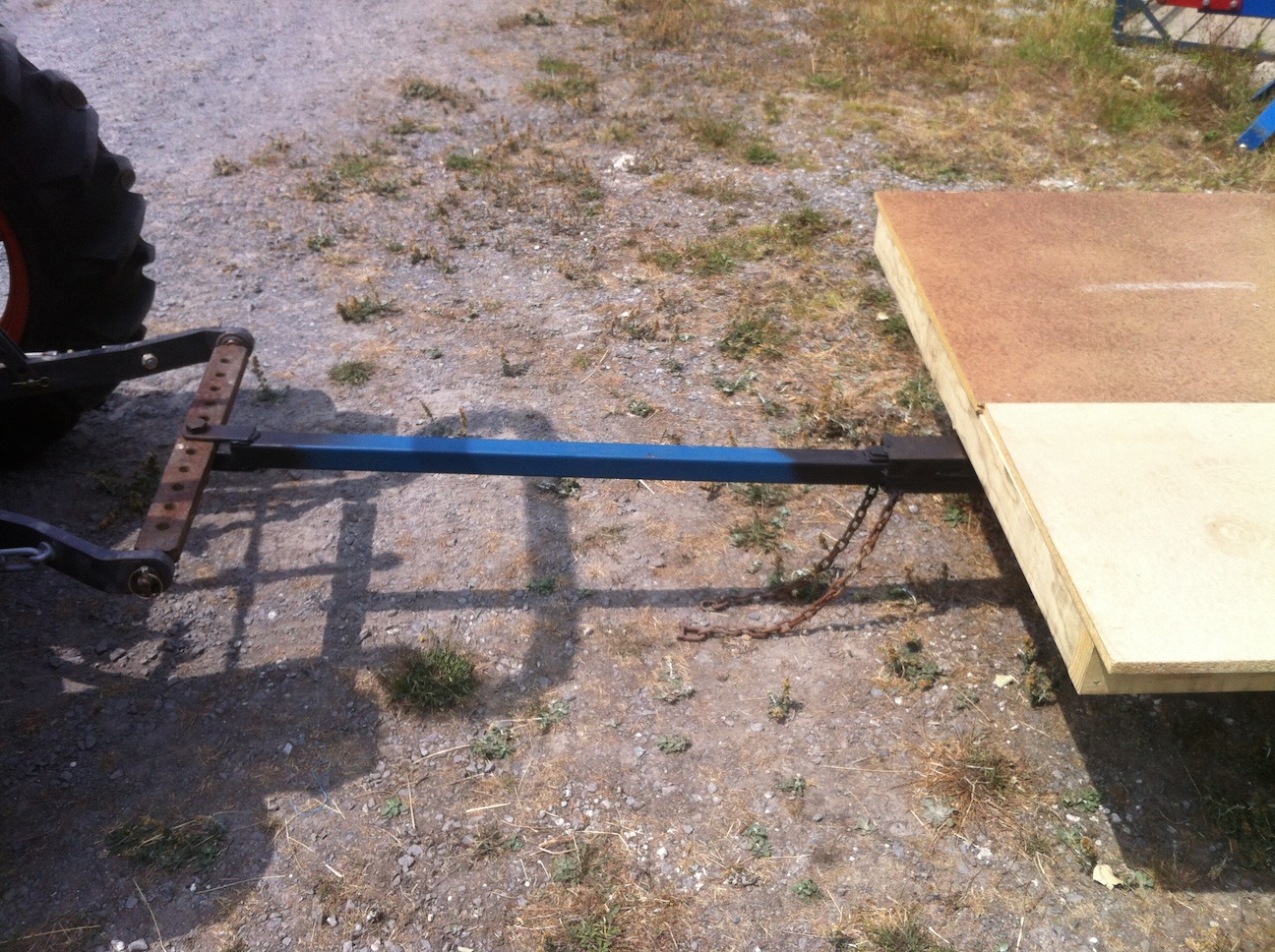

I started off looking for a cheap cheap cheap 6'x4' trailer. I eventually got one on a well known internet auction site for around 100 Australian pesos. It wasn't in great shape, but it's for a chook pen.. and besides the whole pen could theoretically be slid straight onto a new trailer if needs be. So after stripping the trailer down and slapping on some zinc preps to hopefully limit some of the pretty severe rust (no pics for that, sorry but you didn't miss much but rust and dust and a flap wheel). I sat a piece of 90x45 3.6m long on the trailer and it stuck off each end around 500mm.. which I figure should be ok to support a pen out that far. I realised I'd have to extend the drawbar, so I picked up some 50mm SHS thats about 2mm wall thickness. The original drawbar was two pieces of c section welded together, and was much bigger in section than my planned extension, but I made up some shims and tapped them in, then welded the shims to the extension and the original drawbar (again, no pics because I'm not a very good welder).

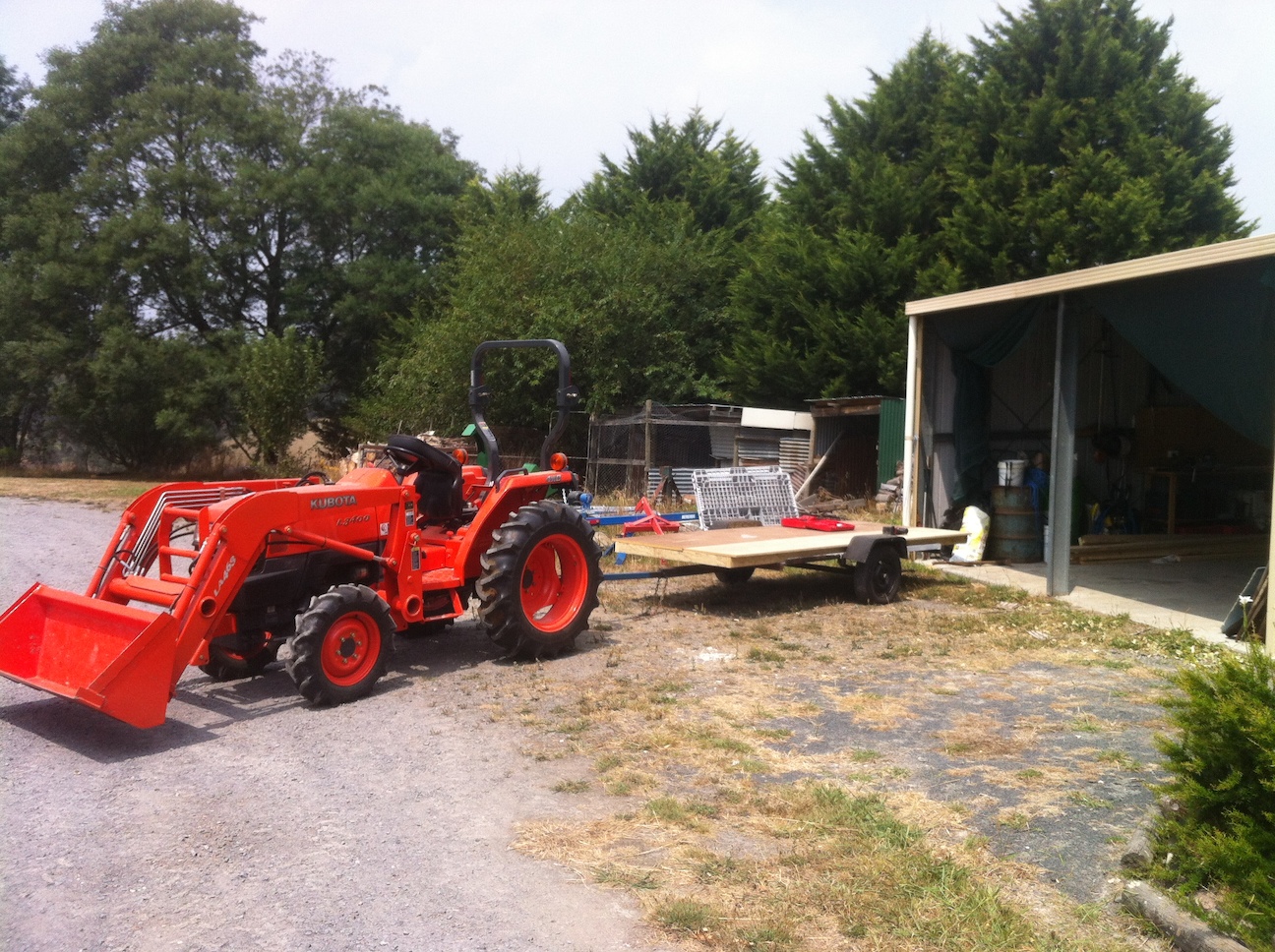

Then I built a subfloor 3600x1390, and sat two pieces of yellow tongue flooring on it. This is about where the pictures come in.
Just the floor
Drawbar

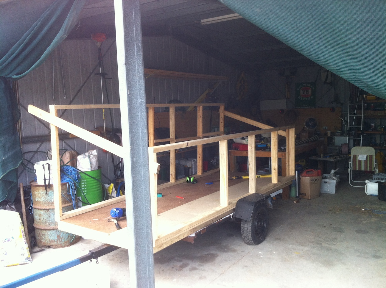

First wall
Second wall
This is as far as I got today. The angle pieces are just tacked on for the moment to stop anything moving as I back it in and out of the shed. I'll start building the roof next.
The opening on the short wall is for the nest boxes, and on the tall wall is for the perches which will have an open mesh floor so the crap drops straight onto the paddocks.

Any other ideas? If anyone is thinking of a similar thing I can already give you one tip: build the wall panels on the ground then lift them into place on the trailer, I didn't think it'd be too hard to build it on the trailer, but because you cant trust the trailer bed to be level, you have the use the square for EVERYTHING which was pretty tedious!

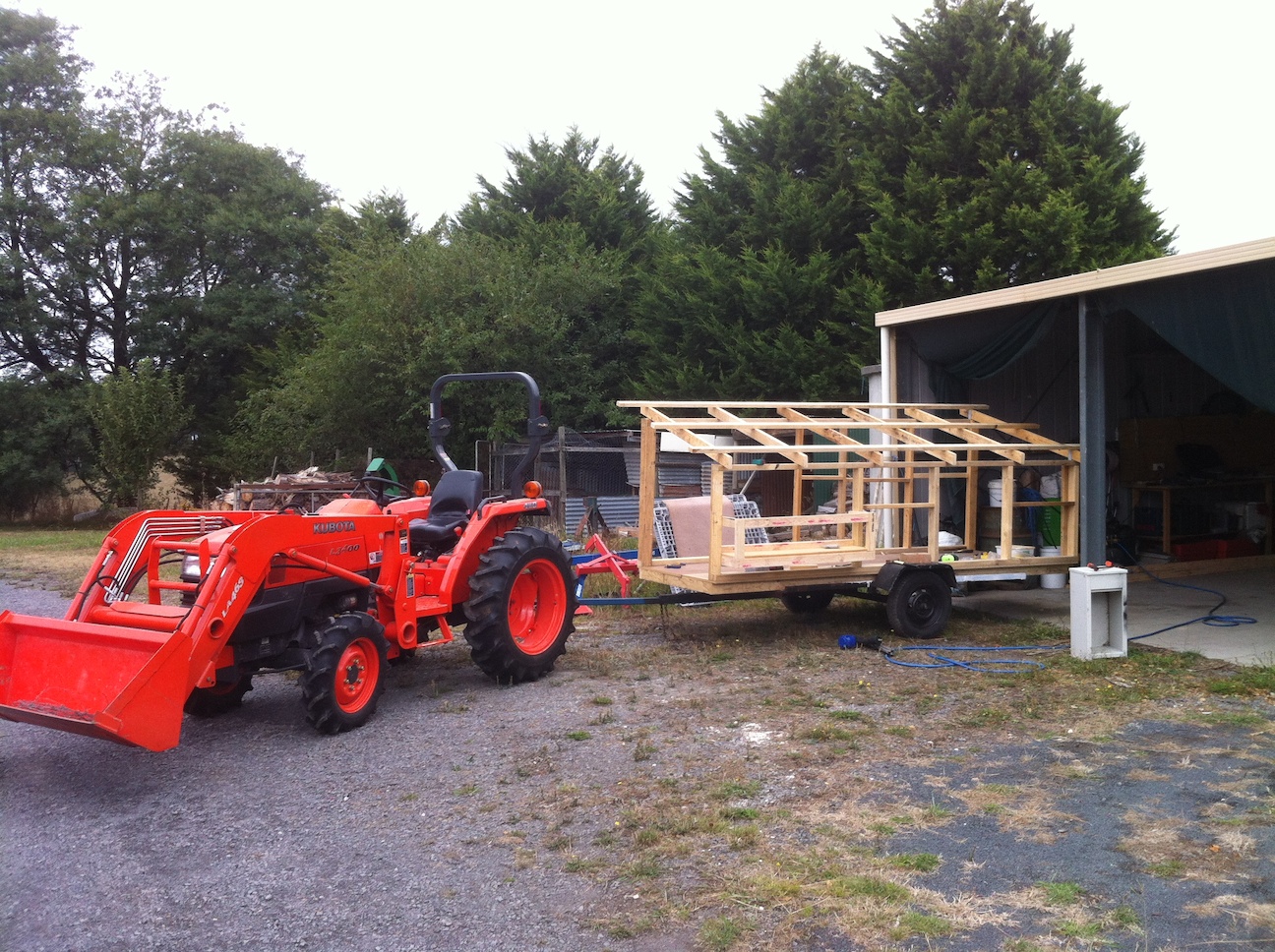

Today I got the framing for the roof and the nest boxes completed.
Tomorrow I'll try and work on the perches.. but it's starting to get too big for the shed!
