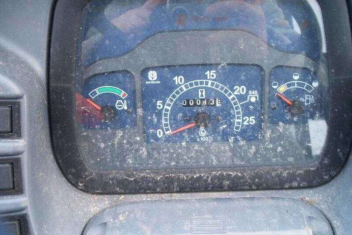

We just got our new TN75 the other day and were a *little* dissapointed. For one, the front fenders weren't on (we later found out they do not fit with ALO loader and custom ones a being fabricated) and secondly the bucket was too small (it was supposed to come with an 8 foot bucket, not a 6). They are supposed to send out a larger bucket tommorow.
That and it was a little late on delivery... no big deal.
BUT.... after reading hard_yakka01's problems with his TN75 and New Holland, I was alittle apprehensive.
Well, lo and behold, today I rolled up to the farm and the tractor was sitting there in the middle of the yard. I was a little puzzled until my father showed up and explained that it didn't want to move and the transmission warning light was flashing.
I fooled with it a bit and looked up the warning light in the manual. Apparently it was the Operator error warning light in regardto wrong control sequence or something.
I fooled with it and figured out the elctronic shuttle would only work if engaged if the clutch was disengaed and then let go. Basically it would only work like a mechanical shuttle (needing the clutch to shuttle). It would not move other wise and would only beep and flash the warning light.
Our dealer was good though and sent out a service guy a little later on in the day.
He instantly knew that it was a problem with the seat sensor and it wasn't sensing that someone was in the seat and therefore gave the operator error warning and would only move when clutched in a certain sequence. He wasn't able to repair and said he would get us one as soon as possible. In the meantime we would have to use the clutch. As he left he looked at the hour gauge and said "Geez, only 13 hours eh?). We've only used it for a few hours, if that, the other ones are jsut from, well, whatever, not sure.
Anyway, not a big deal, but I hope it's not a sign of things to come.
I also was going over the tractor in the shop and noticed on of the bolts hold a horizontal bar on the front grill guard was loose. Not a big deal, but hey. /forums/images/graemlins/wink.gif

A shot of the hour meter. /forums/images/graemlins/wink.gif

I would be concerned about the 13 hours on it.
When I picked up my new Kubota it had 7/10th's of an hour on it. It had 4/10th's when I first looked at it on the dealers lot and they had to drive it to the "make ready" area and back outside, test all operations, etc. so that would account for the extra 3/10th's of an hour. If you look at new tractors they will all have a few 10th's of an hour on them from testing, loading, and unloading, and maybe some demo time.
Did you see this actual tractor when you bought it? If not, I would be in front of the dealer this morning telling him to come get it and bring you a NEW tractor with the correct bucket, fenders, all bolts tight, and everything thoroughly checked out.
The first 50 hours (according to my Operator's Manual) are the most critical. My manual says not to run it at PTO speed for the first 50 hours (NOTE: See my post below, this was an incorrect statement on my part. Post below clarifies break in speeds). With 13 hours you have no idea where that tractor has been or how it may have been used during those 13 hours.
The FEL on mine had fresh grease squeezed out of the joints where they had just greased it during make ready. It was clean white grease, obviously the FEL had not been used. Look for black grease around the fittings to see if the loader was used and any other signs of usage. Could have been rented for a few hours or returned because somebody had problems with it and took it back.
At the very least I would start documenting everything immediately including dates, pictures of anything you find that does not seem right (including the picture of the hour meter).
I would have to have a very good explanation from the dealer why the 13 hours or it would be going back to them.
No fenders, 13 hours, wrong bucket, bad seat switch, all adds up to something that doesn't feel right. One problem would be acceptable, 3 or 4 things not right gets into the unacceptable range. At the very least the dealer should have called you before they delivered it and told you about the bucket and fenders.
I would not wait to see what else might happen before I started in on the dealer. I would not want to get caught in the situation that someone else has had with a TN75.
Follow your "gut" feeling. If it doesn't "feel" right do something about it TODAY.

Personally, I would not be concerned about that. In fact, I'd rather the dealer try it out extensively to see if he can find any problems before delivery.
</font><font color="blue" class="small">( My manual says not to run it at PTO speed for the first 50 hours. )</font>
I've not seen that in a manual before. Mine said not to run it at full throttle, which is admittedly only a couple of hundred RPM above PTO speed, but I think it's best to use the tractor from the start, including PTO speed with some load on it. What I would do is vary the RPM a good bit during break in.

I agree with Bird and Jerry. I think much ado is being made of nothing. 13 hours is nothing. What do you guys think could actually be done to a tractor in the first 13 hours that would materially effect its overall longevitity. My dealer has always said break in your machines like your going to be using them. The TN is an excellent very reliable tractor. These problems are tiny. If I was you I'd worry about real problems /forums/images/graemlins/ooo.gif Just my thoughts

It sure is disappointing that your tractor didn't show up "perfect" at delivery. It is also unfortunate that hard_yakka had problems with his TN & got little resolution from his dealer & New Holland. However, don't let one data point get you down on your machine. Most of the TN owners here have had great luck with their machines.
From your post it appears to me that your dealer leaves a little to be desired.
1. Sold you a loader that isn't compatible with the front fenders. Didn't inform you ahead of time that you'd need
"special" fenders.
2. Delivers with wrong bucket
3. Tech can't field fix a seat switch? While not familiar with the circuit, I'd bet that it is either supposed to be open or closed when you sit on it & he could have either cut a wire, or put a jumper in to keep you running. If he needs a new part, assuming it is in stock somewhere, they should be able to get it in 24 hours.
All of your issues are "minor" and can easily be solved, but its sure not the first impression I'd want to leave with my customer. I'd call the salesman/owner of the dealership and express your disappointment. Get a commitment for rapid solution to your issues.
As others have mentioned, a couple hours on the meter and a loose bolt are normal. It's a good idea to do a routine check for loose nuts and bolts.
