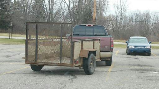

Probably not a new thread, but I saw this at the local mall today and could barely keep from laughing at how bad it looked.

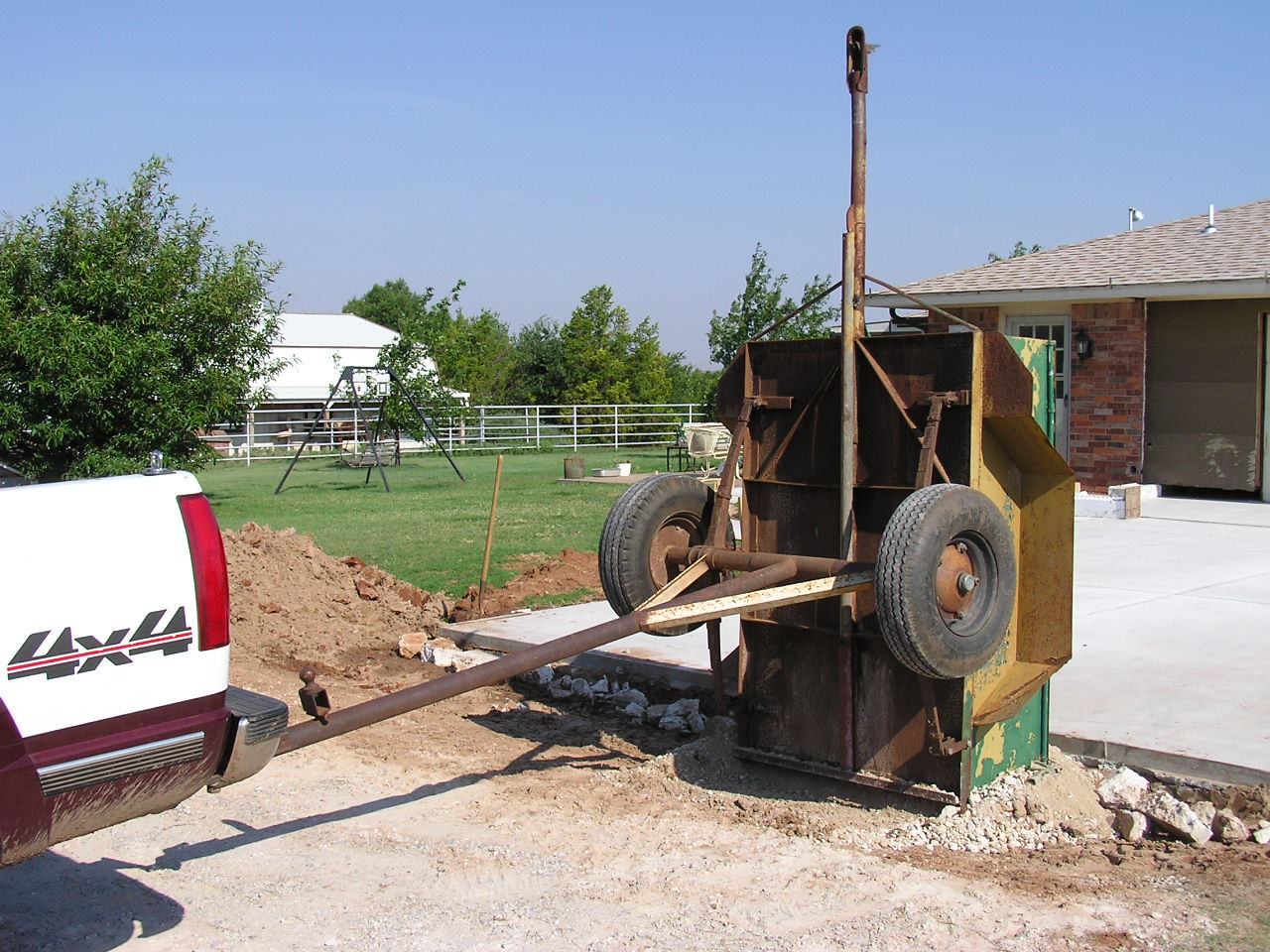

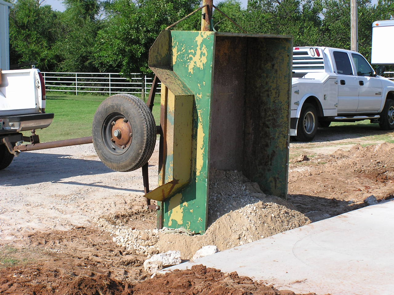

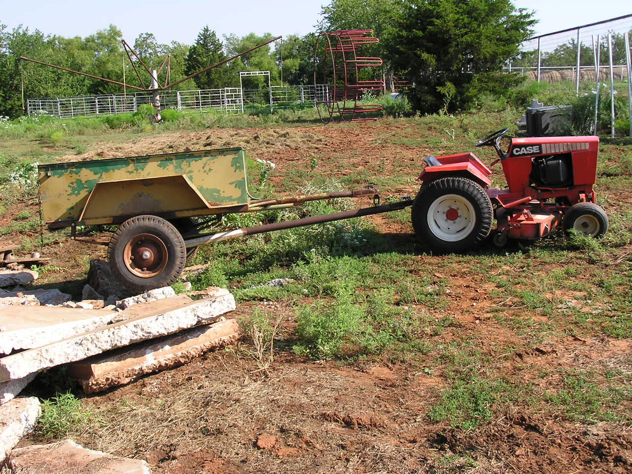

Here is my ugly all metal 4x6 dump trailer. About 20 years ago I removed the drop axle and cut down a mobile home axle to the right width. I slid three pieces of tubing over the axle before I welded it back together. then I welded the new longer tongue onto the tubing, with a pivoting ball for the original tongue.
To dump, just unlatch the original coupler and raise the tongue.
Back up a little for a 90 degree dump angle.
With it hooked to the higher hitch on my tractor, I could get a 180 degree dump angle, completely upside down! :eek:

That may be ugly, but an ingenious design!

I agree, may be ugly BUT it's beautifully designed for the uses it serves. Can we call it "Fugly" (functional ugly)...?
