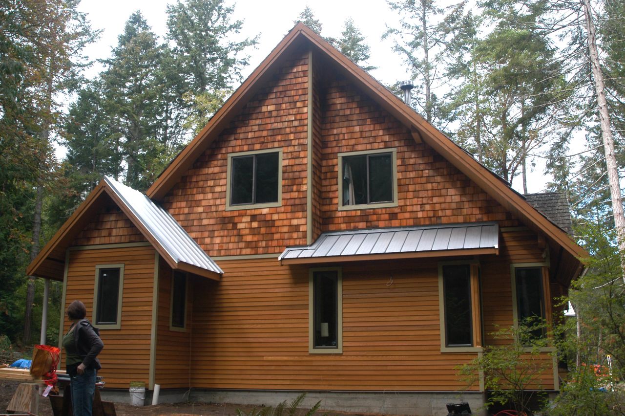

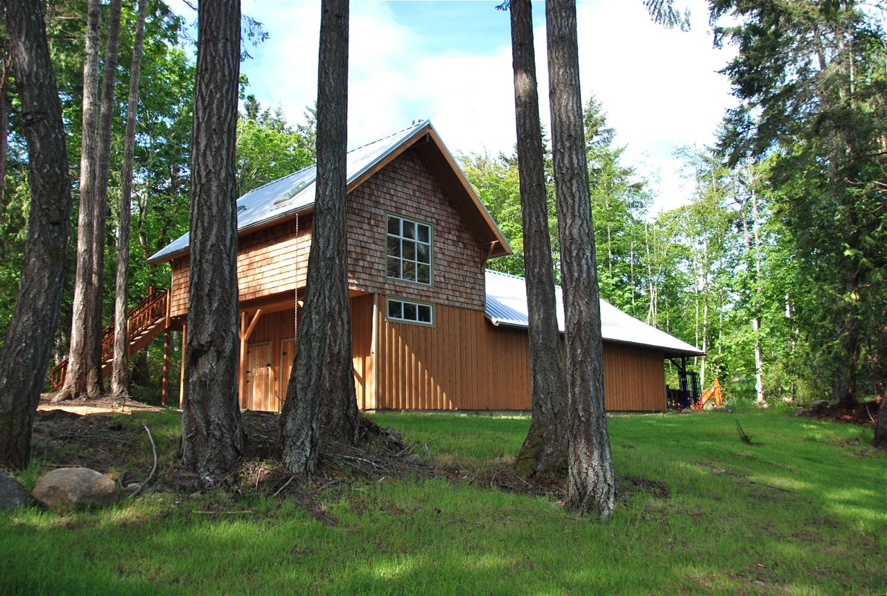

I found good results using General Paints semi transparent stain, color - cedar. Both my barn/office and house are treated with it. The timber was delivered pre-treated (two coats). The barn has been up since 2006 and the house since 2007. I haven't retreated either yet so service life seems good for this product.
