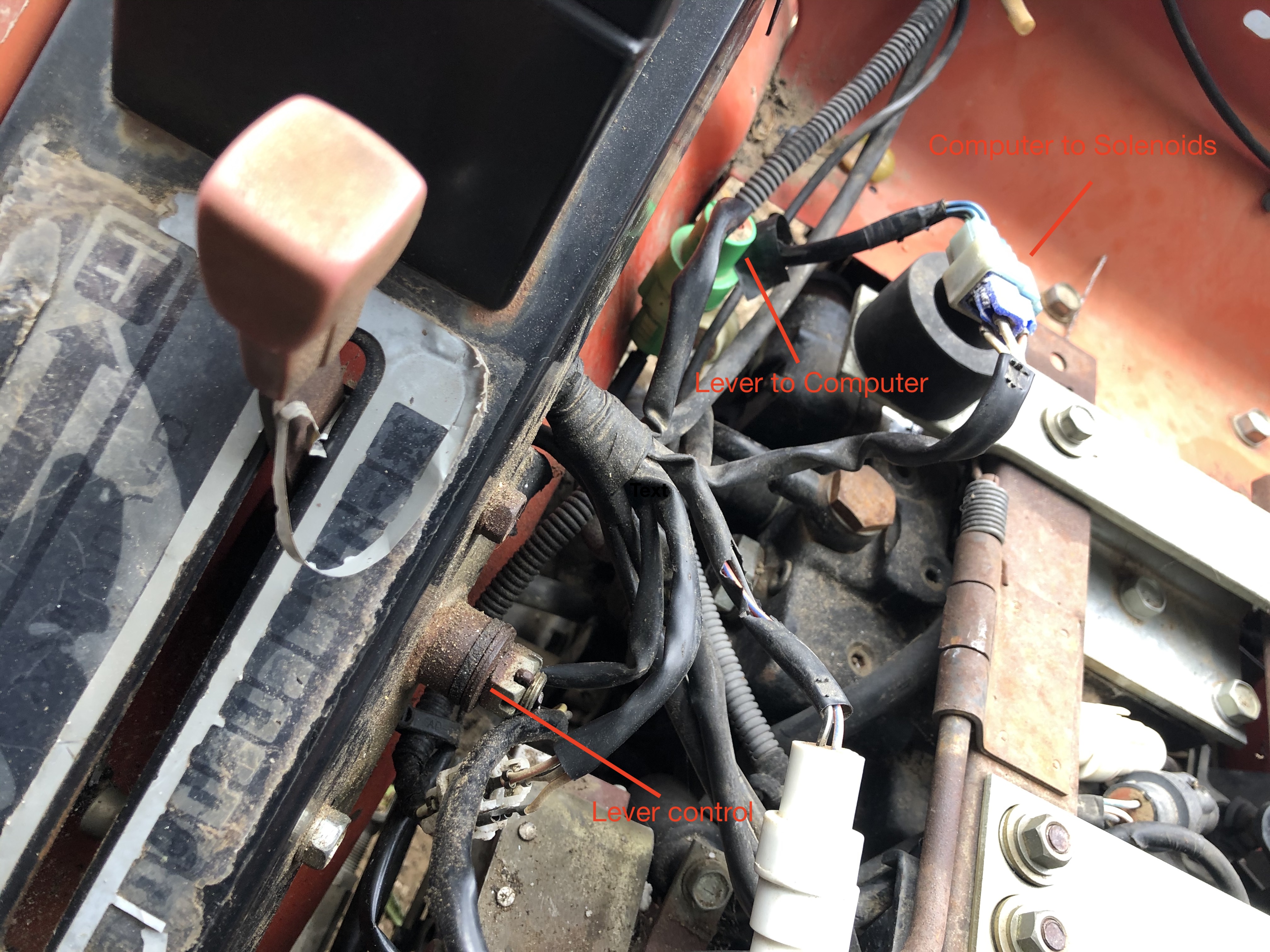

Has anyone ever come up with a solution for this issue? I have a Fx165D with no mechanical linkage to the 3pt lift. The up/down lever is connect to 2 solenoids as sketched out in the PDF attached above.
Is there a way to bypass all the computer controls and just send a simple up/down signal?

To clarify my problem:
The control of the 3pt up/down will work fine for a while. Then all of a sudden it will get stuck in a down position and will not lift. If I manually push the solenoids on the 3pt it will lift/lower no problem so I assume my problem is electrical. I do not own the implements with sensors. Just want to switch everything to manual so that I can operate as needed.View attachment tractor controls.pdf IMG_0799.jpg

Go with whatever fix tractorernie provides. He knows them. I have never work on or with an F model.
Only suggestion I have is check your grounds. Intermittent troubles can often be traced to a poor ground.
   / UFO joystick wiring F235 #7
Like CoyPatton said, most of the time its a bad ground or a bad connection.
If the controls get wet or greasy they might work after they dry out.
I once unplugged each plastic connection and sprayed them with electrical contact cleaner, then I plugged them all back in and presto they worked. (unplug one at a time)
Be sure to check ALL the wires for a good ground, and spray both buttons on the solenoid with a good lubricant while you push them in and out by hand, they get gritty sometimes and stick.
I have totally rewired quite a few of these in the past with American toggle switches in order to make them work. (mostly shibauras) I used double throw momentary switches.
Without being in front of the machine its kinda hard to diagnose the problem... But a good cleaning might be your answer.
