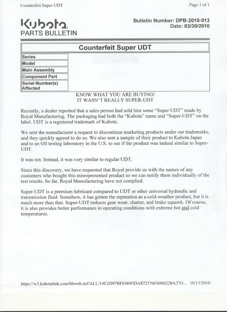

Seems like you are still concerned, so here is the "Rest of the Story".
The truth is that Kubota never has been very knowledgeable or forthright about their UDT types of Oil.
The early UDT and Super-UDT - which later became SUDT - were well known for making HST transmission noisy. I know my Kubota dealer used other products when he did warranty service just to stop the complaints. In fact , he used Ambra Multi-G from the New Holland dealer. Much quieter oil.
The Super-UDT alsohad other problems. The company that Kubota used to make it for them was giving them a false down level product. I accidently bought some at the dealer and then a few days later this notice came in the mail. I asked the dealer to take back the counterfeit Super-UDT & refund my money for my unopened containers, but he refused....I was amazed that he refused.
I told him he was being short sighted, and that I would never miss a chance to let others know the truth about the Kubota trans/hydraulic oils.
The bottom line is that UDT2 is pretty good oil. For the earlier UDT and S-UDT why bother? All you will get is oil that whines in the HST. Those are Cheapie Oils, and you don't even know who made then. Kubota doesn't even know, so how can they tell you if they mix? Do you think they dumped all the bad oil? Or did they continue to sell it and also continue to use the same unreliable supplier?
There are other major refineries that make trans/hydraulic oils as good or better. Shell, Mobil, Ambra Multi G, JD HyGard, All the major oil companies have their own versions of decent trans/hydaulic oils. I would stay with the major brands.
