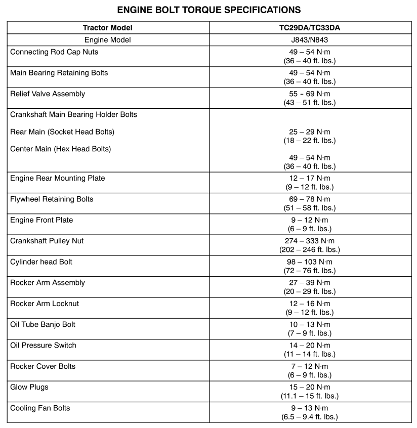

Hi, my valve cover gasket is leaking on my 2006 TZ25da. I ordered a new gasket but I’m unsure how much to tighten everything when the new one goes on. Does anyone know the torque spec? I’m not a seasoned mechanic but I believe I can handle this repair. Thank You.
   / TZ25da valve cover torque specs #2
It is 6-9 ft-lb on my 2004 TC29da. Not the same engine, but but the spec would likely be close.
