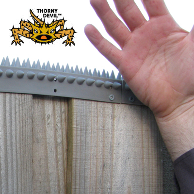

We run 5 strand wire with two white sight wires at the top and a stand off arm that carries plain wire that is connected to the 'charger'.
We also have short plastic spikes on timber rails to discourage the crib biters.
