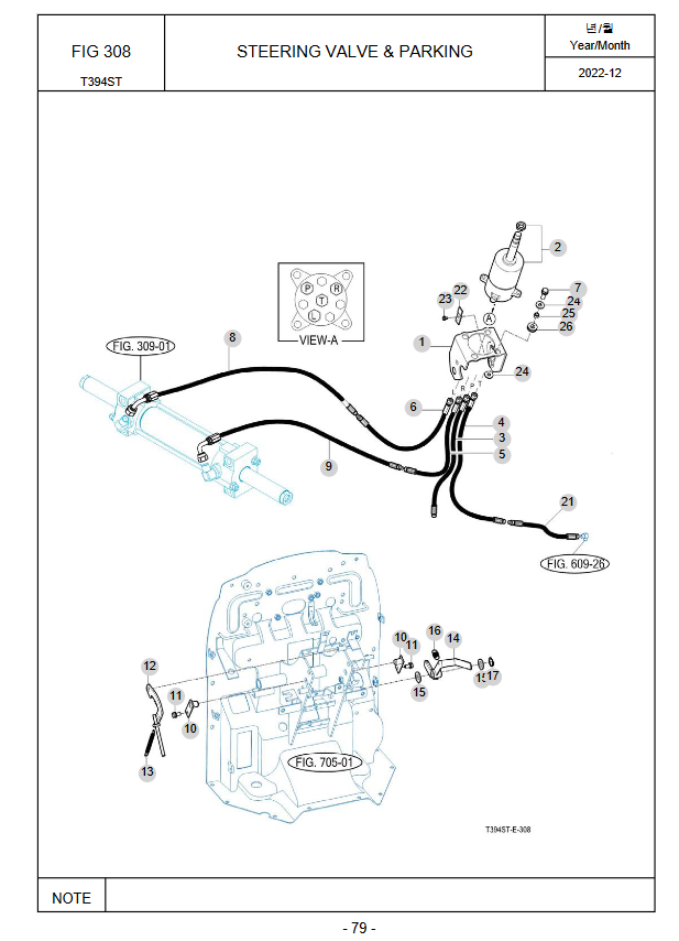

Does anyone know the part # for left front power steering hose for 2024 TYM T394 shuttle shift tractor? It was damaged at factory assembly.

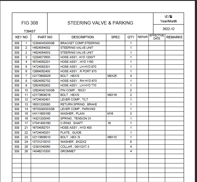

Download the parts catalog from the TYM website. They should have it in there.

I have and it is not listed clearly. Just shows a bunch of hoses and does not show the hose I need as a stand alone.

Keep in mind that even dealers will have just the hose made. It's often a lot cheaper than any OEM part. Just searched by the part number of the hose #9, which brought up one for Mahindra (TYM made tractors for them) and it's like $80+ which is very expensive for a simple hose.

What Item # do you think it is on the list of items. I can't definitively tell which one it is. Which item do you think it is?

If you're looking for the hose that goes to the left port on the cylinder (that's what I understood from the first post), then it's the #9 in the diagram.

No, that is not the one. I am looking for the one that goes to the left side front tire area as viewed from the driver's seat. At assembly they got the hose between the axle and the frame, and the flexing motion of this area wore a hole thru the hose.

It's either #9 or #5, but the #5 doesn't get close to any pinch area from the front axle. I can only see the #9 being the issue. The #9 connects to the #5 that is then connected to the steering valve.
#9 hose, even though it's on the left side of the tractor, it the one that makes it steer right.
