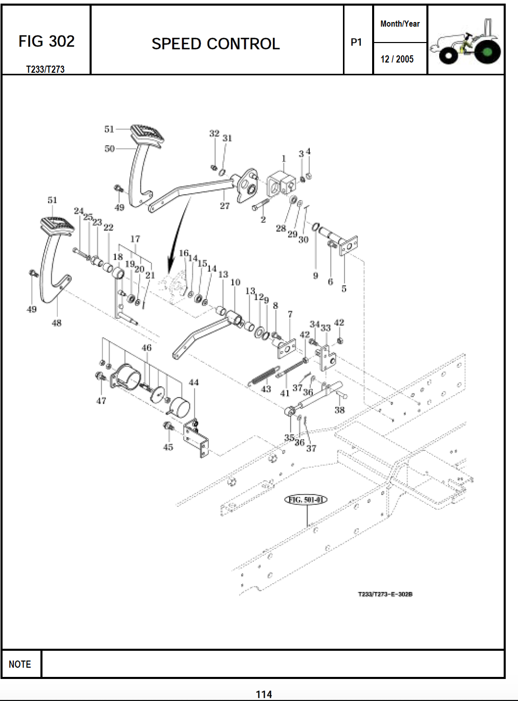

I have a TYM T273 with 700 hours on it. Everything worked fine until I changed the hydro oil.
I changed the oil and filter (WIX) and forgot to clean the screen. I used it to cut the grass but noticed that in high it would whine and have pedal resistance. So, I cut the grass in low. So, I tried H again and it had a lot of noise and pedal resistance. Would hardly move.
I thought it could be a clogged screen so I drained the oil again and pulled the screen out and it had some red fuzzy stuff on it. Not much and no metal. Cleaned it and replaced the screen. New Mobil hydraulic tractor fluid for hydrostatic tractors. (first time used TS Premium hydraulic fluid).
Only very slight movement in L and virtually none in H. Noise and resistance and I notice when I push hard on the pedal and let off there is like a sudden pressure release as though it is blocked somehow.
Reverse works perfect! H or L. No noise at all.
Any ideas? I have ordered the TYM filter thinking that somehow on the change the WIX might be too fine of a filter and it's blocked. But reverse is fine.

Have you looked at the pedal linkage underneath the tractor. Make sure nothing is binding or come loose. I do remember getting a stick or piece of wood wedged in there one time that gave problems. It limited pedal travel. I believe its on the forward pedal linkage, there is a shock absorber dampener that could be a possibility. Would have to look at the parts manual on the two pump question but wouldn't think that would be practical. I would start with the pedals and work in to something internal.

I checked the linkage. Looks good. The pedal just going down without any action was because the bolt was not tight enough on the shaft which controlled the valve going from forward to reverse. Still no movement forward. I drained the hydrostatic trans fluid, put in the new screen and there was what looked like small red flakes in the oil about the size of a grain of sand. On further examination this material is easily smushed with my fingers. Perhaps paint from something?

"The pedal just going down without any action was because the bolt was not tight enough on the shaft which controlled the valve going from forward to reverse. Still no movement forward."
I'm a little confused by this. So, was the pedal not connected, but now it is? I ran over a log a few weeks back and it bent part of the linkage assembly pretty badly. I was able to push the left pedal and go forward, but the right pedal was was physically restricted due to a bent part underneath. Once I straightened things out both pedals worked fine. FWIW, the part that I bent was the shaft that attaches to the odd shaped roller on part 27 in attached diagram. I don't remember the details, but one pedal has to "ride" over the other pedal with a bearing. If anything gets out of alignment or is damaged the two pedals can't move up/down relative to each other and in my case this prevented me from going backwards. There isn't a good diagram out there showing how the two pedals interact, so it took me a bit to figure out what was bend and out of alignment. Hope it's this simple in your case. . .

I raised the tractor up. Removed the rear wheels. Checked the linkage thoroughly. There is a shaft that comes out of the hydrostatic transmission which a flange attaches to. There is a pinch bolt and it was loose. I tightened it up. Absolutely no resistance when rotating forward. In reverse, there is resistance and the tractor moves in reverse in H or L. I finally contacted the TYM dealer near me. He has very good reviews. He is checking it over but the hydrostatic transmission is not serviceable as far as disassembling it and repairing. It is a $3,000 part and if bad it needs to be replaced. Not good. Not much else I can do at this point. Thanks for your help! I will post results.
