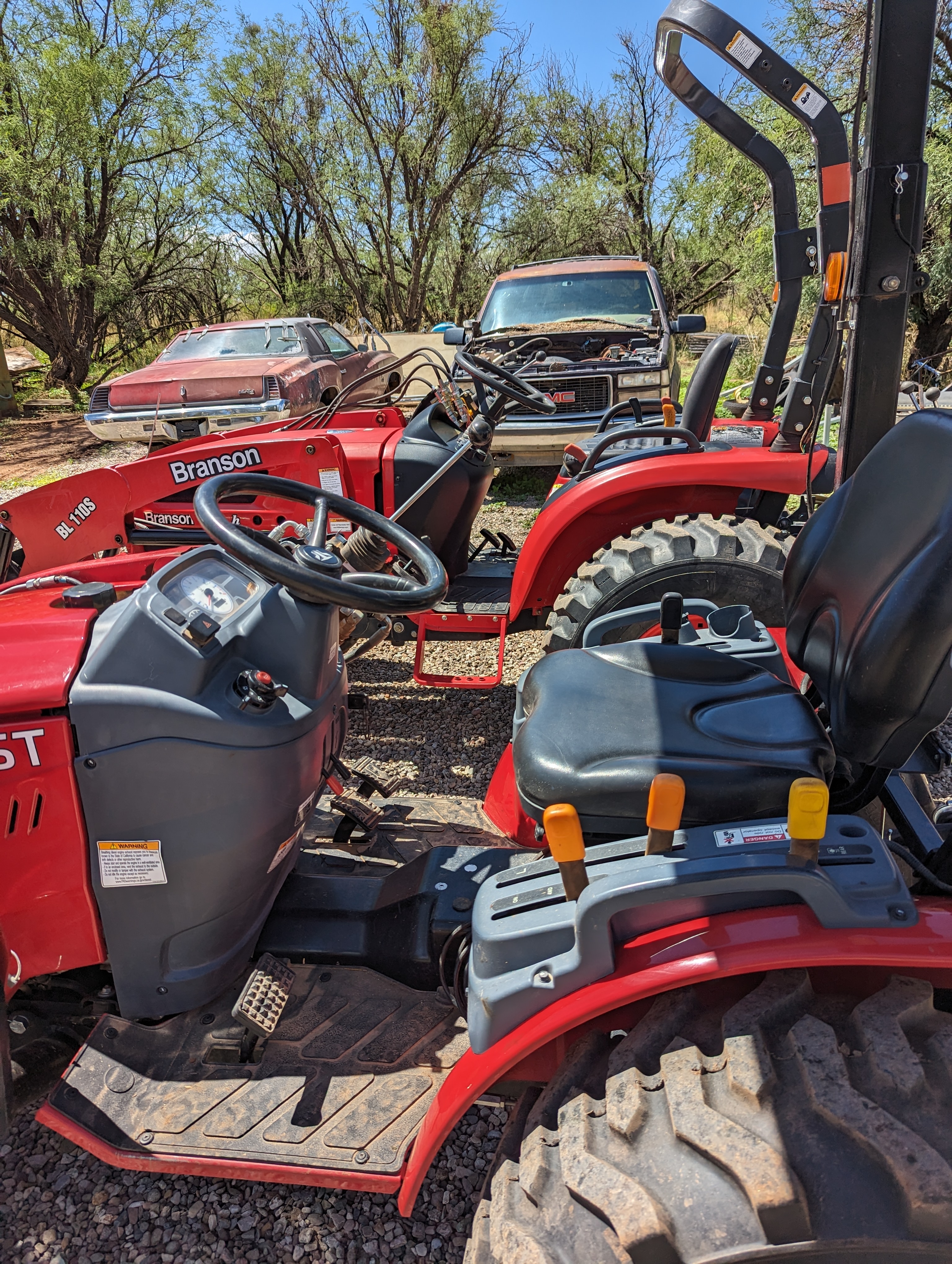

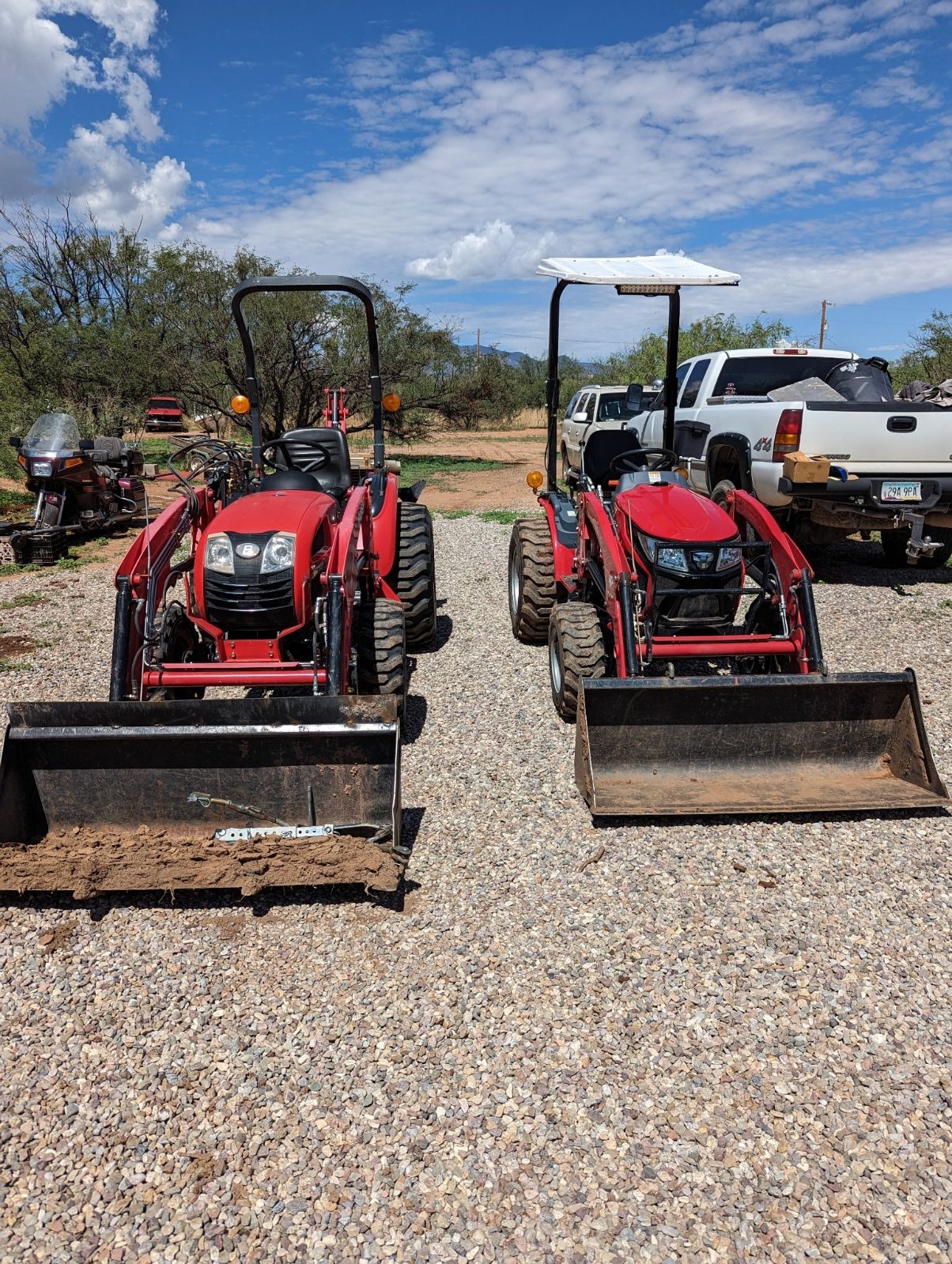

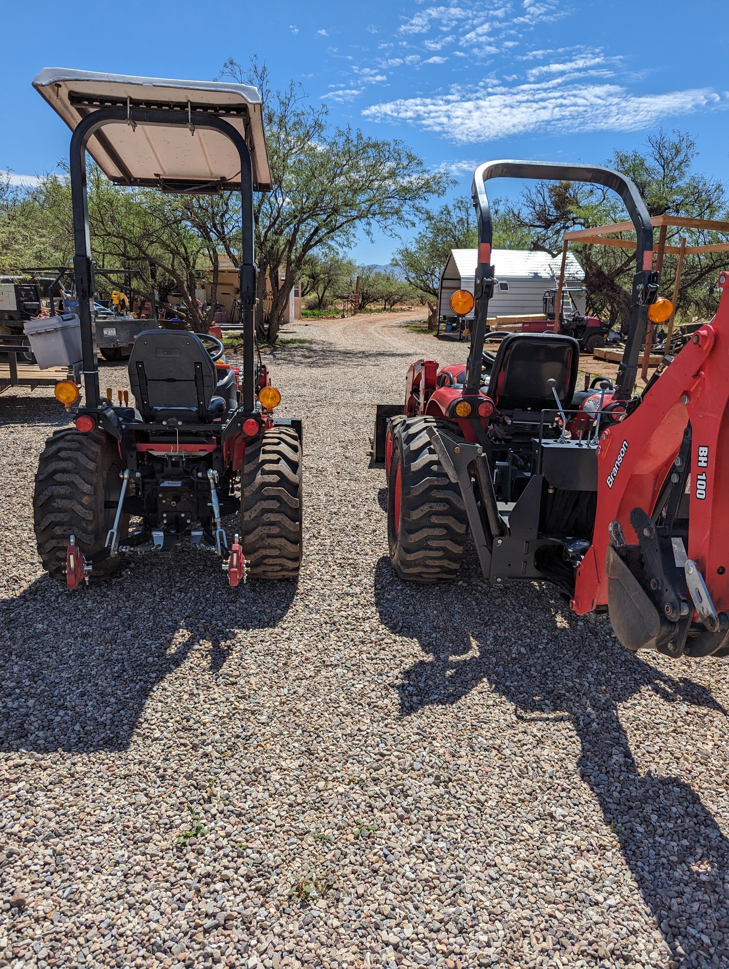

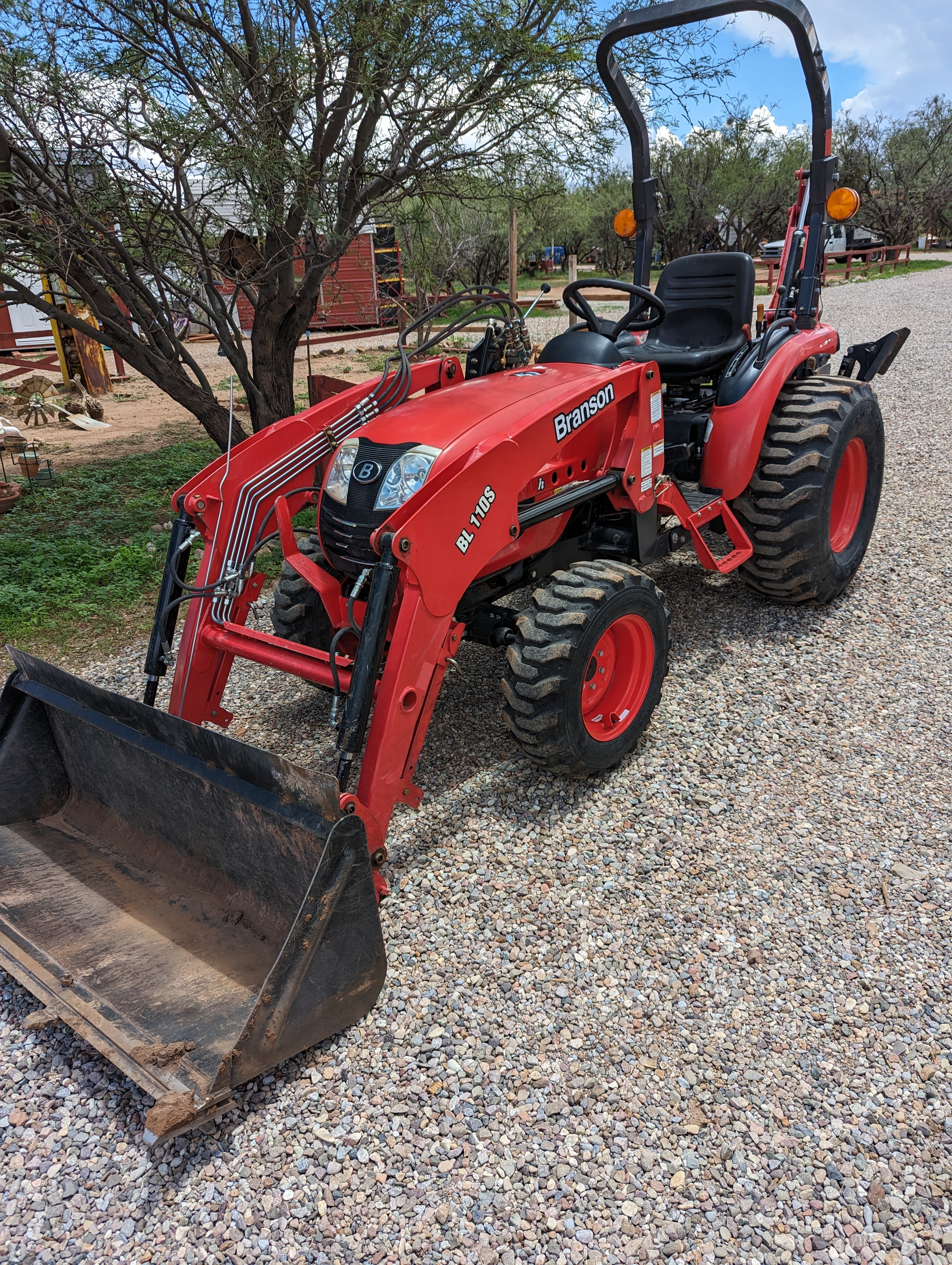

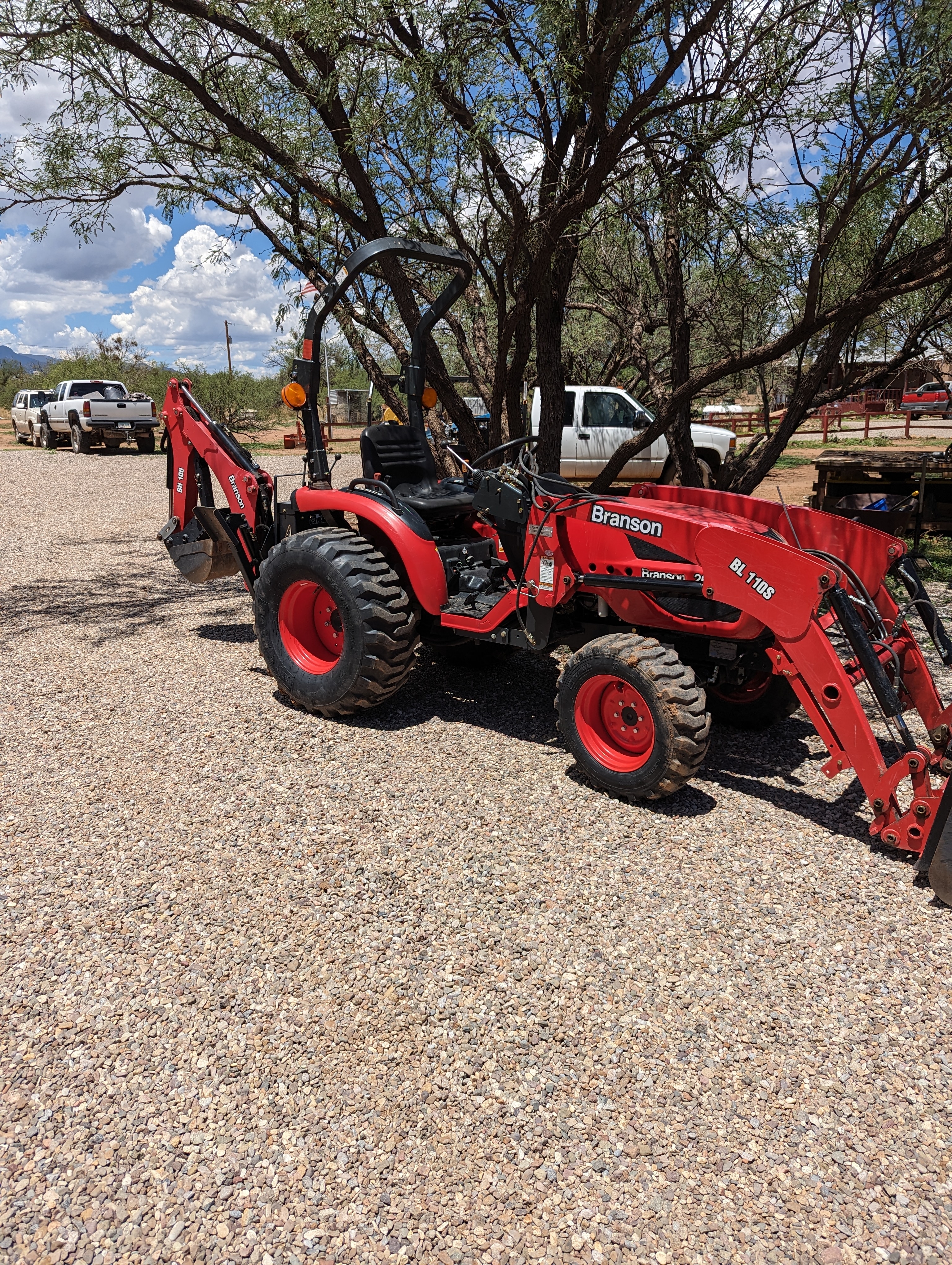

When we bought our TYM T254 new 3 years ago I could not fine much info online about that model. So I am posting some side by side pictures of our new to us Branson/TYM 2610h and our T254. We are very happy with the T254 and it has completed every task we asked of it. The T254 will lift 1200lbs on the front loader and we tested that with a crane scale. However I wanted something just a little bigger for my 250lbs but.
So we went shopping and tried out the TYM T25 and T 264 while they were only slightly bigger , like the T254 on bigger tires , but still a little cramped for me. Tried out a Kioti 2620 and but felt like it was a little big for our property with lots of trees to weave in and out of.
So we ended up with a Branson/TYM 2610h and it is the perfect size for us. Its weighs about 800lbs more than the T254 and digs dirt a lot better. I will say the T254 is very smooth and powerful with the Yanmar engine. The Kukje engine is quieter but does not seems as powerful as the Yanmar . The real plus is extra weight , length and width of the 2610h. I am posting some pictures below.

The more I use the 2610 the more I like it. I have done extensive research about the model. The TYM 2610, Bad Boy 3026 and Branson 2610 are all the same tractor made by Kukje.
Yes it has a 3 range trans. I love the loader lift height 93 inch. The T254 only lifts to 75 inch.
