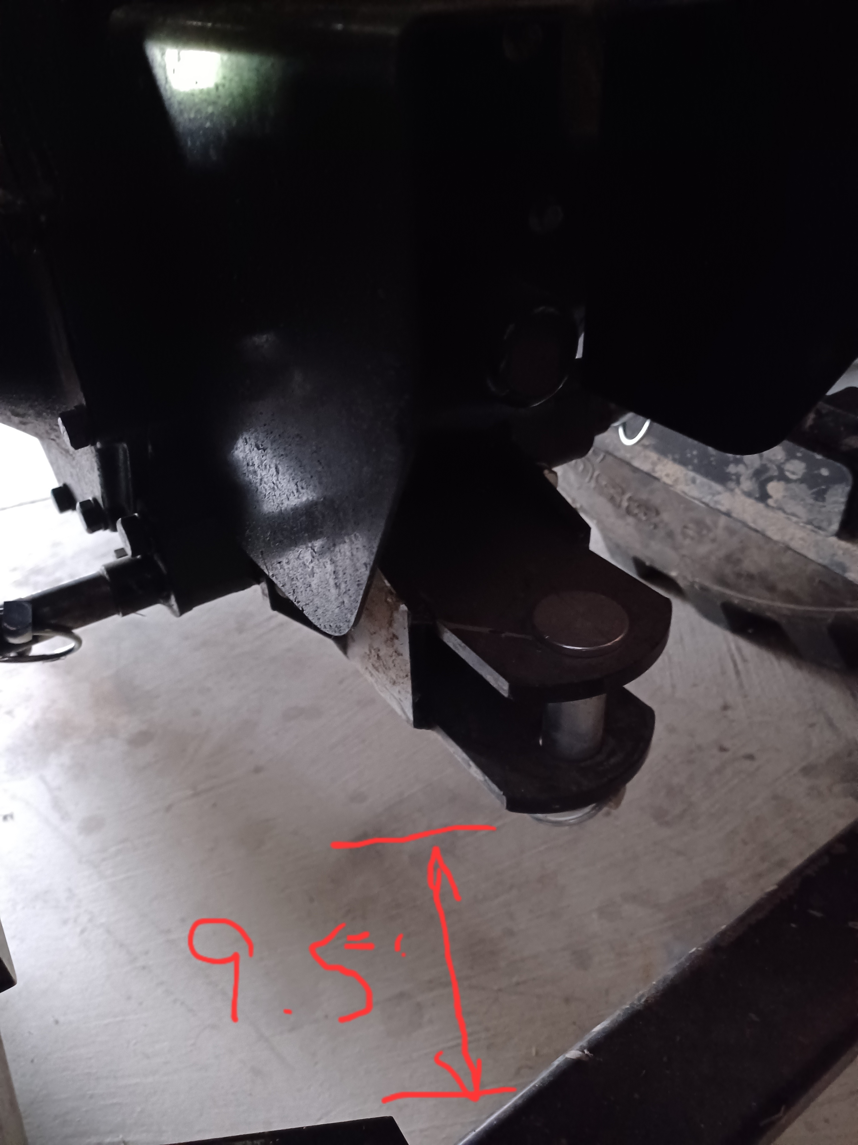

The lowest point of my T25 is the rear hitch, which is 9½". The subframe for my backhoe comes in at the same 9½".
