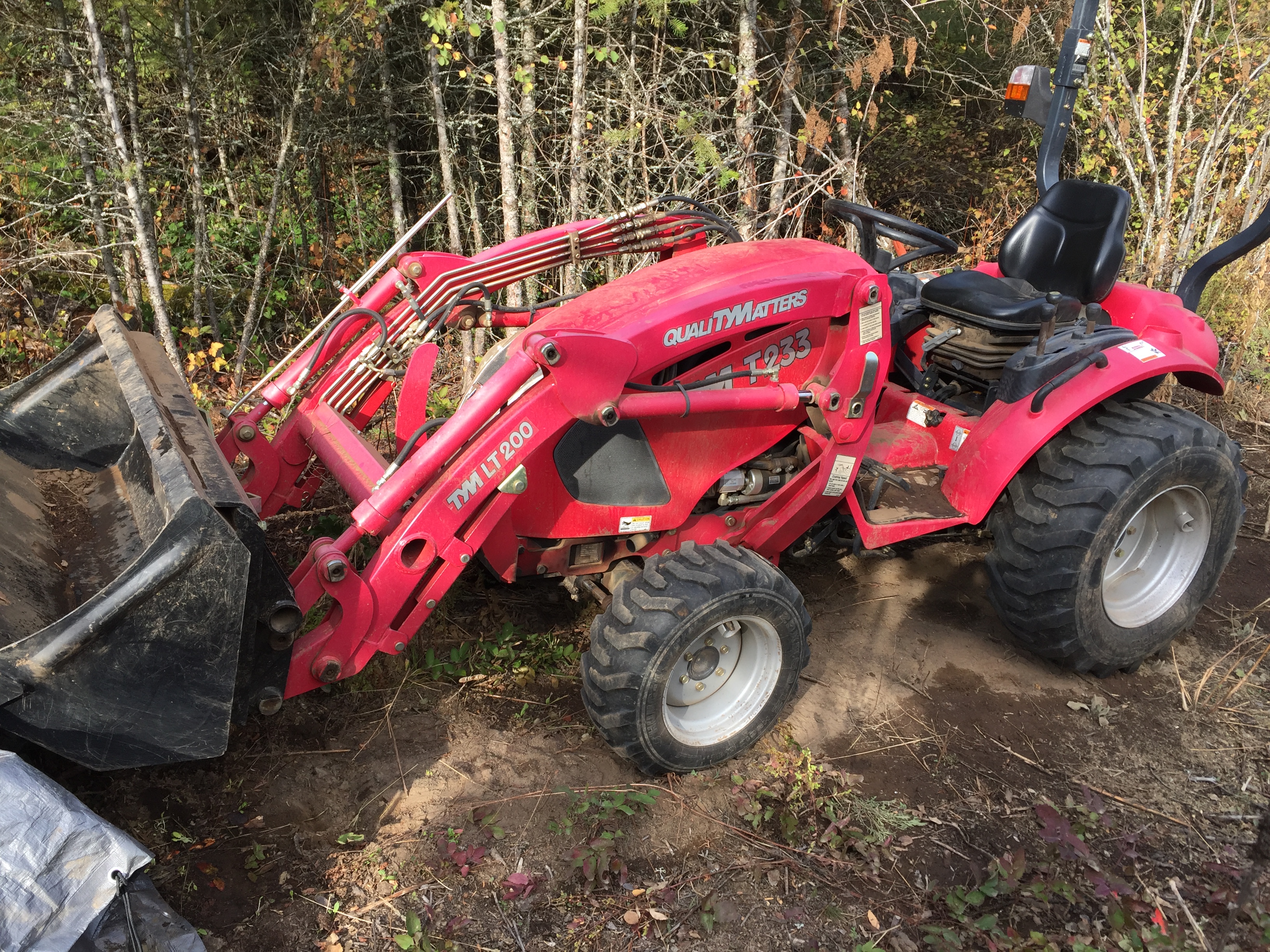

I purchased a used TYM T233 in an estate sale, never having owned a tractor before. I set about using it on 6.5 acres of woodland which I also recently purchased.
After running the tractor for 20-30 mins the temp gauge climbs nearing the red zone. I try all I can to cool down the engine without success. The next time out I top off the radiator by the story repeats itself.

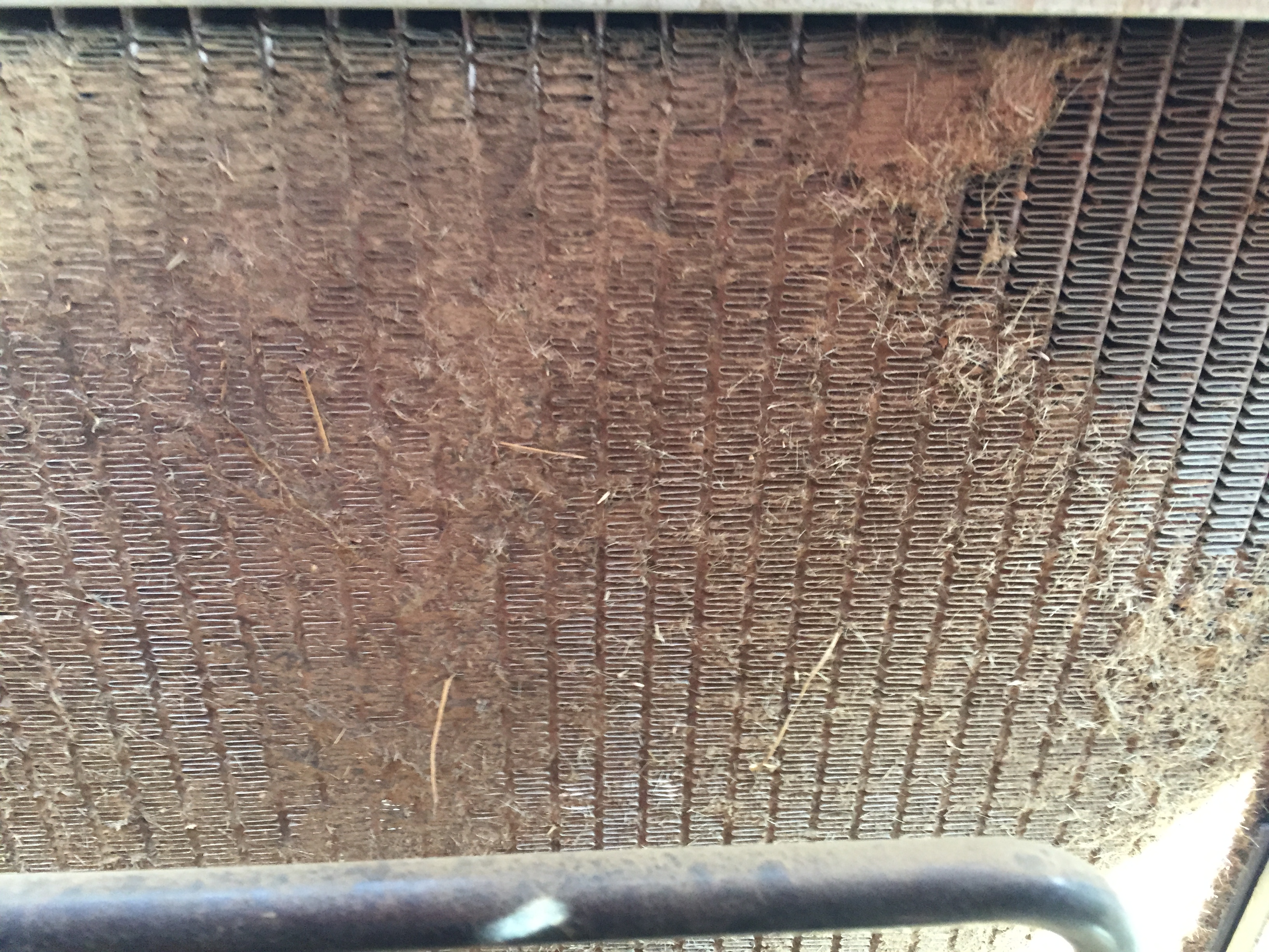

So I head to my dealer thinking the worst. The service manager, with great patience, shows me several things to check, using a new unit as reference. One of the items he suggests is that the radiator fins may be clogged with dirt/mud/debris. Thankful for his suggestions, though somewhat skeptical, I head back to my tractor.

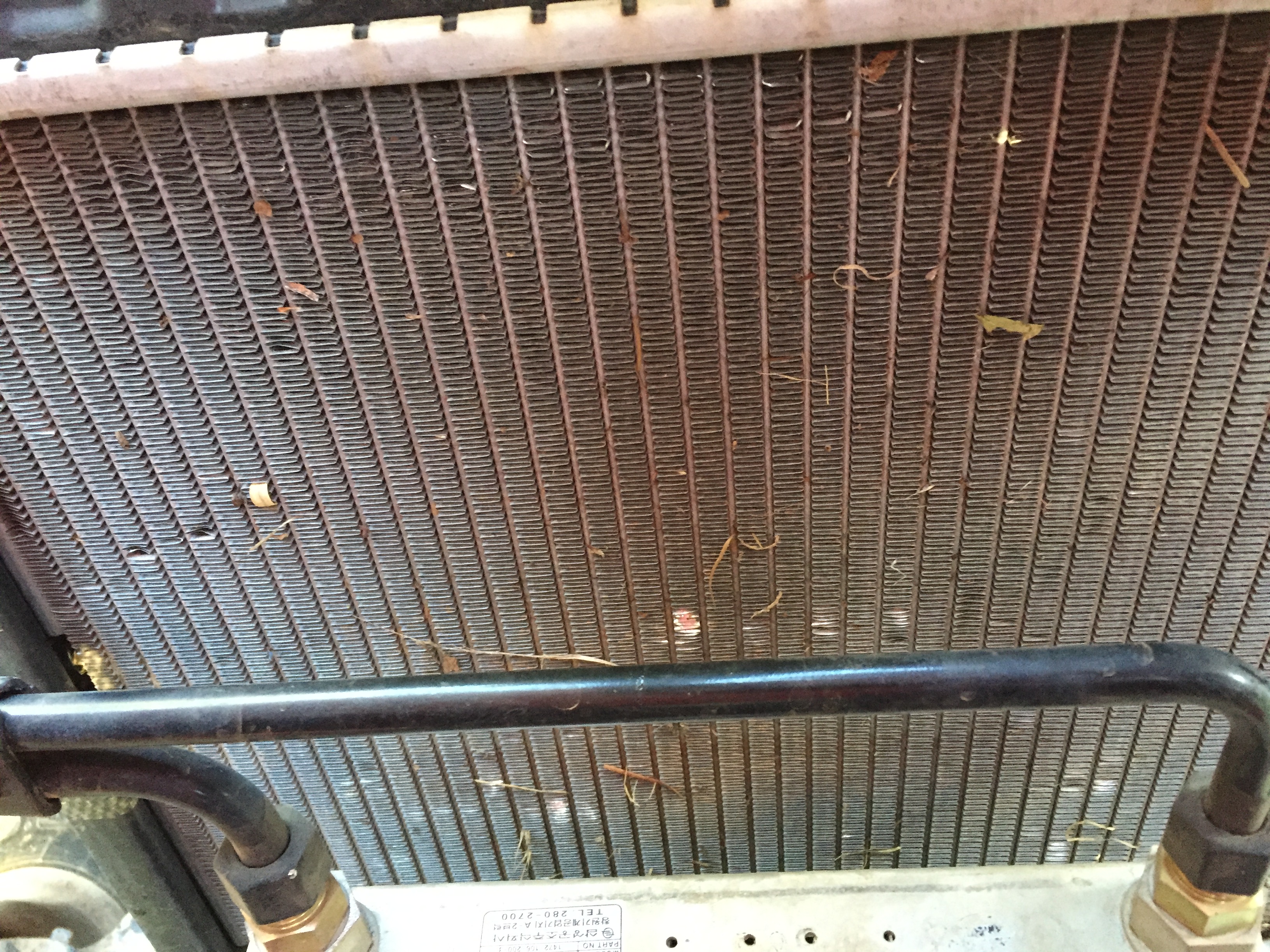

Shocked I find exactly the condition the service manager described. See photo. A simple hosing out of the radiator cleared all of the dirt.
Now the tractor runs great for hours with the temp gauge at mid-point!

It's fairly common for the screens on tractors to get some chaff in the radiator especially when doing field mowing in tall weeds.
If you don't have one already it's worth investing in a good blow nozzle for your compressor. I bought a cheap one and then fabricated a piece of copper tubing on the end of it so I could put a 90 deg bend so I could blow out the core of the radiator.

Yes, there is a screen in front of the radiator. I removed it for the pictures. The dirt and debris that was lodged in the radiator was smaller than the screen catches.
