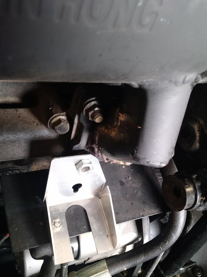

I've a Cabelas branded TYM SCUT, T254HST, (LM25 Cabelas model).
Since owning the little 3 cylinder, I have had a rattle, flapping noise. Mainly at low speed and idle (but might be only because I couldn't hear it over engine hydraulic whine).
I finally figured what was causing it. The little 4x8" heat shield between muffler and the starter. It is only held on from firewall side and can vertically flap.
When I repaired the muffler bracket, I added an angle of aluminum that I had laying around. Ended the noise. Yes transfers some heat, but it won't break off now.
and it reinforces the muffler too.

Steel too! Been on there about 15hours and hasnt loosen yet. And if it does, I'll make another.
   / TYM Noise elimination #4
At least you were able to find the cause. :thumbsup: It looks like it's an easy spot to get to in case Cincy is correct and the bracket doesn't hold up.
