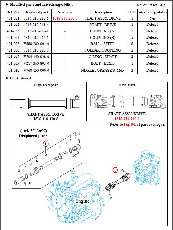

good morning,
has tym fixed the drive shaft issues? this will affect my decision on a 25-30 hp machine...........
would like to hear from a dealer.........
just asking..........

   / tym drive shafts? #2
Well now, "Where are you TYM Tractors??" This is an important question being asked by a prospective future buyer; and, I might add, one that almost all current TYM owners would like to hear replied to by a representative of TYM corporation. An answer, negative or positive, will be respected by all in the family I am sure. Thank you, Greg

   / tym drive shafts? #6
Good Morning!
The issues with the 20-30 horsepower drive shafts was resolved in late 2009 via service bulletin. The old drive shafts were completely replaced by a new part entirely. Refer to the image attached for part #'s affected.
I apologize for the late response on our behalf, however, we do operate on a 5 day work-week alongside everyone else. Posts late in the week, depending on the week, may not receive a response until the following week. (At least on subsidiary sites such as tractorbynet, in which we are not directly affiliated.) Please remain patient and a representative will be with you as soon as possible.
   / tym drive shafts? #7
Thank you very much for the straight forward reply TYM Tractors! I believe that should finally resolve any lingering questions "anyone" might have per the drive shaft being a weak link. I thought this had been resolved in 2009, but didn't have absolute proof; now we all do and this issue can go to sleep!
