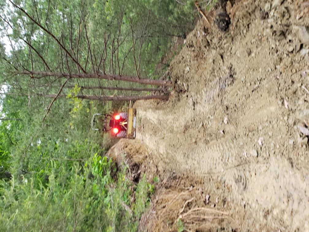

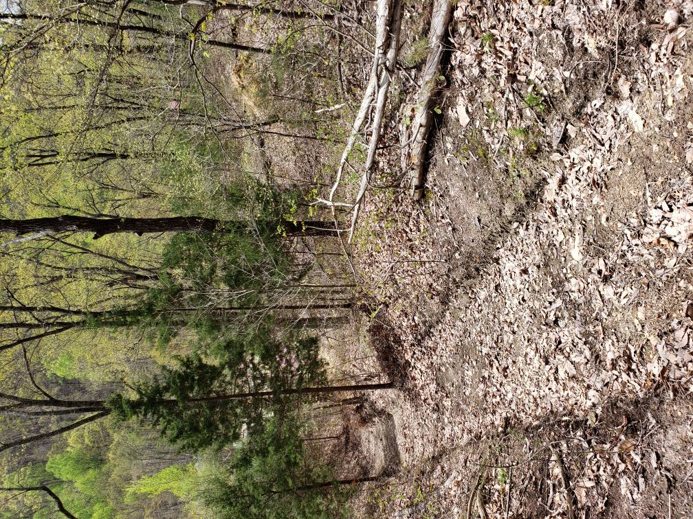

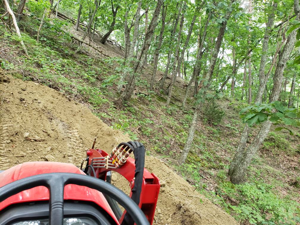

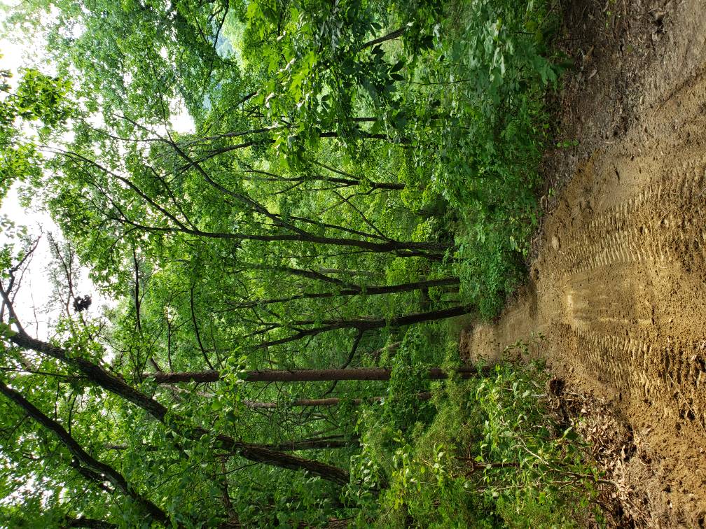

Look at my post..."hold my beer". My property averages over 45° and I am managing.
Shouldn't have to say....but never go sideways....always straight up and down.
I've done a lot with my T234. Mitsubishi diesel in mine. I paid $14,200. 20190615_175324.jpeg20190615_190656.jpeg20190510_200202.jpeg20190413_145233.jpeg

I've been looking at your post and your trails look good, lots of work. Do you find you have enough power? I'm just worried about getting up the hill in my back yard in the loose dirt. 4 wheeler has lots of wheel spin and power if needed. How are you cutting the hills? With the bucket or with the box blade?
   / TYM 264 #7
I've just recently started running at close to 2500 rpms since getting into heavy shale. I've cut most around 2000 rpm. The only time I didn't have enough power to climb a steep slope was when I accidentally hit my third remote valve open with my leg. Once I shut it off I climbed directly out.
I moved a rock that my loader arms could hardly bare, chained under my bucket and climbed 200ft up 30° slope half of that I had my parking brake on. (I thought it was just the weight of the rock slowing me down....I kicked myself good for that)
You will have 3 more hp but a kunje diesel....I cant speak for that brand. For travel, you will have more than enough power at the wheels. For lifting, it will lift the rear end with ballast filled tires and box blade if the load is too heavy at the bucket.
The bxpanded piranha bar really changed my trail digging, making it much easier. Mind you, I am digging up.....ideally you would want to dig down when possible. I rough cut with the loader and back drag the piles 1.5x the tractor length from where I'm digging. I then climb over, past my pile and drop the box to dozer the dirt down to a bigger pile. Pushing the bigger pile down hill is easy. Sometimes I'll back into the trail and level things out setting the rippers or blade angle as needed.
