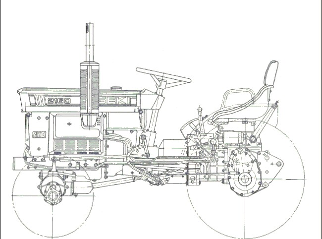

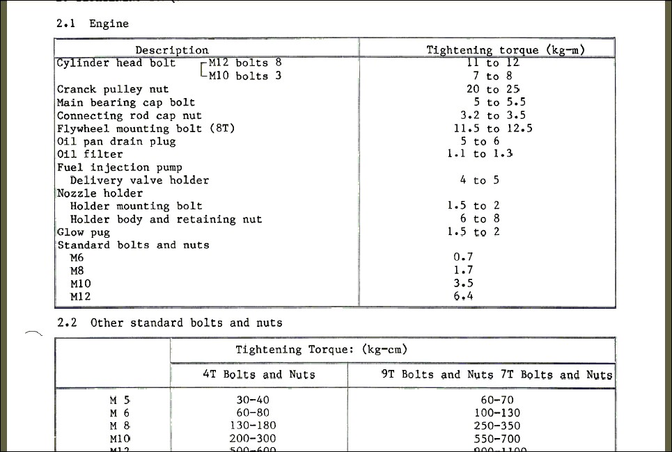

All, I have a TX2160, I have stripped the engine and are in the process seeing what parts I require, I need a set of injector pipes for a start as the nuts have corroded badly to the point they are nearly missing on the pump side, I would like to find the torque setting for the conrods, I have managed to obtain a manual but its for the K3C engine and mine is a K3B, are the torque settings the same?

Picture of the tractor, the loader and back hoe are frozen with lying,
Untitled by chrismac2012, on Flickr

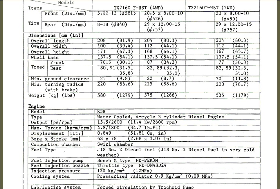

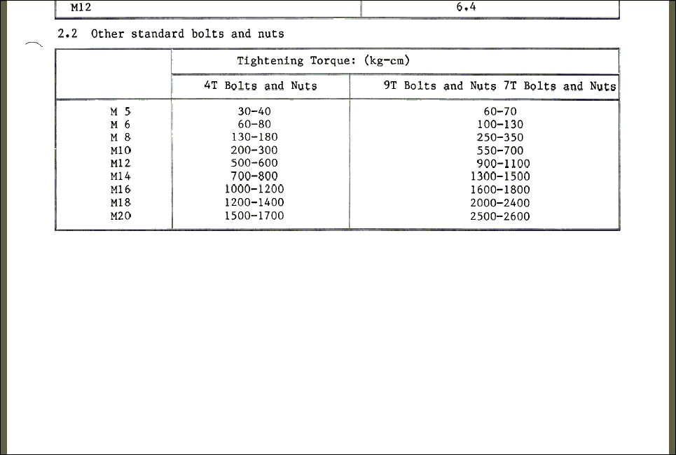

Hello, I have a manual for that tractor with the K3B engine.
Here are a few shots I took of that manual including the torque
settings for the K3B. If you want a copy of this manual
shoot me a PM and I will e-mail it to you. Also I have
the parts manual for the TX2160
