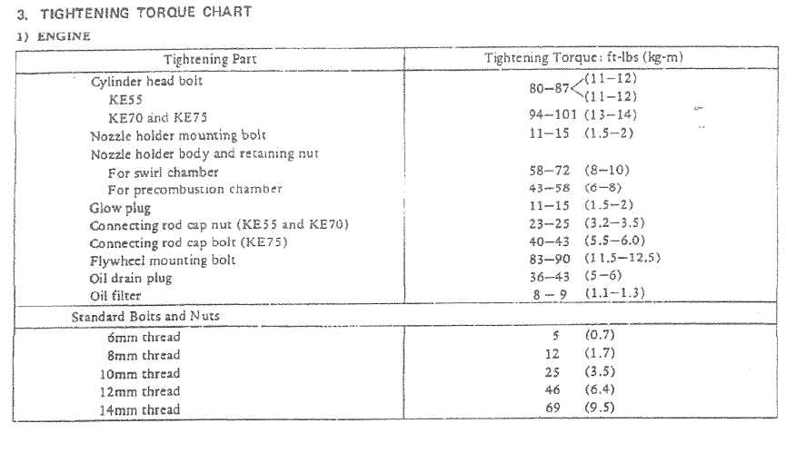

Hi All Iam new to this I Have a Iseki TX1500F 4x4 . I have been looking for the head bolt settings and the rocker settings I have the Exhaust valve clearance: of 0.014.. but I need the settings for the bolts can anyone help Please......:confused2:

Trevor, the table of contents in my repair manual states the tightening torque chart is on page 22 however it is not there, nor anywhere else in my manual.
It does have the torque sequence for the headbolts .............................................2 - 5 - 3
..................................................................... (to remove head) frt of eng
....................................................................................................................4 - 6 - 1
..............................................................................................................................5 - 2 - 4
.......................................................................(to replace head) frt of eng
..............................................................................................................................3 - 1 - 6
Hope this helps

Thanks Sideways yes I have seen that on some other forums before and that the head bolts are down at 50 pounds. So I was just trying to find out be for I put it back together if this is correct: cheers :drink:

60lbs for the head bolts. .007 for both exhaust and intake
   / TX1500F Head gasket torque settings #5
My manual shows between 94 and 101 ft*lbs. This assumes a KE75 which is the only engine I know of that comes in a TX1500.

Thanks to All that replied that sounds about good to me. Ilikeurtractor yes it is a Iseki TX1500F with the mit KE75
