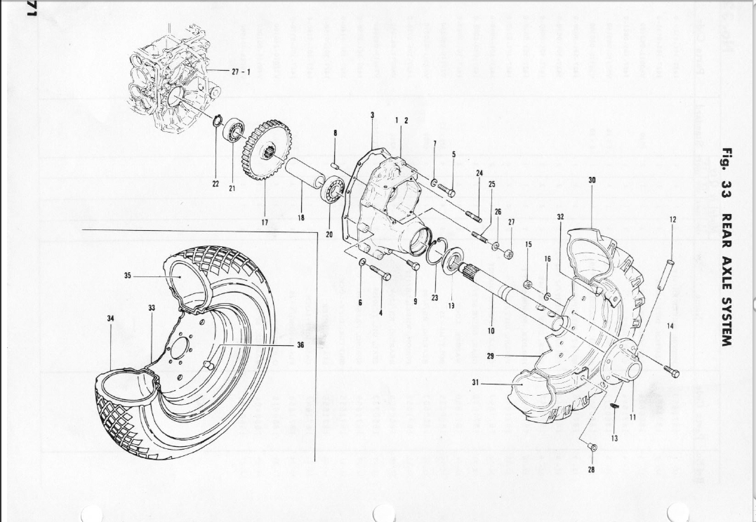

I am a new member here. I recently bought an Iseki/Bolens G174 four wheel drive with a bucket and finish mower. It had flat rear tire when I bought it. I removed the pin and can not get the hub to budge either by pulling (with a GOOD puller) or by twisting it (in case it's threaded on there). It looks like the hubs can be mounted two ways, with the rims inside the flange or outside the flange. Mine are mounted with the flange on the outside, so the hub must be removed to get the rim off.
Can someone tell me 1) how the hub is held on there once the pin is removed? and, 2) where can I find a reputable source for a good service/repair manual?

Hi, congratulations on your new tractor! I have a G154 TX1300F, and I have posted most parts of the service manual in other threads under the Iseki Forum, but the regular operation manual is free at this site: Bolens - Iseki Diesel Tractor Models The hub is not threaded on, it may just be rusted in place. Mine are turned around the opposite way from yours with the flange in, but either way, they are designed to just slide on and of once you take the pin out, in fact they will move a bit on the axel. I would try a good Penetrating Catalyst like PB blast and let it soak overnight. I have found that PB works better than WD-40. They do just slide on and off, so you may have to hit the tire with a rubber mallet to help. I bought my repair manual on eBay for around $5 on disk. I also have a source for the decals, and the paint, if you decide to re-paint yours, but I am not sure what condition it is in. I would check the oil, the air filter, the hydraulic dipstick, located next to the gear shift boot, and the coolant right off the bat. I actually have quite a bit of information about your tractor if you need it. Do you have any photos of your tractor? Also is it a two cylinder, or a three? You can usually tell because the two cylinder has the exhaust stack horizontal to the ground. I found this diagram for you in one of my manuals. I see what else I can finds for you, welcome to TBN, and again, you bought a great little machine that should work like a tank for you.

Wow. Excellent information! Thank you! At least I know it's SUPPOSED to come off. It's rusted and painted on there, I guess. Looks like I may need to borrow my brother-in-law and his oxy-acetylene torch to get some real heat on there. I bought an OTC 7394 puller (an awesome tool) and it's not budging it.

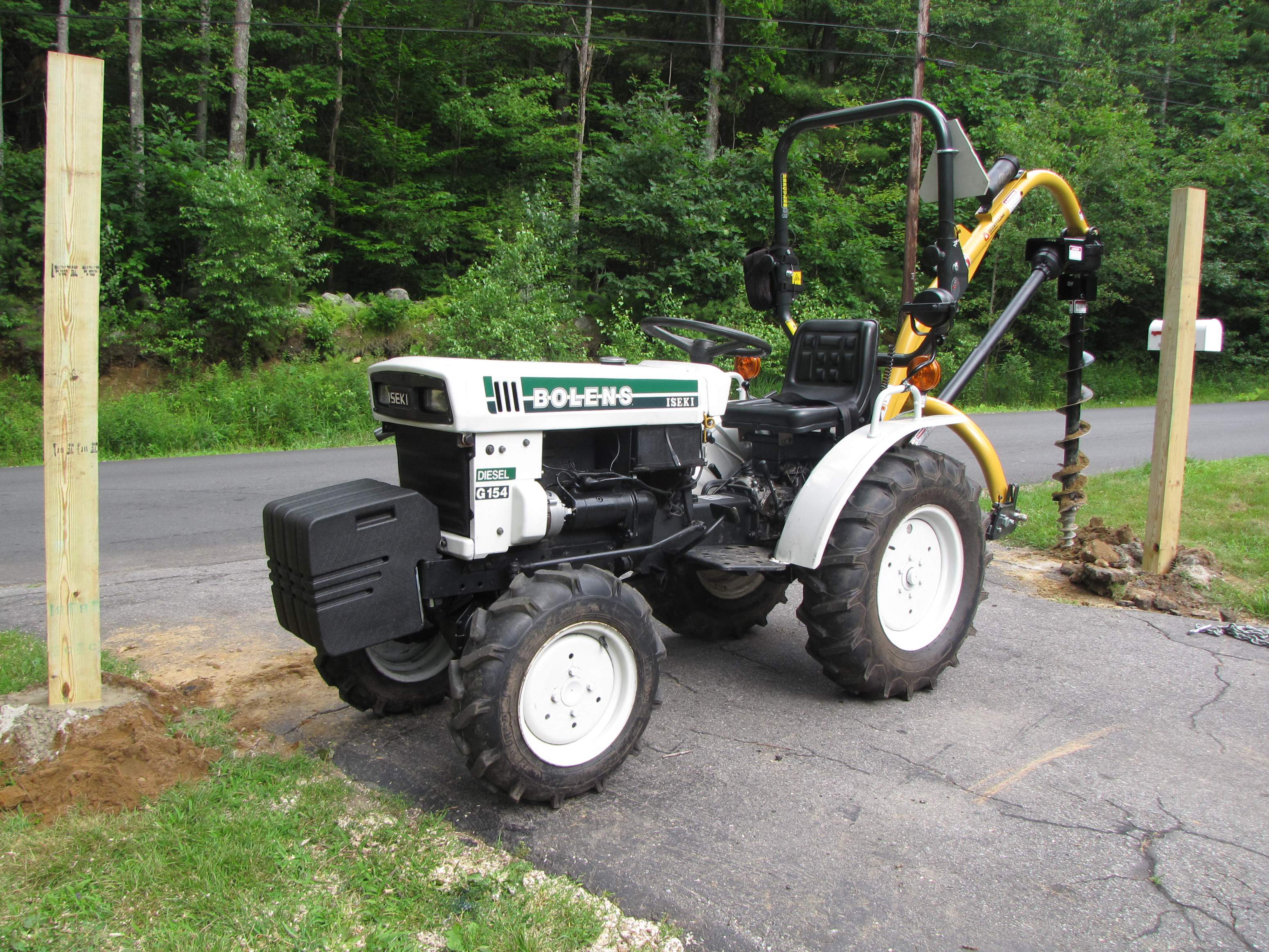

Thats a really nice puller, I could have used that on several jobs at home! The ROPS that they have you get are SAE certified, and fit great. This is a photo of my G154 with the ROPS attached, and my new post hole digger attached.

Thats a great looking tractor! I like the FEL, and the finish mower! Were you able to get the rear wheels off yet? Your rear tire look like the original turf tires that came with it. Mine had the same ones when I bought it, but I added the R1 ag tires, because I needed the traction when I use the tractor in my woods, and when I plow with it. Yours looks like it is in good shape, and I think that who ever had it added an after market exhaust, but it looks good. Thanks for the photos. My photo didn't show up when I looked at the thread on my ipad, but I saw it on my Mac. Thanks for the photos! See if this works: IMG_4098.jpg
