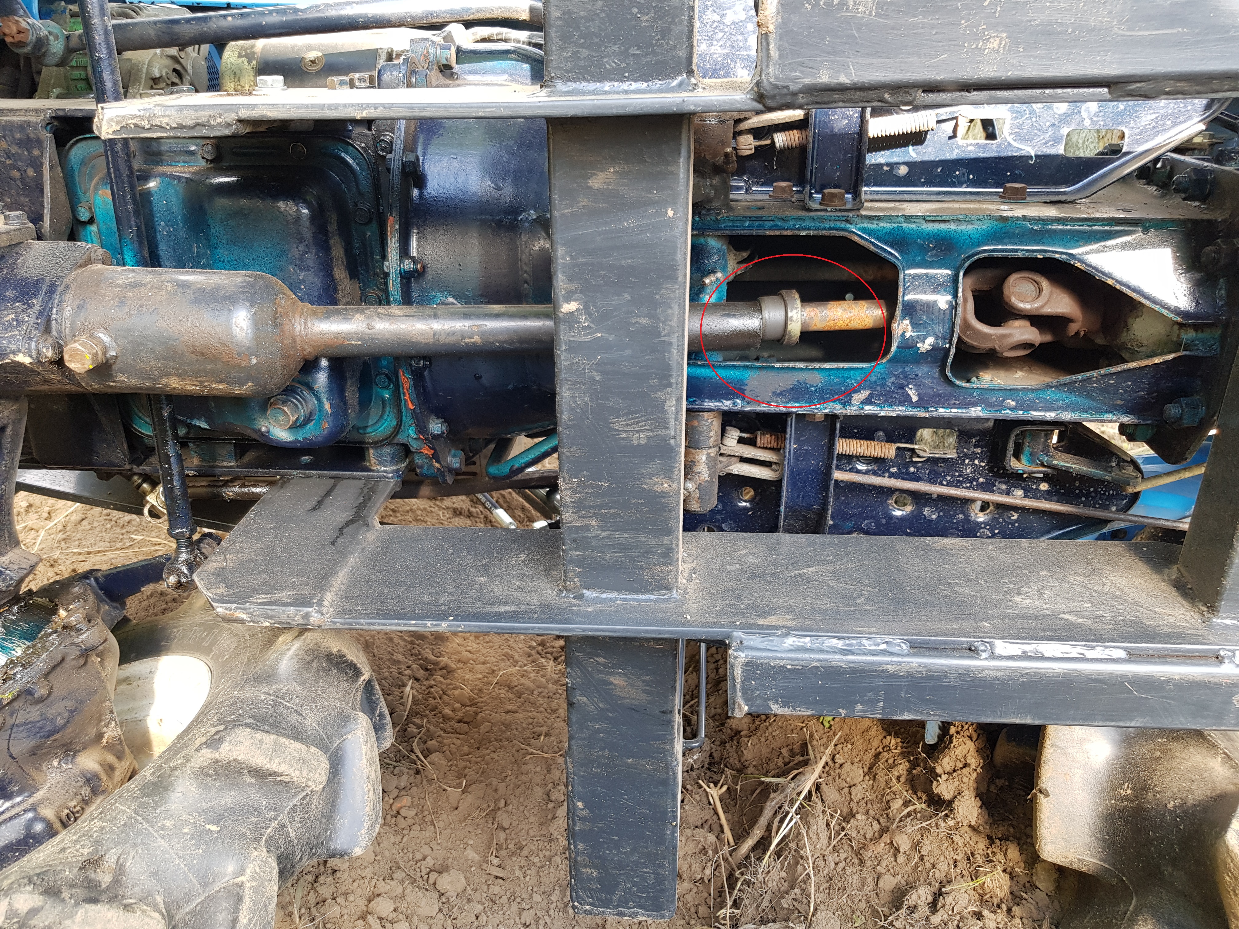

Because i tilted my tractor i had opportunity to make photo's from the bottom view.
Now looking at the photo's i see something strange. Well, i think it looks strange.
This is the axis/shaft (no clue what it is called) for the front wheel drive. It seems not ok. Can anybody confirm? Any photo on what it should look like?

It looks like the front axel has moved forward and caused a disconnect in the drive line. I wonder - did it go back together when the tractor was righted? I'd sure want to crawl under and check before using the tractor. Particularly in 4WD.

It would appear that's a bearing that keeps the shield centered with the shaft spinning inside it? If so, it has slipped on the shaft and separated from the shield?
Can you confirm this assumption by spinning the bearing by hand? Or look at a parts diagram to confirm this?
The bearing may have failed causing it to break loose from the shield?

It's just a plastic bushing that popped of the tube. Nothing serious or critical. It just supports the tube that covers the shaft for the front diff.

It might have been like this for a long time. Just put it back in, and put a hose-clamp on the shaft, so the bushing stays in place. I may need a little play though as the front axle moves back or forth.

Ok everybody thanks for the info. I will check under the tractor later this afternoon, and if possible put this hose-clamp.

It is a bushing that you need to press back in the metal sleeve. I recently had mine apart as the driveshaft was bent and needed to be straightened. It is real easy to press the bushing in by hand.
