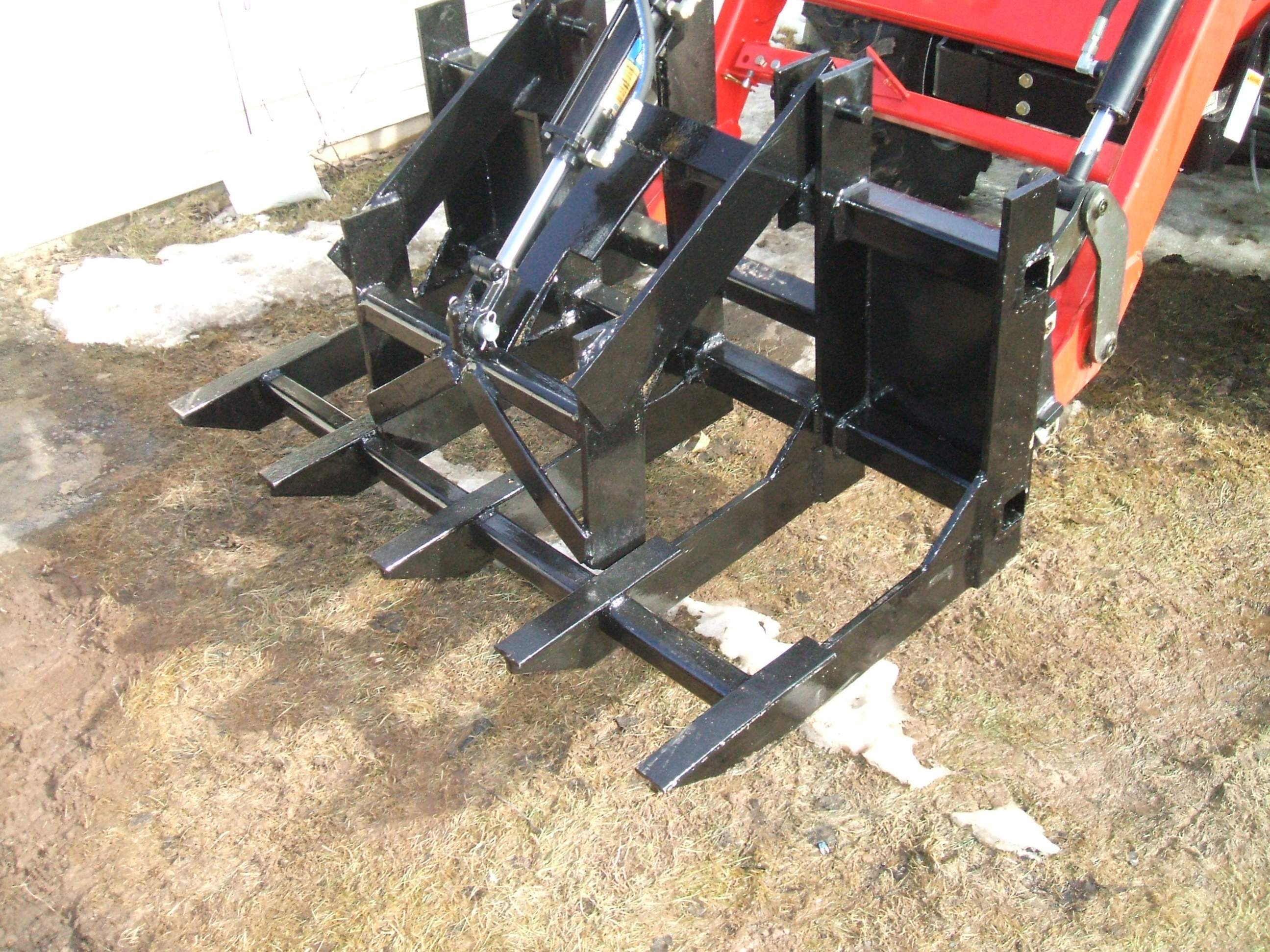

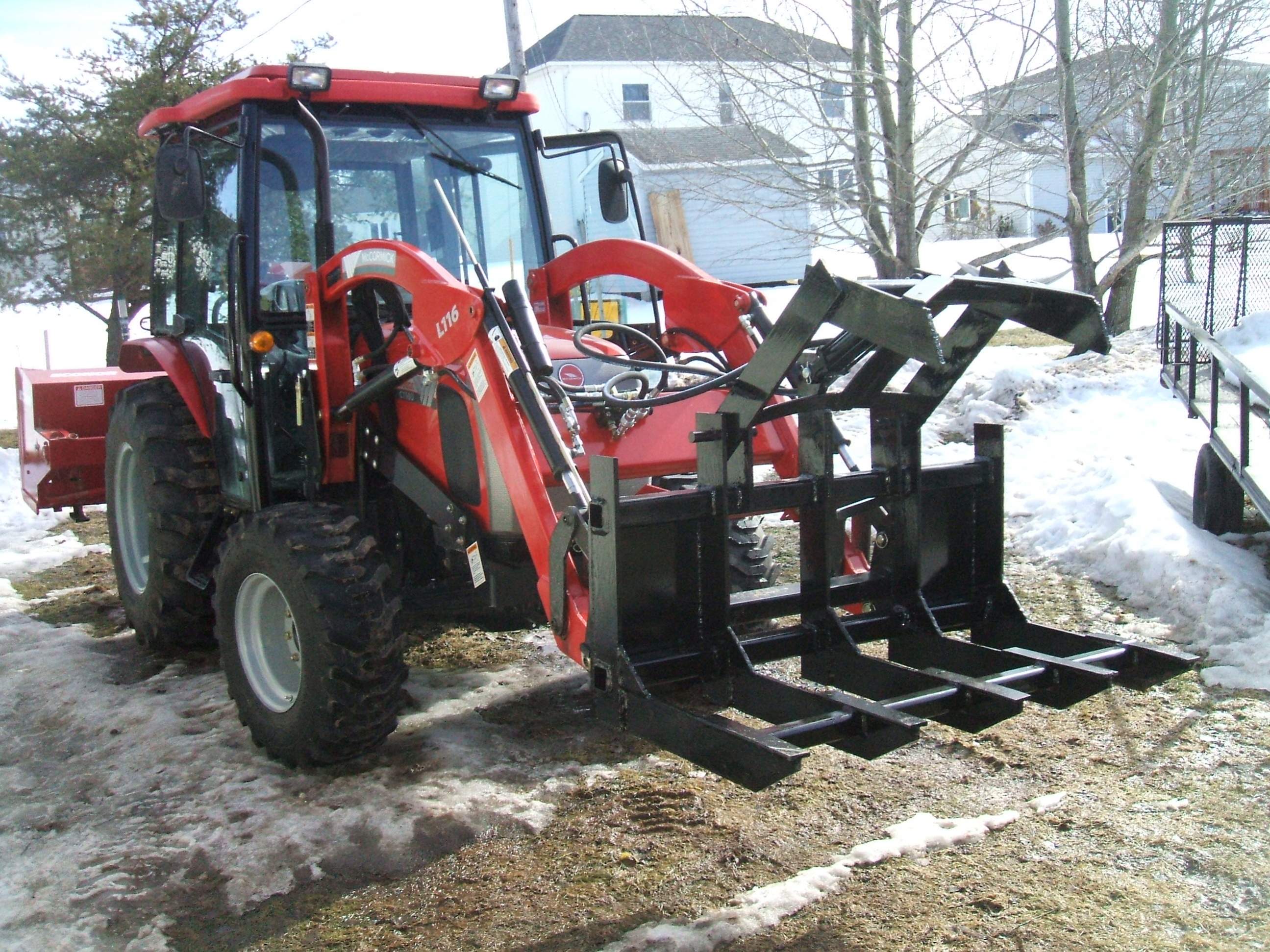

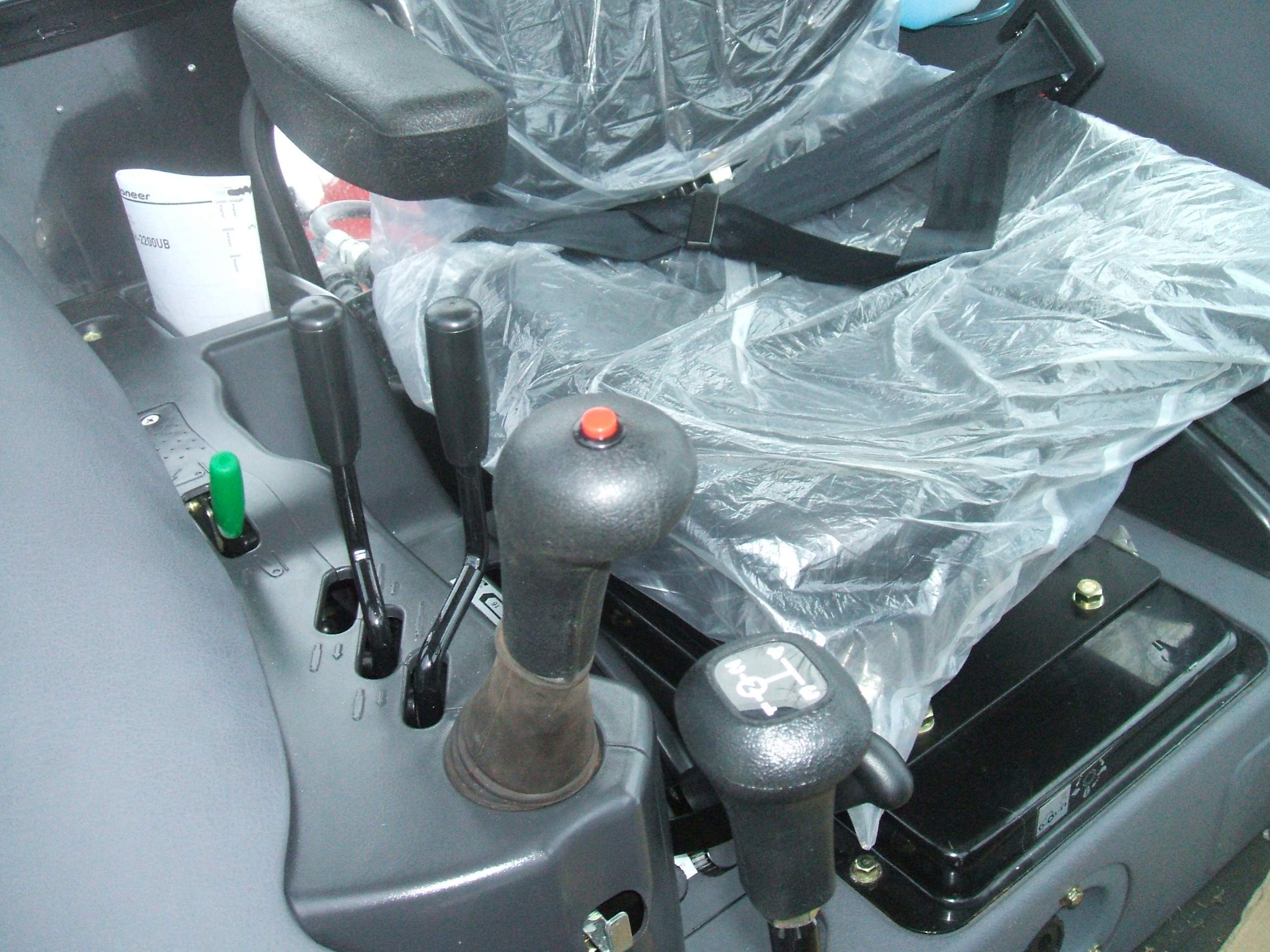

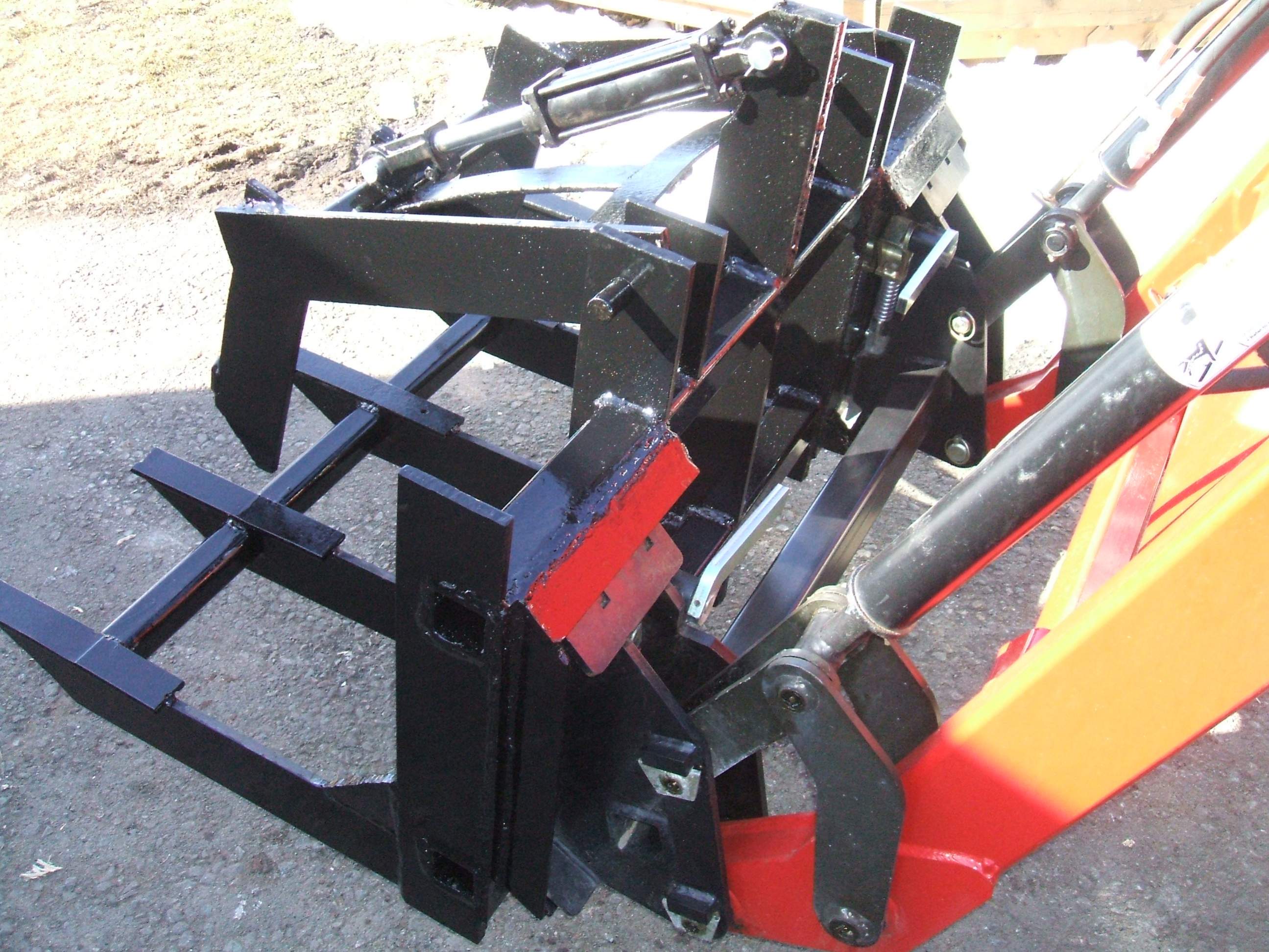

I made one last month which cost me less then 700.00.Its 48 inches wide and the grapple is 24 inches.as far as steel verses rubber lines doesn't matter same strength,steel looks neater if you have a bender
