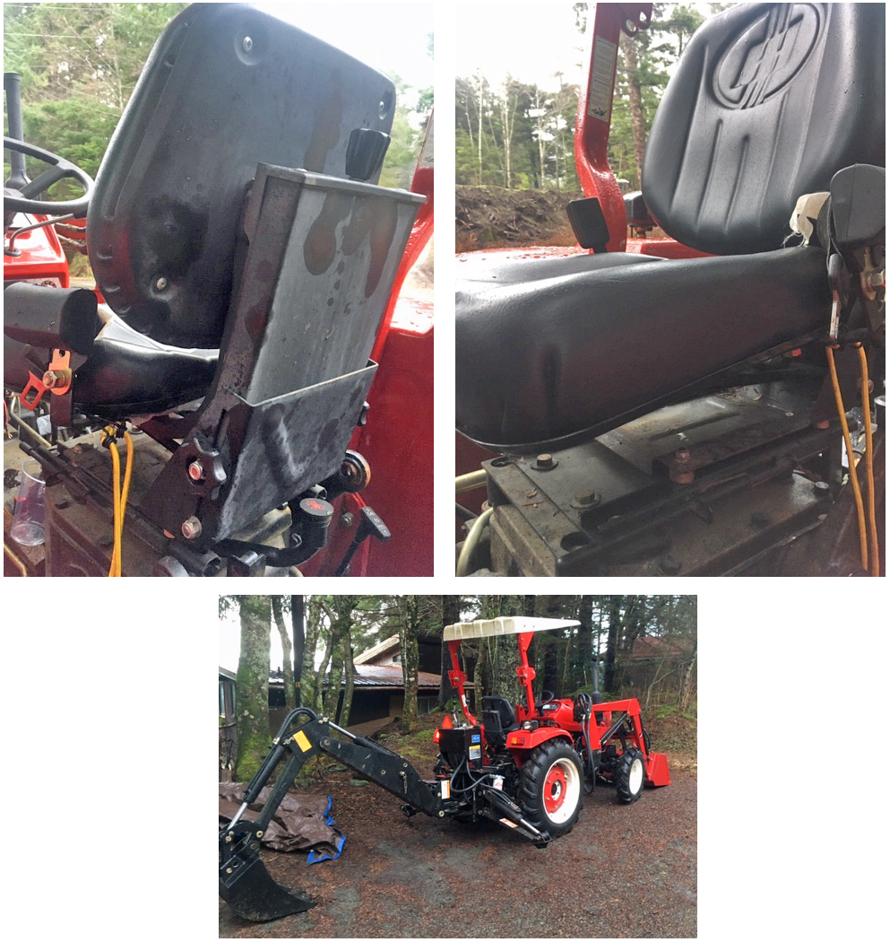

JinmaSeat.jpgI bought my Jinma 284 in 2006 with the JW03 backhoe. I assumed it came with a swivel chair. But looking at it I can't see how it would swivel or flip over for using the backhoe. But maybe it does. Does anyone have this chair? I thought it might flip over where the back rest becomes the seat, and vice versa. See my photos. The other problem is the dreaded foaming gear oil (80W-90) gushing out of the breather. I ran the tractor and backhoe (lightly) for a week or two before this foaming started. I've read a lot of the posts about the problem. For those with a Jinma 200 series that got this problem, what did you discover was the cause? I hate to have to take off the backhoe pump. It's bad enough to have the gear oil pour out while replacing the gasket, but pouring it back in with a funnel takes forever! I guess I could back the the tractor up a hill before taking the pump off. How should I troubleshoot this air leak/foaming gear oil? I still hope to get a trench dug before the ground freezes here. It's 42 degrees here at 11pm but colder weather is on the way. A few days ago, farther north in Alaska, it was -65 degrees in Manley Hot Springs, Alaska, while it was 40 degrees here in Juneau, a 105 degree difference!

I assumed all 3pt backhoes came with their own seat (so you壇 have two seats). Yours doesn稚, obviously.
I googled your tractor out of curiosity and this link came up. Shows a backhoe on it with a seat (didn稚 look to see if it痴 the same as your backhoe)

The JW-03 and LW-6 three-point mounted hoes have their own seat. Is your hoe hitch or frame mounted? Can't tell from your pics.

It's frame mounted.
