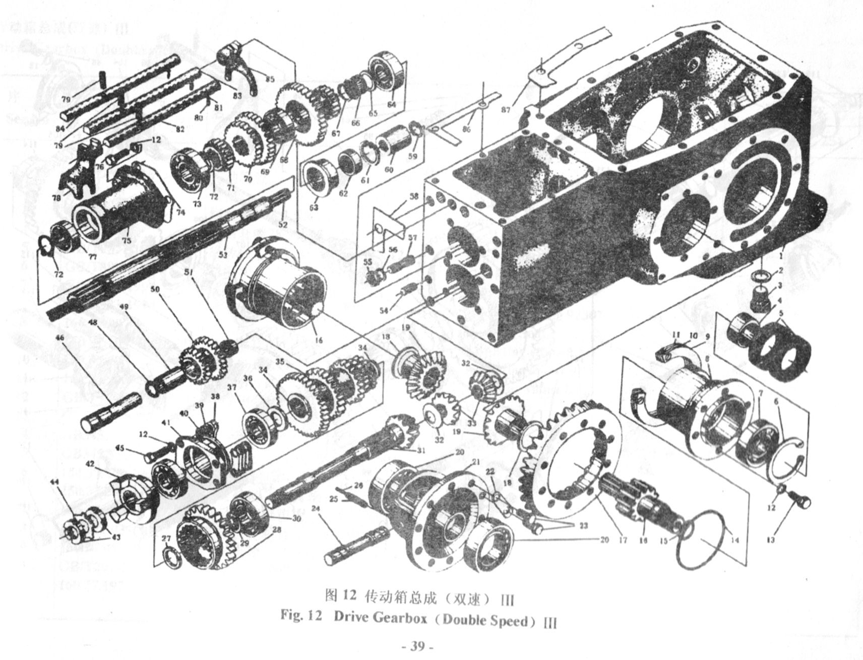

It's hard to do anything with these Chinese tractors without the set of 4 manuals. Until you remedy that situation, perhaps this diagram will help. I've got more if you need them.
//greg//

Anyway, back to the situation at hand... The picture is great -- that will be very helpful. Looking at that pic does confuse me slightly though... I don't see anything that prevents the 2/3 rod and fork from being actuated while the 1/R rod and fork are already engaged... What in the transmission makes sure that one rod/fork has been completely slid into neutral before the other is engaged? Is it only the shift plate pattern in the transmission lid? FWIW, the terrain was pretty steep where the issue occurred and I was shifting from 3rd to R, (In low range of course).
Well yes and no. The shift plate works in conjunction with the detentes on the shift rods. Wear (slack) at either end of the shift rods, and/or wear on either end of the shift fork can lead to less than positive gear changes as well.
//greg//
