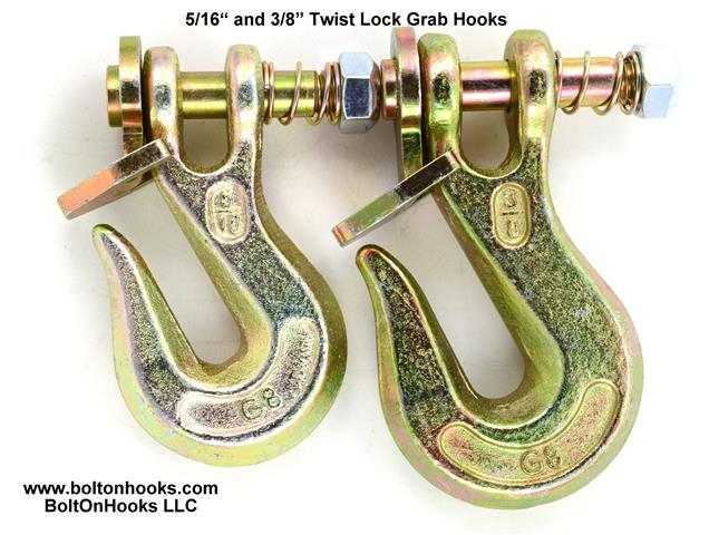

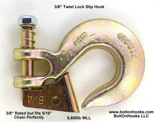

I use locking hooks on almost everything now, I got tired of the sheet metal type safety latches on hooks and bought these. I like to use the slip hooks to make the end connection to d-rings and shackles less bulky .
