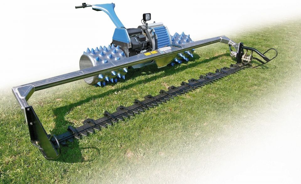

Except for exotic one-offs, twin-engined commercially produced 4-wheel tractors are rare. As high-power tractors are available from most of the well-known manufacturers today, there is probably no need for them now. In the 1950s and 1960s, things were different, and this led companies like Ernest Doe & Sons in the United Kingdom to link two tractors together, and thereby create a twin-engined, articulated and 4-wheel-driven tractor with twice the power of the traditional tractors on the market at that time.
I have never seen a commercially produced twin-engined 2-wheel tractor, but one is coming close:
In the alpine regions of central Europe, a handful of companies are producing 2-wheel tractors for professional users like farmers and public authorities. One of these - Brielmaier - offers the possibility to attach two 2-wheel tractors to the same implement! A number of videos on YouTube shows this impressive setup:
https://www.youtube.com/watch?v=A5WBVOzKoIw
The video above shows the tractor(s) mowing on a slope with a gradient up to 112% (48 degrees) with a 6 m (20 feet) wide sickle mower. One of the tractors are the "master" and the other one follows commands through a simple electrically connection. The tractors can be operated normally via the controls of the master, or remotely via a small remote control. Depending on the nature and size of the field, using the remote control can reduce the walking distance to less than half of normal.
Another video - made by an independent agricultural magazine - shows a comparison with the 100 hp conventional tractor that the farmer normally uses on his field:
https://www.youtube.com/watch?v=LzJsOKQAWdA
The farmer in this case, uses a 3 m (10 feet) mower, as experience has shown him that a heavier one cannot cope with the slope. The speaker tells that the 2-wheel tractor can mow almost twice as fast as the normal tractor, for less than half the fuel.
Another test shows, that it is possible to mow up to 3-4 ha/hour (7.5-10 acre/hour) with a gasoline/petrol consumption of 1.6 l/ha (0.17 US gallon/acre).
An interesting use of 2-wheel tractors, that as an extra bonus, keeps the operator fit ;)

Farming on the Alps mountain sides intrigues me.
I find it hard to get to the sites using English when out searching.
   / Twin-engined 2-wheel tractor #3
What do they do with the grass once it is mowed?
they surely can't get a baler on that slope.
Do they gather it up by hand?
   / Twin-engined 2-wheel tractor #4
Those are some really steep slopes. Not even the tilt-body Steiger's could handle those slopes. There must be form of implement to drag behind those units to gather up the cut grass. Did you notice the photographer having a tough time navigating the slope.

Twice as many components subject to failure, relative to a larger, single-engine tractor. Who needs this? And what about safety?
Some land should be left to pasture.
   / Twin-engined 2-wheel tractor #8
I would argue that the larger tractor and mower shown has many more moving parts than the dual walking tractor setup and of course half of the walking tractor parts are repeated in the second unit so many fewer unique parts.
You farm the land you have.
   / Twin-engined 2-wheel tractor #9
But this is very expensive equipment....
This cost around 32500$
