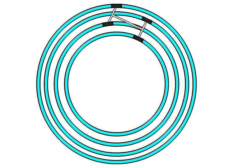

Are there limitations turning when FWD is engaged? Can I turn the front wheels all the way without concern?

Turning in FWD should not be a problem at all.
   / Turning in FWD #3
On many of our tractors, the front wheels "land speed" is slightly faster than the rear just to address turning.
:D
I would add this to that reply:
if the tractor is on gravel or dirt.
The front wheels do turn slightly faster, and need to be able to "slip" a little, you can also feel a binding when turning hard because the inside a outside wheel are rotating at different speeds.
If you are on hard pavement where the tires can't slip a little then you can damage your tractor!

Thanks guys. I had never give it any thought until the other day when I was doing some disc-ing and noticed how sharp the front wheels turned at full left/right turn. I blew a drive shaft seal on a Kubota I used to have by leaving it in FWD and running down the road in 4/High, so I am always looking out for the FWD.
   / Turning in FWD #7
FWD just really isn't meant for fast road driving.;) I looked at a used MF 481 last year that I don't think had ever been out of FWD. The axle seals where leaking and the front tires where worn out in under 500 hrs.:( The owner had property on a paved county road and ran field to field on pavement.
A picture is always worth a thousand words to me. DEWFPO
   / Turning in FWD #9
That is very cool! Thanks for posting:D
Mind if I save that to use in the future?
   / Turning in FWD
DEWFPO, great picture! I like pictures, easier than reading!
