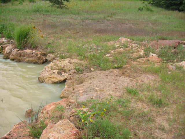

Hi all, we are in drought mode again this year, which might be turned to my advantage...
My dam was reconstructed several years ago by someone else and only has a spillway for drainage. Problem is, the spillway has eroded and is unsightly. With the water being so low, I have been tempted to install a pipe for overflow (if we ever overflow again!!), but, I would sure hate to screw it up worse. Please look at the photos at: <A target="_blank" HREF=http://kevinkaley.home.mindspring.com/Temp1.htm>Dam/Spillway pics</A> and advise.
The standpipe is useless as far as I can tell, other than it still closely represents spill level. I have some 12" pvc that I can use. In a nutshell, the "plan" right now would be to bust out the existing concrete, trench for new pipe, install a tee with extension below (drive the lower part into the pond bottom, maybe a foot or two), adjust the height to spill level, connect the horizontal drain part on a slight tilt, then bury the pipe to match the rest of the dam.
That would be the first and main part, after that I can consider piping and burying the rest of the drain down to the lower pond!
Any ideas, tips, etc are appreciated!

Hi Dob,
A couple of thoughts about using the plastic pipe. You will need to construct some type of barrier to keep water from seeping along the sides of the pipe. With metal pipes the normal practice is to weld a square plate around the pipe, perpendicular to it's axis, located 3 or 4 feet into the dam bank on the water's side.
I would also be concerned about erosion of the plastic over time from the dirty water that's going to be flowing thru it. Also keep in mind, plastic does not like the sun, will the top of the pipe be able to withstand UV rays?
You don't want to have to redo this job anytime in the future. I think I'd be more comfortable with a steel pipe, if I was gonna use an overflow pipe.
Personally, I don't like the looks of an overflow pipe. They look more out of place then a beached whale when the water's below full. And here in Texas, the water's below full more often then not.
I attached a pic of how I made the spillways for the ponds I've constructed. However I'm lucky, or cursed perhaps, to have heavy clay soils. This method won't work if you've got porous soil in your dam. Basically my spillways are constructed of large boulders laid like flagstone with a clay base and clay used as grout. The boulders I used average 2 ft thick, but you don't have to use ones that thick. I did it this way cause I had the rock available, I needed to be able to drive the tractor and dozer over these spillways, and I hate concrete spillways even more then overflow pipes.
Good luck whichever way you go.
Dave Perry

Dave, thanks for the insight. I have the pipe, and maybe it's me being a cheap SOb (see above) that prompted my potential use of it! We're not talking much here, if I move ahead, I think I'll get steel.
I too would prefer a spillway, maybe I should consider just replacing it, but the soil in the dam is more porous than not having been farmland many years ago and I'm afraid it would revert to the ugly mess I have right now in short order. The catch here is that I need something "solid" to prevent erosion, but when something "solid" (like concrete) goes in, the erosion move under and around the concrete, which to me makes for harder repair. The other issue is that the drop on the back side is 6-8' from full pool, rgth now there is ugly concrete leading most of the way, but again, it has eroded around the edges and who knows how much underneath. I think to have a "proper" spill, I'd need to backfill A LOT, perhaps invading the fenceline nearby.
I'll keep studying...
